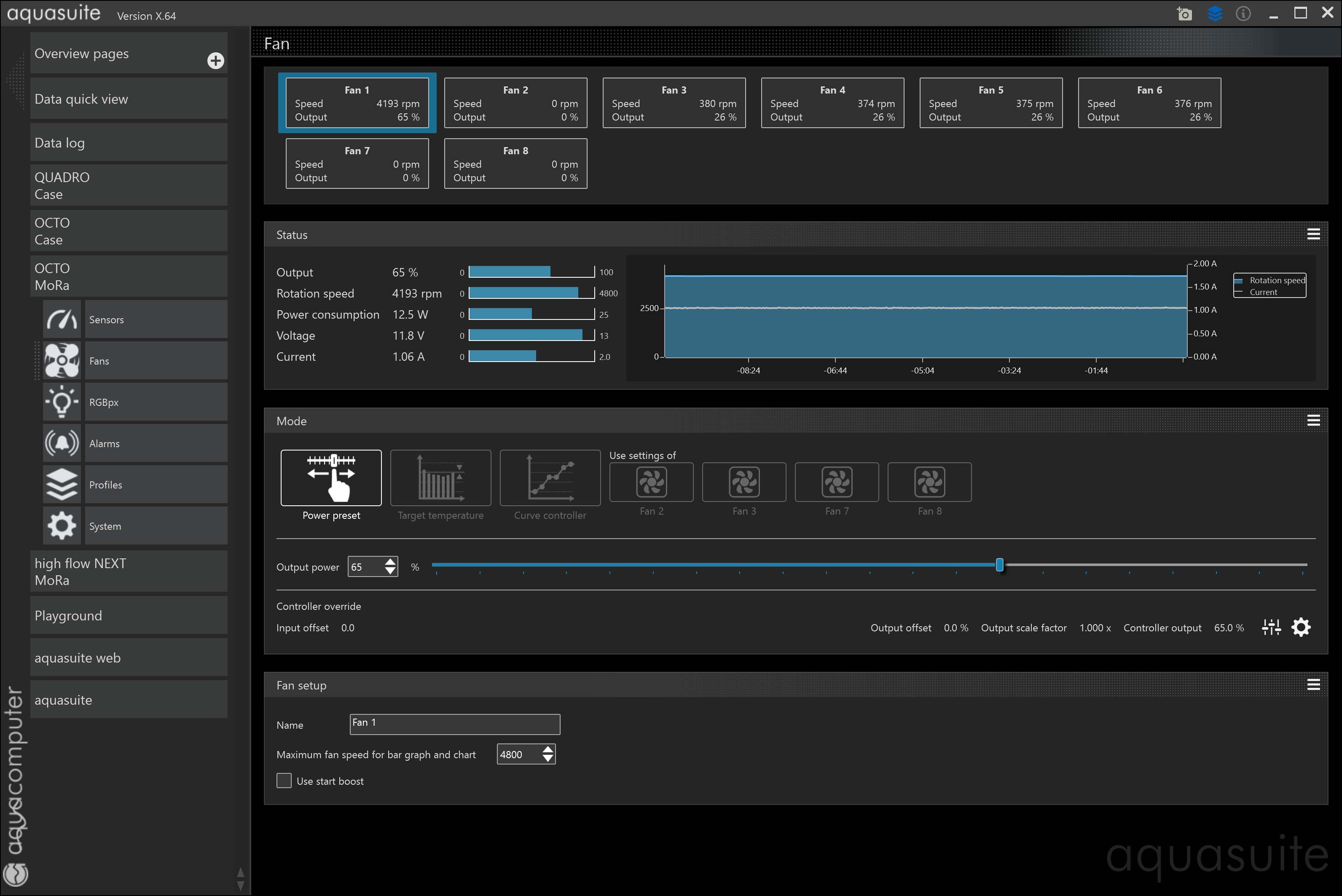

My Pump-2 is acting up, anyone else SEEN something similar?
Dienstag, 13. Dezember 2022, 01:16
Very strange, especially the current draw wiggling around like that. What is a Crystal Motor?

Pump 2 stopped again last night. I will try to swap it back to port 2 to see if it resets.

The pumps are both aquacomputer pwm D5s
Even with a 2A rush at start-up, that is still below the OCTO's rating, which probably has a start rush allowance also.
I swapped the failed D5 from port 8 back to the original port 2, and it still doesn't work.
Pump 1 now shows 11.8V and all fans show 11.9V
I guess it is tear-down/rebuild time :(

Finally you get to my point, lack of documentation. I felt comfortable running at 50% of rated capacity (pump_stats.jpg)
