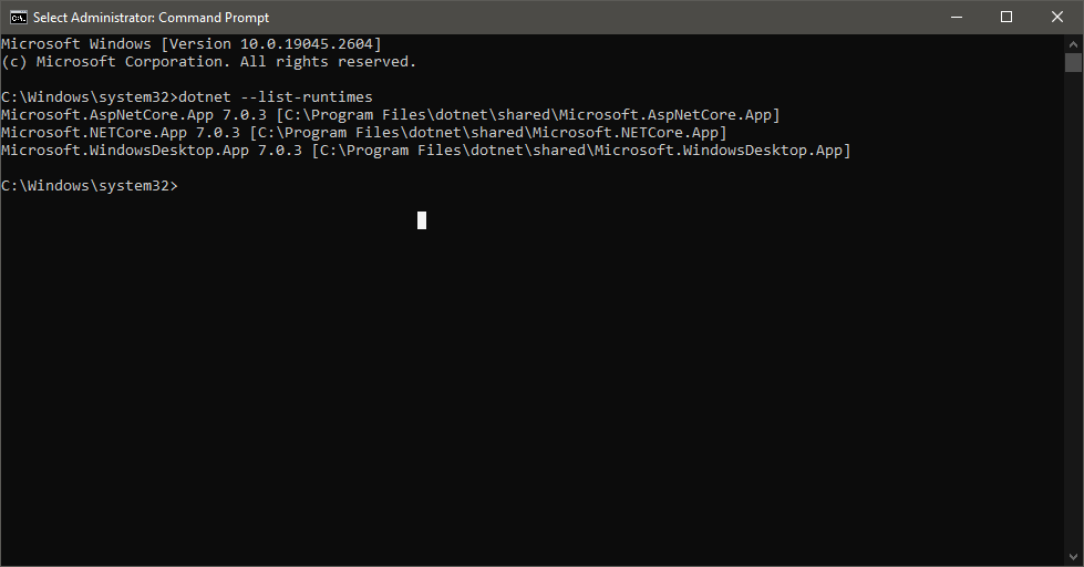

LiquidMX
Dienstag, 14. März 2023, 21:34
CMD results below
»LiquidMX« hat folgendes Bild angehängt:

LiquidMX
Dienstag, 14. März 2023, 22:38
We have updated the installer today.
There is now an option to ignore the Net Runtime check and install anyway.
But the Net 7 Runtime is needed, without it the software will not run.
Thanks for that, installation wen't without problems and whole aquasuite running smoothly.

LiquidMX
Sonntag, 19. März 2023, 16:42
look above (i included image stating that .NET 7 is installed), aquasuite have trouble detecting installaion of .NET7
