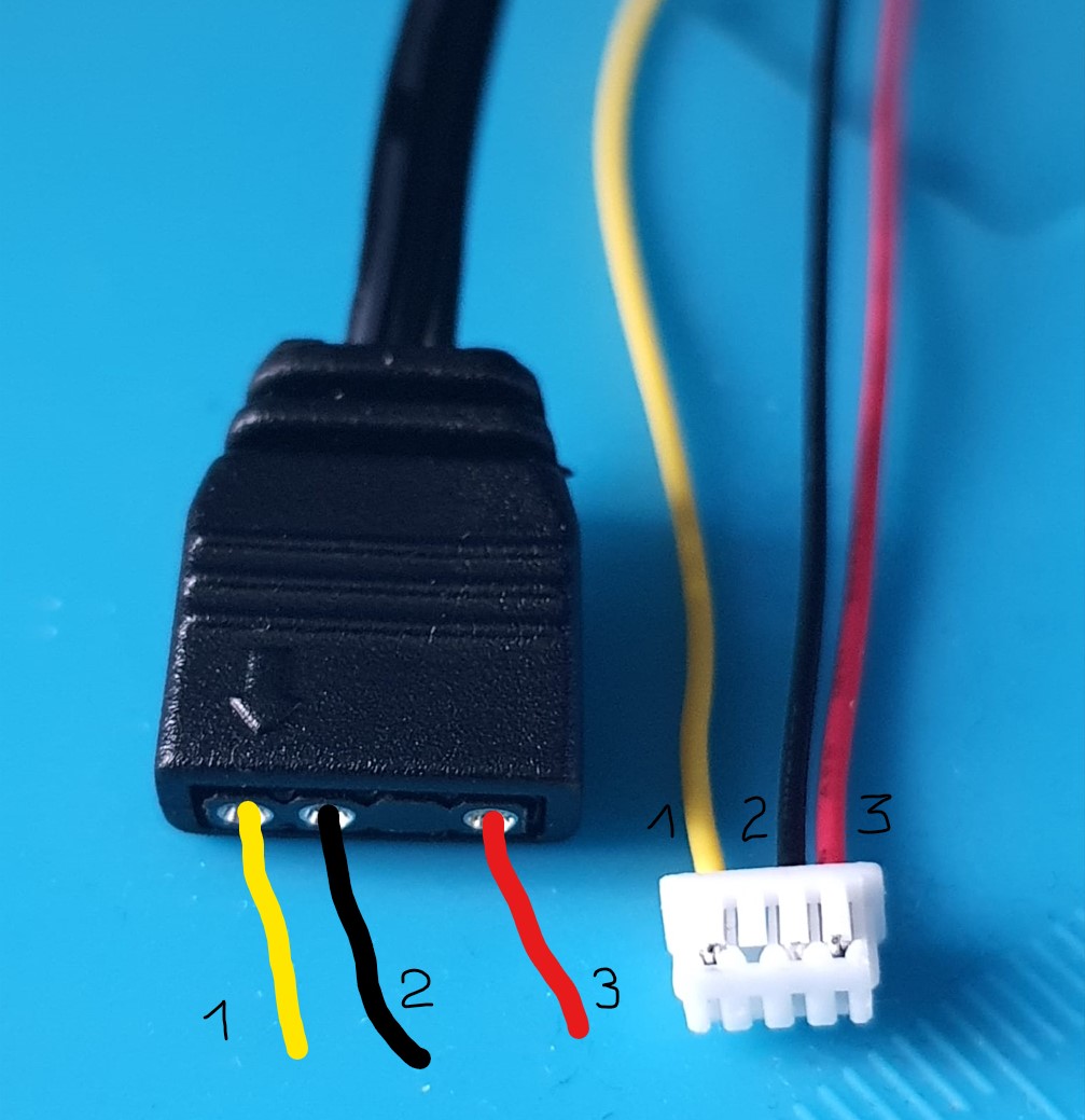

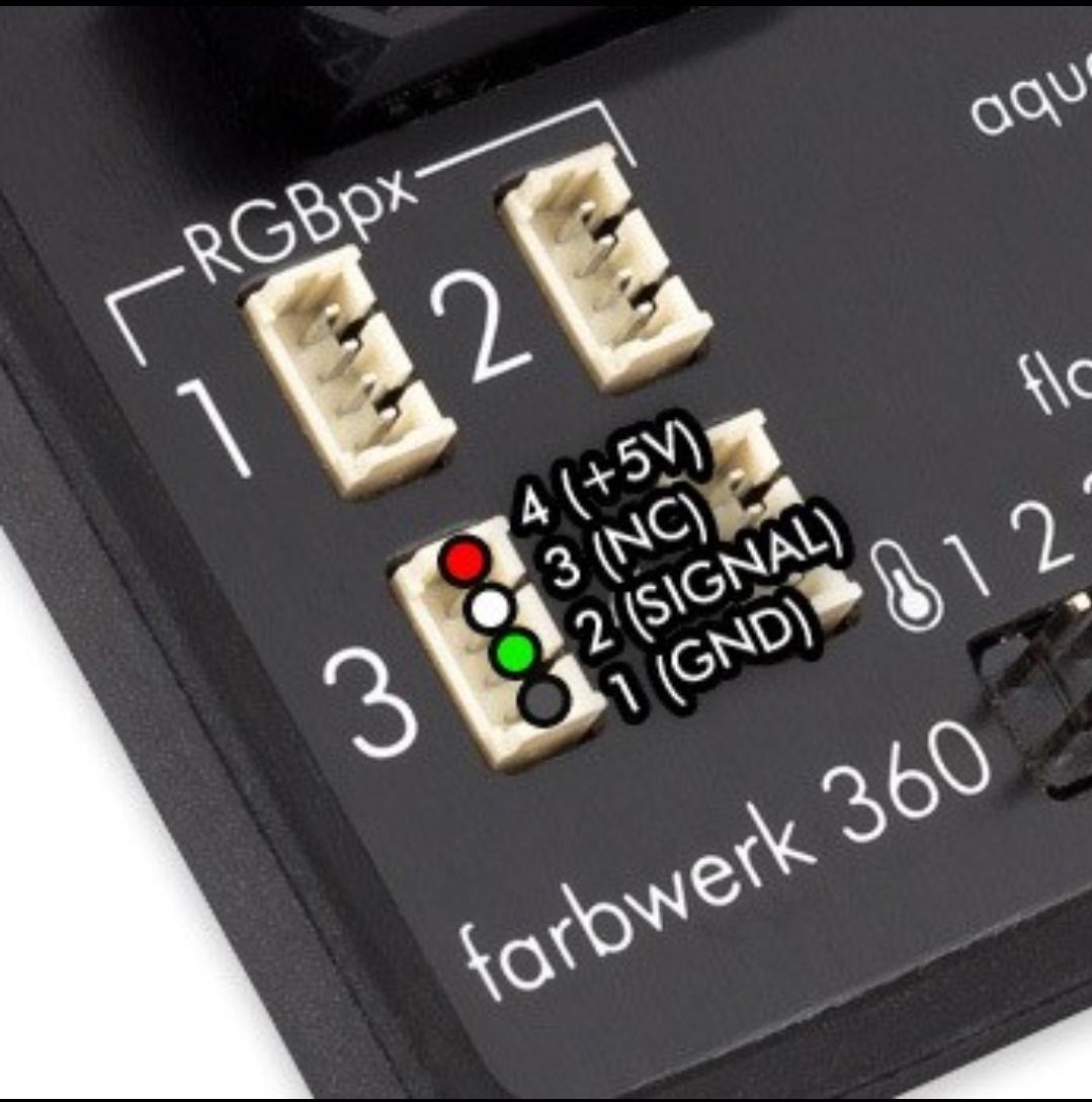

As it looks like its going to take a while for my RGBpx adapter to arrive, I figured I could experiment with my RGBpx extension cable, cut off the end, and splice it into a aRGB cable. Unfortunately I can not find any information showing what wire is ground/power/data. Does anyone have any information on this?
Sonntag, 10. Juli 2022, 02:16
I always seem to have trouble getting an image into a post on this forum. I attached pictures of an RGBpx cable and port pinouts.
pagusas
Sonntag, 10. Juli 2022, 03:04
Thank you so much Speed-V! I'm new to this forum, and so glad to already get awesome help :)

Is there a generic name for the connector (ie. not RGBpx) that I can search for from electronics suppliers to build my own connectors with? I've seen some references to "picoblade" in random places, but I'm not sure if that's it.
Per Aquacomputer, RGBpx uses Molex PicoBlade 51021-400 plugs. Note that the Aquacomputer pinout is not the same as the pinout of preassembled Molex cables.
The RGBpx cables are 1:1 cables => pin 1..4 to pin 1..4. PicoBlade pinout is 1 to 4, 2 to 3, 3 to 2, 4 to 1

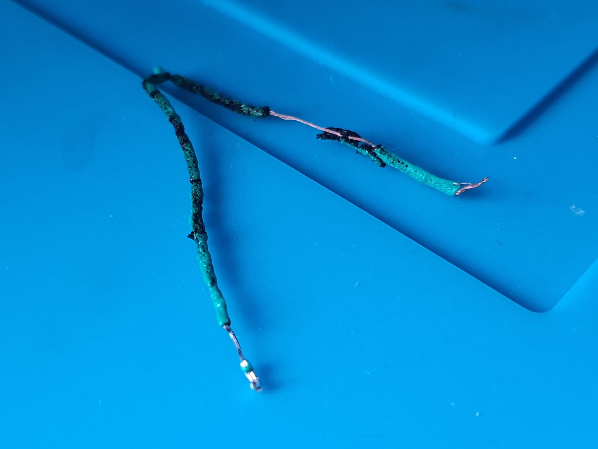

Recently using same method, identical Molex cable (bought 5 at that point) I've failed miserably - +5V cable literally melted. Prior to installation I've checked everything, there were no shorts, +5 and GND where should be, data was in right place as well. I've connected it to LED strip which was a part of AKWB waterblock to the Quadro controller and seen smoke literally straight away. I can only assume that ledstrip was (probably not anymore) fully functional, as I've bought the block 2nd hand.
Any idea what could go wrong there? As mentioned, tried with multimeter and I'm sure everything was connected properly - GND to single pin in argb strip and +5 to the outer one of the other 2 pins. Mid one was a data.
Is it possible, that Quadro header is faulty somehow? I can try to connect fans to it (from d5) but I will be very unhappy if they will die after that test.

Smoke come from the wire, on Pico plug, I guess wire was simply to thin for the current and outer isolation melted.
Header on Quadro is seems to work fine, still +5V as should, no short. No idea how to check Data pin.
As I've wrote before, I'm certain that I done wiring right, no mistakes here. So maybe only problem is that the wire is to thin? But how it could heat up that much to melt outer plastic sleeve?

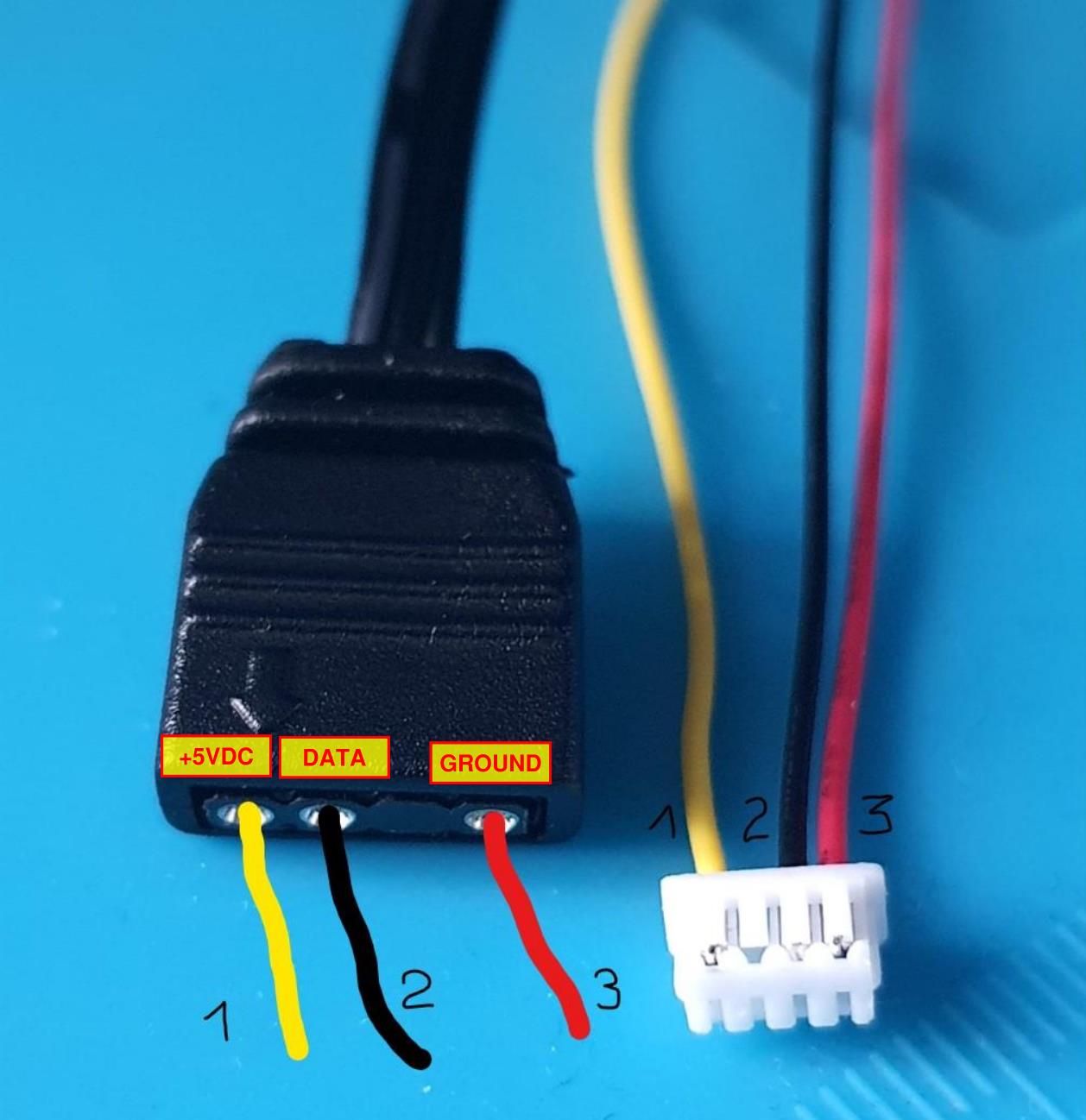

I smoked an RGBpx cable once because I used a premade Molex PicoBlade cable.
The premade PicoBlade cables are pinned out 1-4, 2-3, 3-2, 4-1 (see pin-out in schematic below).
The wire guage are 28 AWG UL 1061, if your wire are smaller than 28 AWG, that may be your problem.
Also, double check your pin-out to ensure it is RGBpx compliant, opposite from schematic below.

Freitag, 24. März 2023, 14:55
I don't see the schematic you referred to.
Freitag, 24. März 2023, 16:36
Link to Molex
Freitag, 24. März 2023, 16:52
According the eBay listing cable is 28awg, but looks very thin.
If you look at picture attached, I've connected +5V to green (that one melted), GND to red and data to black. Yellow was unused. Please let me know if I did it correctly.
Can we see a picture with both connectors, same side up for both?

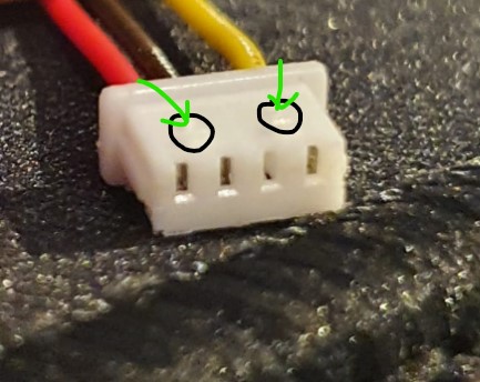

darrecky
Freitag, 24. März 2023, 18:21
Pictures of how I've connected it are attached (melted green cable removed, yellow moved into its place for picture purpose). Also there is a pic of melted one as well. I've just push end of the wires of loose cables into an argb extension and secured it with tape for testing only. And that was it due to unexpected outcome of the test itself.
Also if I remember correctly, the smoke did not appear straight away, I guess only after aquasite loaded (or maybe on log in screen) good couple of seconds after power up.

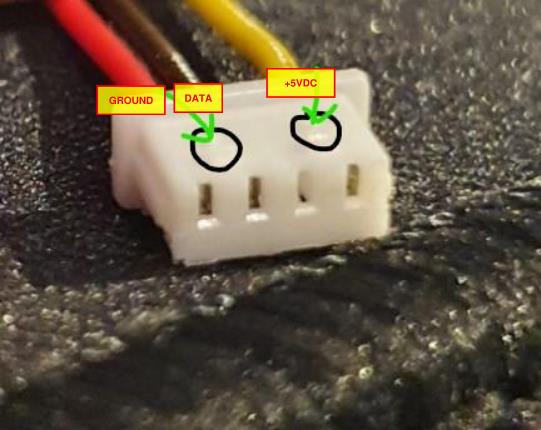

Freitag, 24. März 2023, 19:34
[attach]10178[/attach]
[attach]10179[/attach]
It looks like you have the pin numbering on the picoblade connector reversed.
Looking at the connector on the left side of the PICOBLADE SCHEMATIC, you see the side with the two locking bumps up, and the #1 pin to the top.
Your picture shows the opposite side of the connector with label the #1 (yellow), which I believe is actually pin #4

darrecky
Freitag, 24. März 2023, 20:51
I believe I did it properly. Bumps as per 1st attachment are underneath, not on top. So it is slide to the socket as on 2nd attachment.
I can only see 3 options here:
1. due to poor connection (bare wires slided into argb plug) there was connection issue - as Remayz suggested in earlier post "if your wire has a high enough resistance, it could be "seen" as a load by the quadro, and not create a high enough current to trigger a short circuit protection"
2. led strip was faulty from the beginning
3. RGBpx connector (or logic/controller) in Quadro was faulty - bought it 2nd hand, so maybe someone experimented on it.

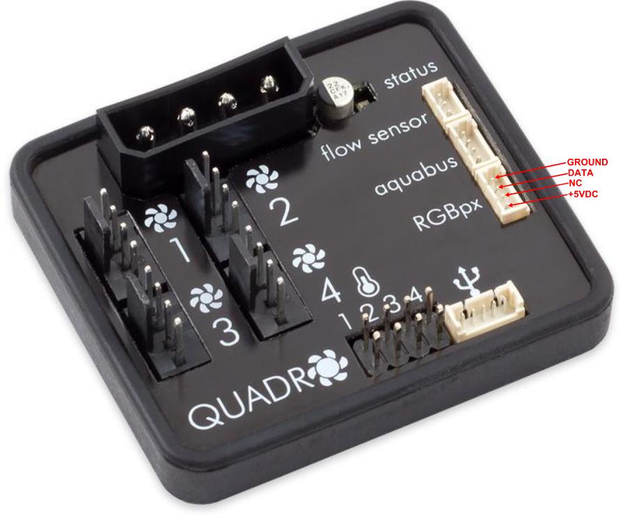

I find myself getting confused trying to figure out if you somehow reversed +5VDC and ground from the various pictures. Also, you are using Red for Ground and Yellow for +5VDC which is kind of confusing. It seems like you know what you are doing, and have successfully done this before, but this is very easy to screw up. Now it is difficult to test because you don't know if the Quadro RGBpx port and/or the LED strip is fried.
If you are positive that there are no shorts, you could (carefully) put a DC volt meter on the +5VDC and Ground pins of the Quadro and see if you get +5VDC on pin 4 relative to pin 1. The RGBpx port on the Quadro is rotated compared to a Farbwerk360. As you look at the Quadro, pin 1 (Ground) is the top pin (the pin closest to the aquabus connector). Pin 4 (+5VDC) is the bottom pin (closest to the bottom of the Quadro). If you get +5VDC on pin 4 relative to pin 1, then remove power, plug in your cable, and (assuming nothing starts to melt). put the meter on the ARGB connector on the other end. On that connector, the +5VDC contact is the one under the arrow. In your ARGB to RGBpx photo, the +5VDC pin has a yellow wire coming out of it. In your Bumps photo, the Red wire would go to ground and the Yellow wire would go to +5VDC. It looks like you wired it correctly to me, which I realize is not very helpful.
To quote a post, click on the Quote button on the right side (next to Report) then select "Quote Post". You can start typing your response right after the /quote in square brackets at the very end of the quoted text. Quoting parts of a post or posts that have quotes in them can get tricky. This forum is kind of old school so you have to be careful if you want to delete parts of the post you are quotting.
