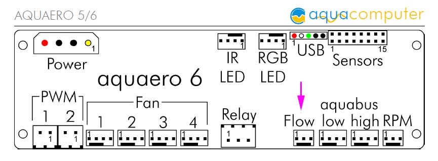

Montag, 26. Oktober 2015, 17:05
I am not too familiar with this flow sensor, but let's first confirm you have the 3-pin cable plugged into the correct port on the aquaero 6.
ZGIERA
Montag, 26. Oktober 2015, 17:12
yes, I have connected this sensor to flow port on aquaero 6xt, still there is no readings.

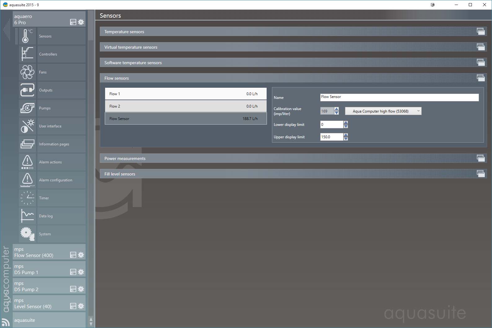

Dienstag, 27. Oktober 2015, 01:15
OK, what does your aquasuite > aquaero > Sensors > Flow sensors' page look like?
ZGIERA
Dienstag, 27. Oktober 2015, 07:21
There is no readings on this page. Every each flow sensor shows me 0.0 L/h
It seems aquaero doesn't see flow sensor
