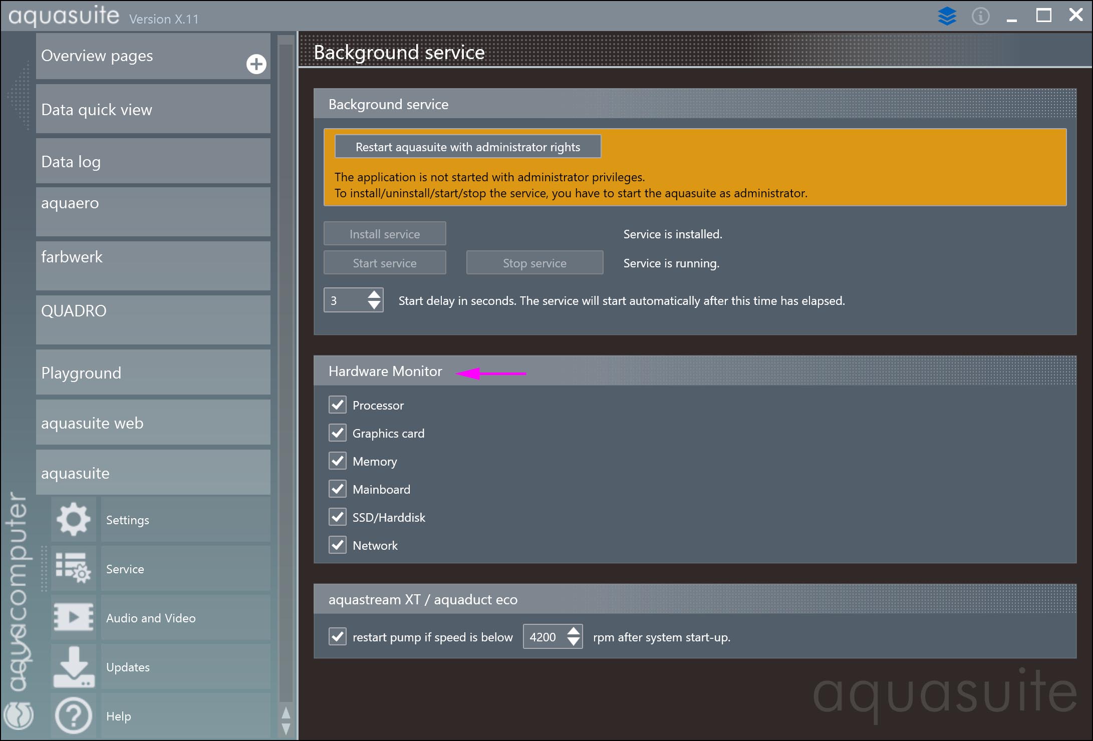

The aquasuite is able to see all sensors HWiNFO picks up.
The aquasuite also has some basic system sensors included,, which it can pickup without 3rd party software.

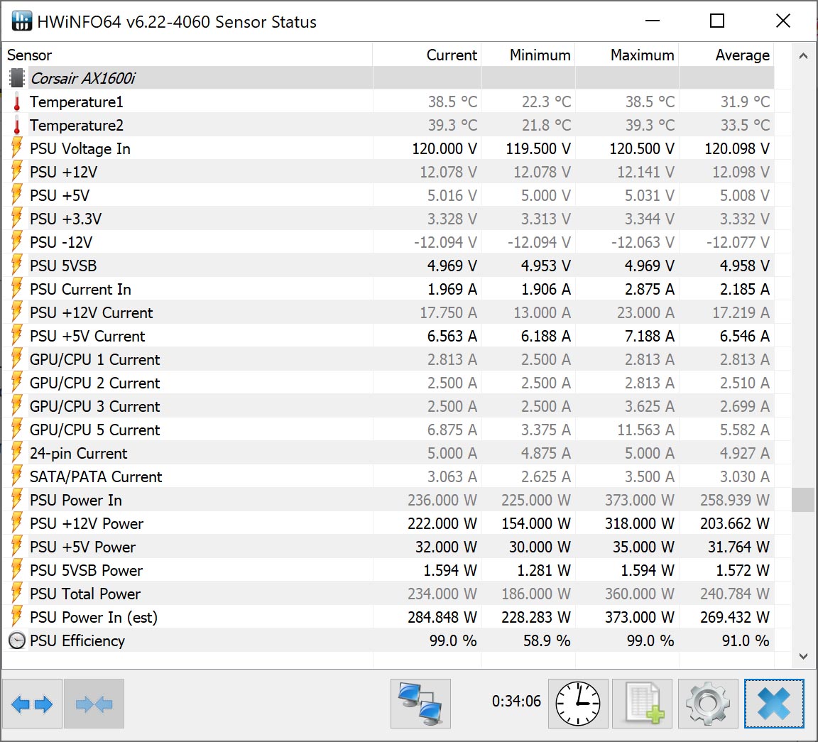

The Corsair HX1000i PSU may be visible in LINK or iQUE, but HWiNFO does not pick it up, so you may not be able to add that to your widgets.
HWiNFO is able to get data for the Corsair AX PSU series.
