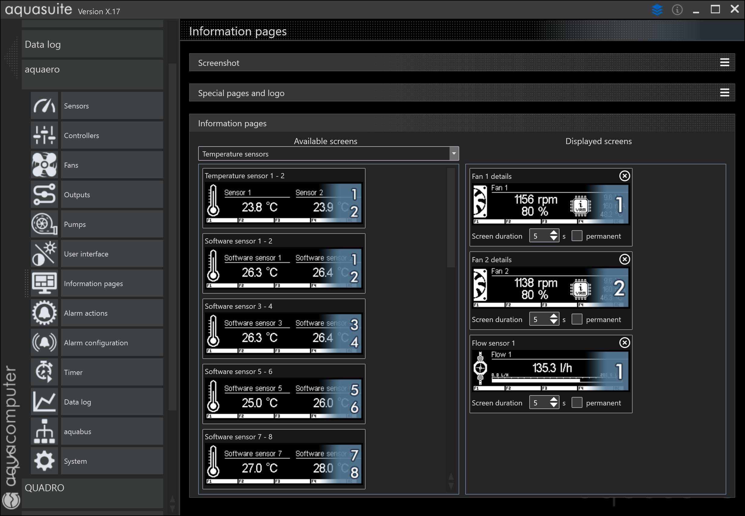

Screenshots are helpful.
Are you speaking of the Information Pages option in the aquasuite for the aquaero display? information_pages.jpg
Warmaniac_209
Donnerstag, 7. Mai 2020, 22:19
what your looking for is the information page, on your aquaero tab, in aquasuite, you need to unchek the little permanent checkbox near the screen duration, inside each little template for the displayed information screen, at the bottom, mine the first is the clock, and set to permanent, so when i cycle the screen with the info, it come back automaticly to the clock page, you, you want to set the sensor page displaying the quadro sensor, i dont own a quadro, so i cannot tell you witch one it is.
