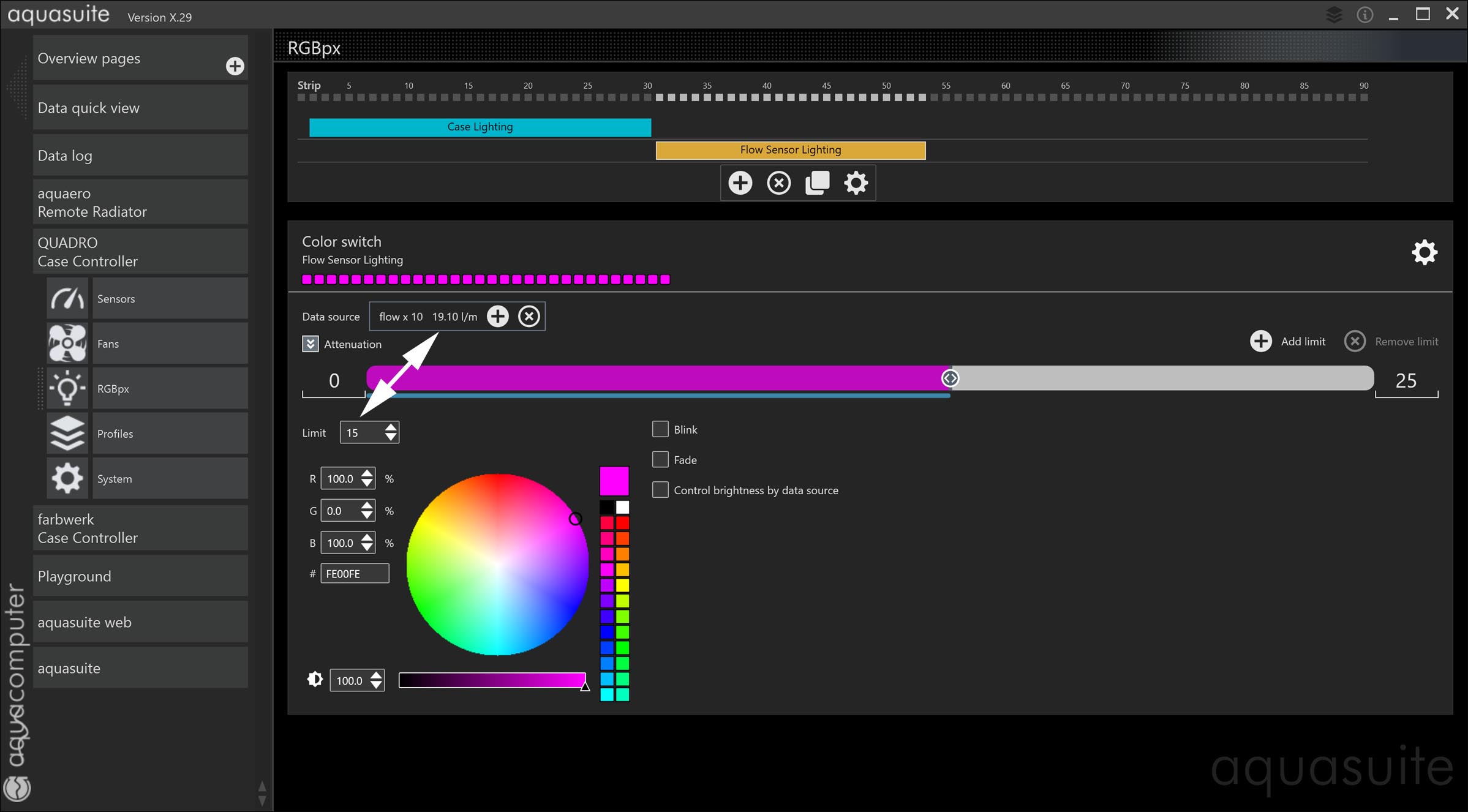

I have the controller set to show magenta when the source is below 15, and white when the source is above 15 controller.jpg

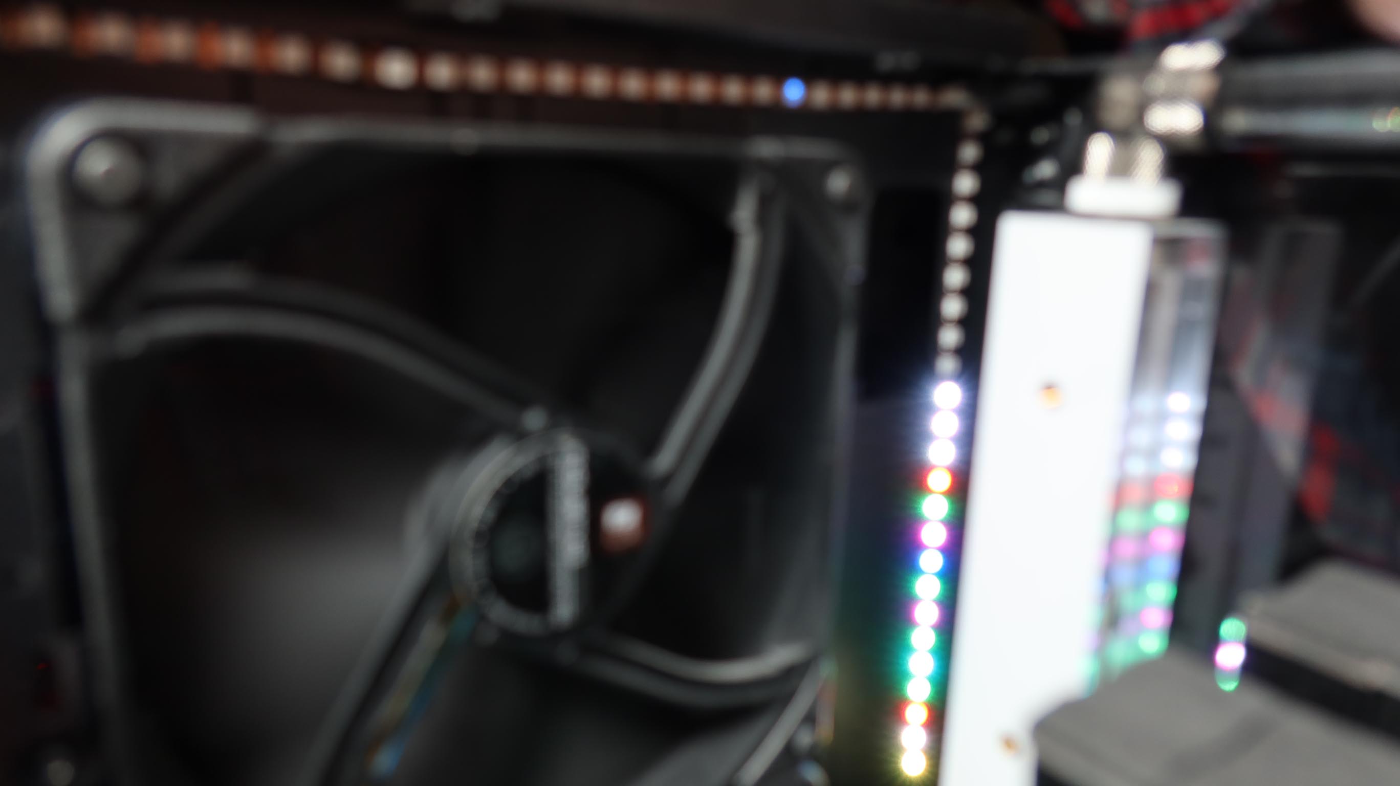

This has been working fine, but today I started getting a few of the LEDs showing green/yellow with the source at 19 leds.jpg
Has the strip gone bad?
Donnerstag, 3. Dezember 2020, 23:46

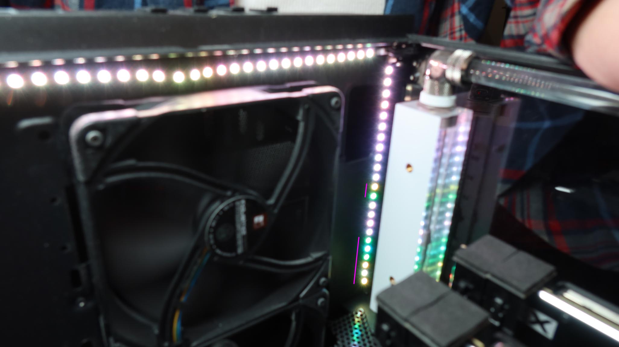

I have two RGBpx LED strip 27.3 cm, width 5 mm, 30 addressable LEDs. The horizontal strip across the top is a full 30 LEDs, and connects to the vertical strip which was cut between LED 23.and 24.
When I delete the controller, the last 15 LEDs on the vertical strip are still lit. It appears I have no control of the last 15 LEDs of the vertical strip, controller or no.
Freitag, 4. Dezember 2020, 07:14
Use liter/hour. Reset the device to factory defaults and set all leds with one controller to a fixed color. is this is working?
Otherwise the strip is defect.
Freitag, 4. Dezember 2020, 13:34
Looks like the strip is fail... lasted about 9 months or so :/
