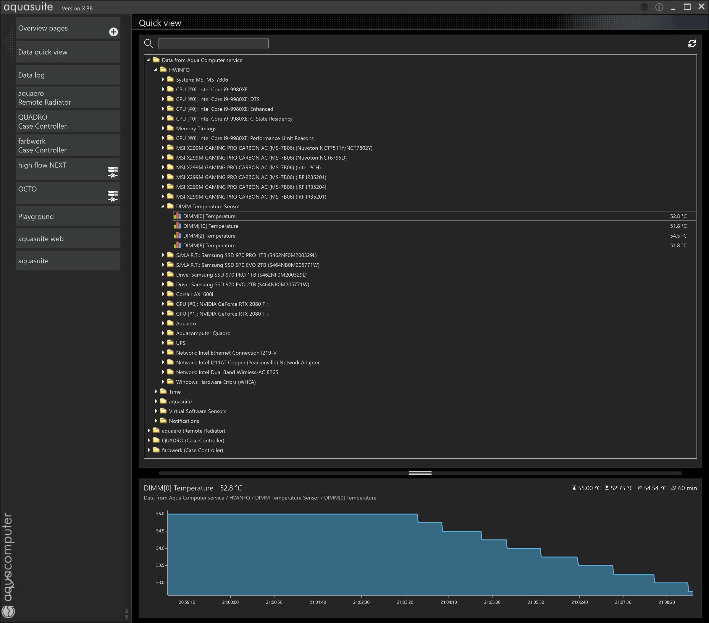

if you can see similar to this --> dimm.jpg in the aquasuite 'Data quick view' tab, aquasuite is seeing the temps.
I am not familiar with the Nuvoton import procedure, but if it pulls data from the quadro, you may need to import the temps to a Soft.Sensor in the quadro.

Thank you for the reply. I definitely don't have that in the quick view. How did you pull in HWiNFO64? i feel like if I could import HWiNFO info, that I could grab Dimm.

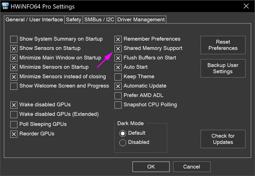

  • right click on the HWiNFO icon in the taskbar area
  • click on settings
  • activate the 'Shared Memory Support' option (shared_mem.jpg)
