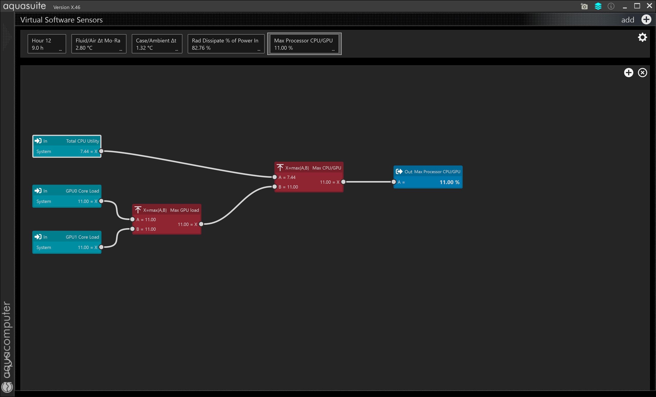

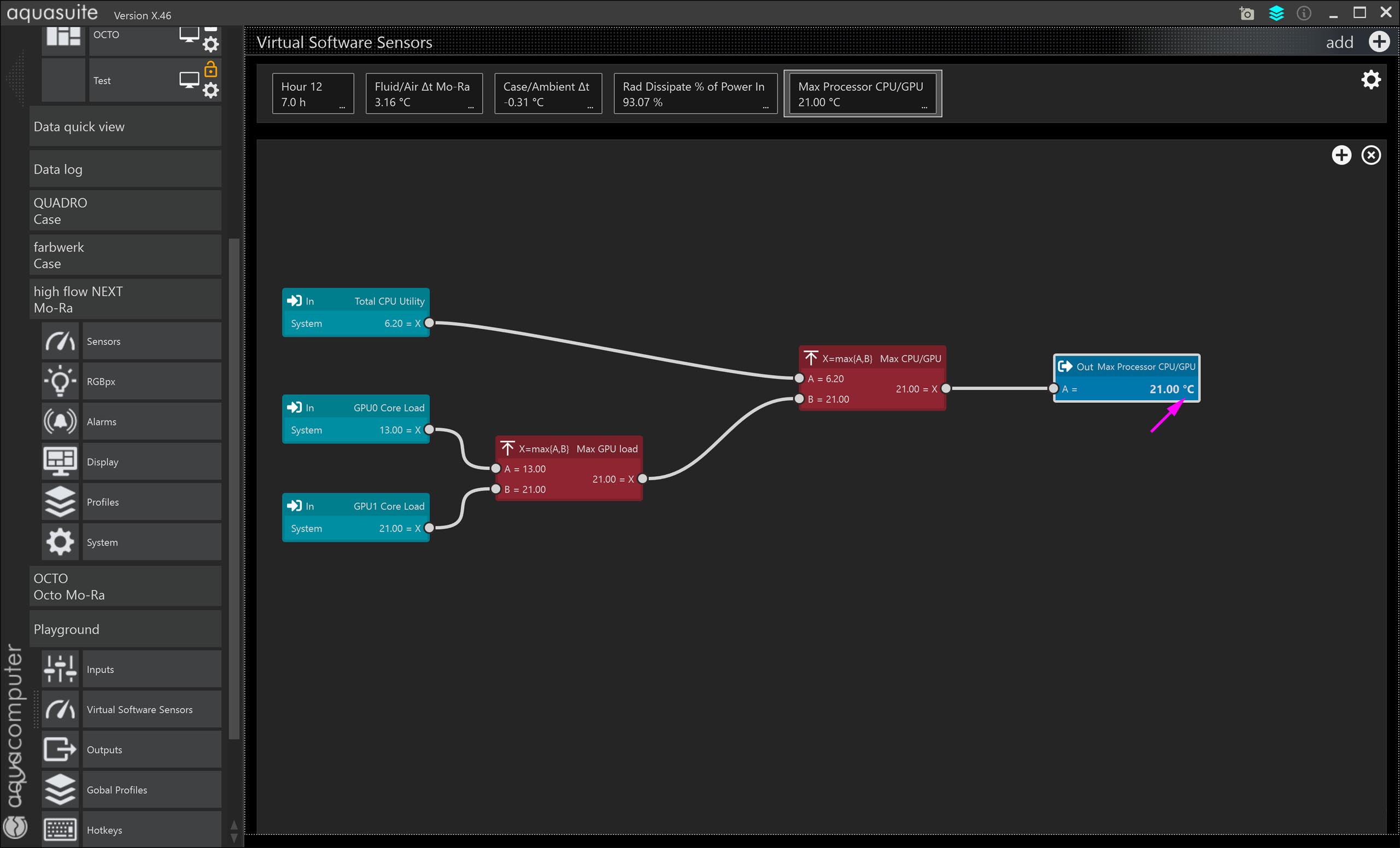

As to your question, here is a sample Virtual Sensor that will yield the highest load of a CPU & two GPUs (max_processor.jpg)

As to your question, here is a sample Virtual Sensor that will yield the highest load of a CPU & two GPUs ([attach]8872[/attach])
Thanks for the sample, I've created this in Virtual Sensors in Playground, but don't seem to be able to use it as a Controller Source on the OCTO? I just get the physical sensors as options.
Mittwoch, 3. November 2021, 14:11
My bad, controllers are restricted to temperature input, so you need to change the last unit value in the Virtual Sensor to temperature (unit=c.jpg).
Then you will be able to import the value into a Soft.Sensor on the OCTO and use it with a controller.

My bad, controllers are restricted to temperature input, so you need to change the last unit value in the Virtual Sensor to temperature ([attach]8875[/attach]).
Perfect, thank you! This is now letting me do exactly what I was hoping for, hopefully it'll work the way I'm expecting!

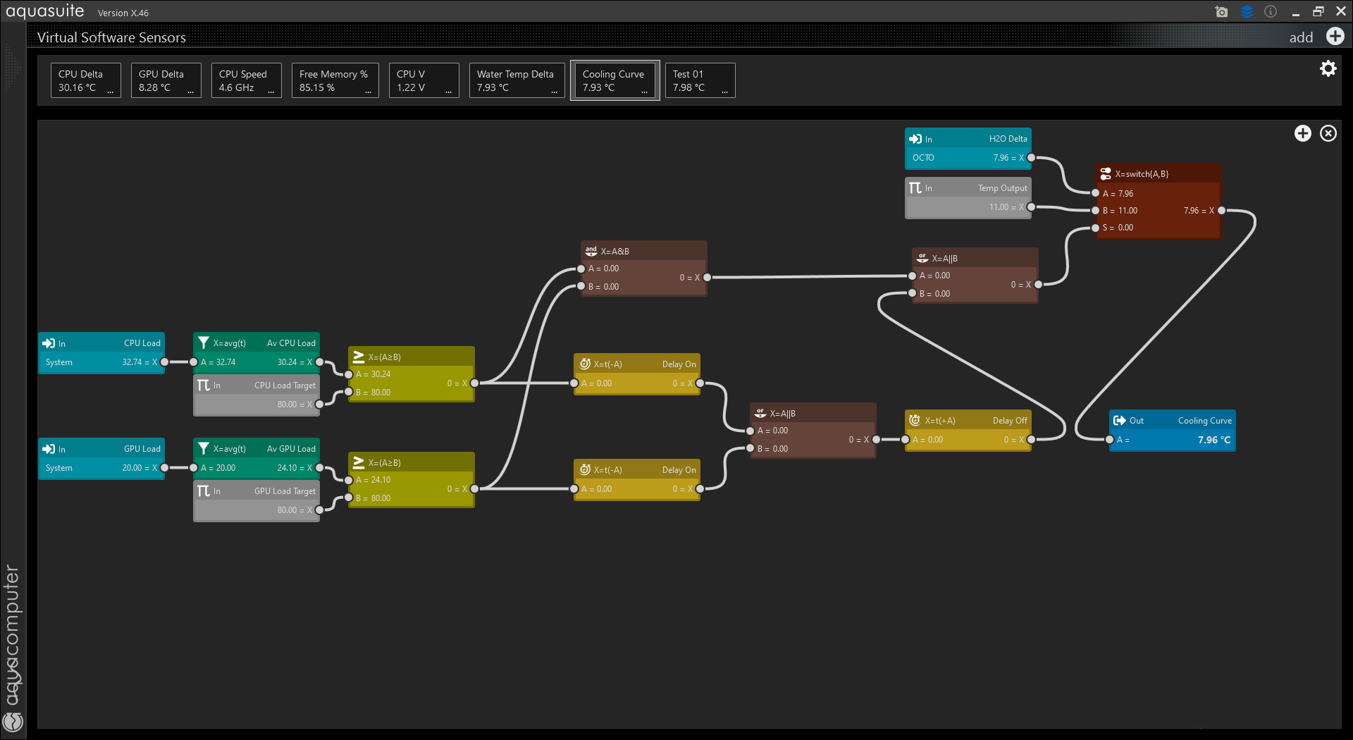

this is a Virtual Sensor that feeds a value to the fan curves for my Radiator Fans.(but could be used to link to the Pump as well if desired)
Normally it just passes the value of my water temp sensor straight through however if both averaged CPU & GPU usage over the last 30 seconds go above a threshold at the same time it sets the output to a value that runs the fans at ~80%
If either the CPU or GPU (averaged over 30 seconds )only go above that threshold for a set period then again it sets the value to a higher one but only after a delay
http://sharetheexperience.co.uk/Osprey/CurveSensor.png
http://sharetheexperience.co.uk/Osprey/CurveSensor.png [/quote]
This is really interesting and uses several filters and functions I have not played with yet. It looks like a further refinement of the setup in THIS POST Giving me some ideas. Thanks for posting this.

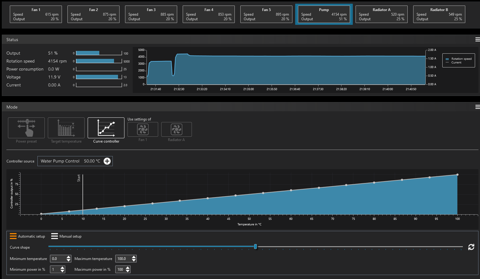

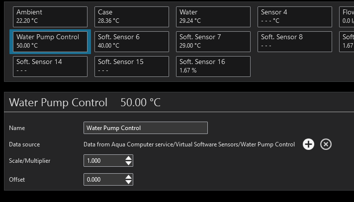

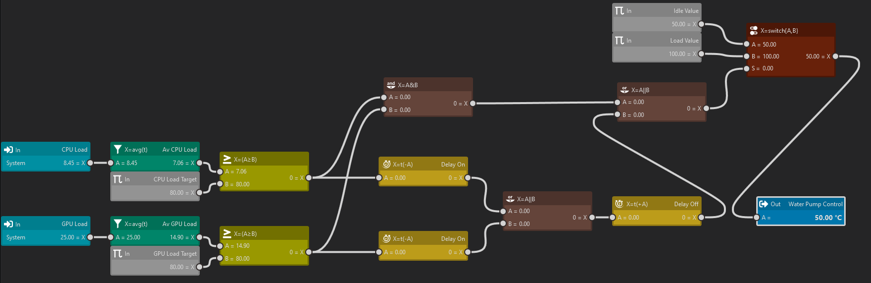

One little tweak and you could use to to switch your water Pump between (in my example) 50% speed at CPU/GPU loads below 80% and 100% above 80% by setting teh switchable output between 2 values defined in deg C.
This can then be attached to a Soft Sensor and in turn used on a fan crve for the water pump however due to the config it will only ever output 50c or 100c (adjust values to suit)
Again same as with my original I've used average loads to smooth out small fluctuations plus delays and combined with an alternative that if both CPU & GPU above a set threshold then the Water Pump is sent the max speed outut.

In this very quick Demo (and I've quickly tweaked my settings to give me the pump speed I want at idle/low load (which is actually a virtual 30c) ) if you watch the pump speed on the bottom left as both the CPU & GPU go above 80% average load for the 30 second period I've defined as a buffer the Water Pump gets sent a virtual 100C which, based on the fan curve) ramps it up to 100%.
Had I done a CPU or GPU only load there would have been a delay before the pump & radiator fans sped up

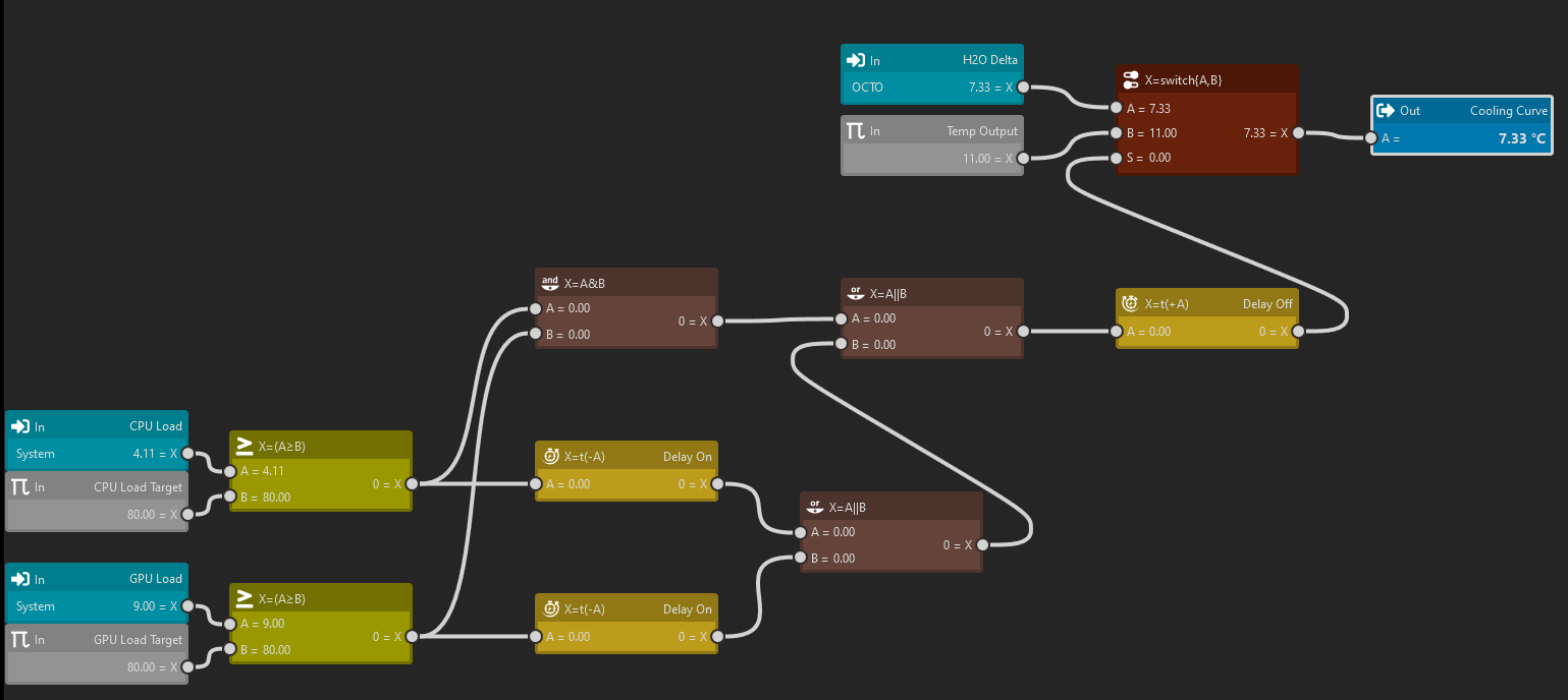

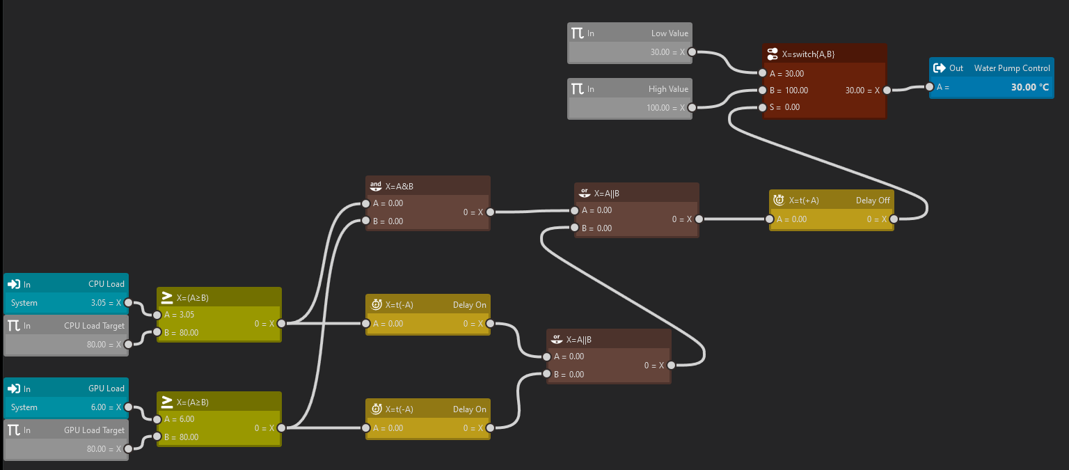

Donnerstag, 4. November 2021, 23:13
Modifed so the delay off is always applied so that the higher values are still sent to the relevant Virtual Sensors for a further 60 seconds (in my case) after load removed
