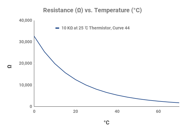

The temp sensors in computer cooling loops are just cheap 10K NTC Thermistors which typically have an accuracy of +/- 5% in the temperature range encountered in a computer. Aquasuite allows you to add an offset to a temp sensor so you can calibrate them by sticking them in a cup of ice water and adjusting the offsets until they both read 0°C. Their accuracy is not linear over the entire range of temperatures they can measure but accuracy is basically the same over the range of temperatures they will measure in a computer. They are generally more accurate at lower temps (like below 50°C) because their resistance changes more per degree C at lower temps. As the temp goes up, the resistance changes less so its harder to measure accurately. Here is a resistance vs temp graph for a typical 10K NTC Thermistor.
