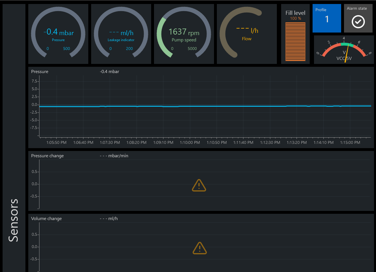

Hi everybody,
Im posting here today because my leakshield is acting strange.
I have had it working for about 2 years, and a couple months ago it started failing I think. Strange how? It doesnt seem to be maintaining negative pressure, and suddenly thinks that my resevoir is 100% full. It thinks it is protected (shield status) but it has not got any pressure so its failed somehow.
How can I find out what is wrong with my leakshield.
Dienstag, 23. April 2024, 07:11
Look under LEAKSHIELD -> SYSTEM, there is an item Device status and diagnostics, simply start the diagnostics, this should tell you something.
In addition, the quickest solution for possible defects is the support support@aqua-computer.de

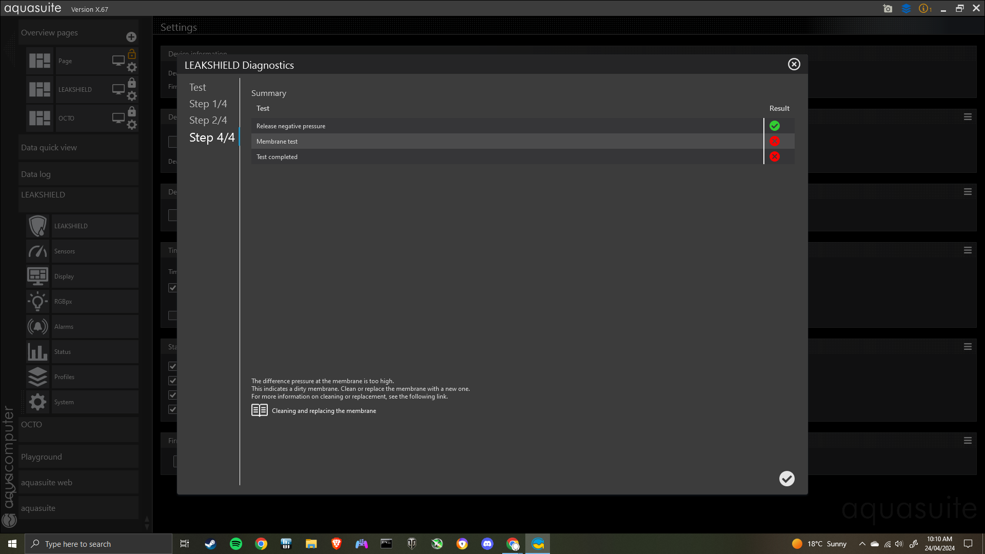

Mittwoch, 24. April 2024, 02:14
Yep you were right. I ran the test and it failed the following.
I need to clean or replace the membrane, so ill start by cleaning it. Im going to follow the linked "Cleaning the LEAKSHIELD membrane".
Do you have any DO/DONTS that I should know about first?
Mittwoch, 24. April 2024, 06:51
If this is the case, you must clean the membrane with isopropanol or white spirit. (Be very careful, use a soft brush and dab with a kitchen towel, then repeat the process several times).
