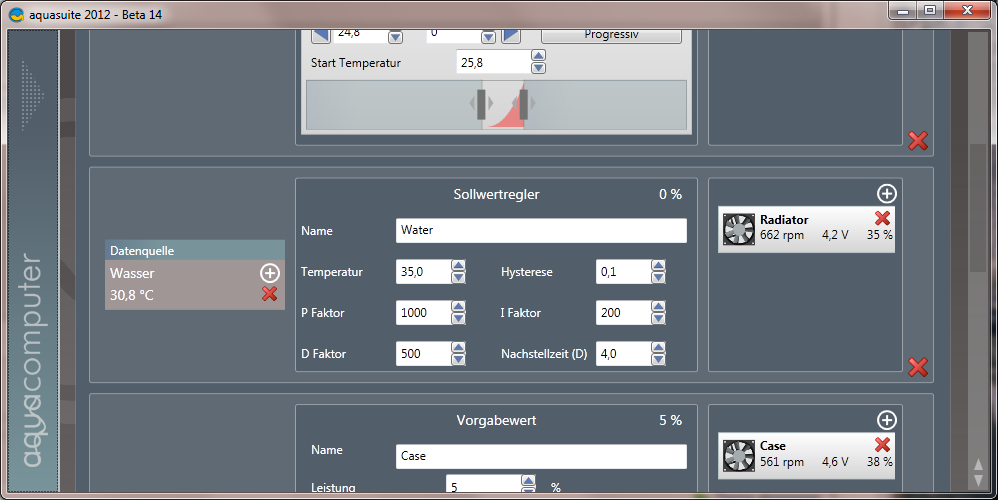

also what are the units of measure for Hysteresis, P, I, D and Reset time(D). min/max values would be nice as well if possible.
so far i have:
Value Unit of Measure Min Max
Hysteresis Degrees 0 10
P ??? 0 30,000
I ??? 0 30,000
D ??? 0 30,000
Reset time (D) ??? 0 60
Saturday, March 10th 2012, 5:03pm
my settings for radiator fans controlled by water temperature. -> fans always running with minimum power.
Quoted
this values does not have a unit. this are abstract values to control the speed an the precision of the controller
