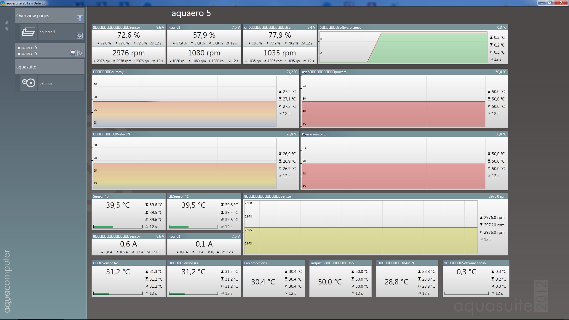

In these days I tried to let work correctly the software temperature sensors, but there was no way with this beta15.
I can't understand where I'm wrong, AIDA is running with administrator privileges, such as aquasuite, with exports via WMI, but aquasuite don't read the sensors.
I've also verified that the ACservice is really running and it is; and I also have the "select datasuorce" problem
I tried running the old ACservice, and it works, but obviously with only 4 sensors.
Yesterday I had also a couple of strange problems, the first is the one that I've attached: it seems that aquasuite, at every reboot, lose the memory of the sensors names, but this I've solved it.
The second one: aquasuite does not run at the startup.
obviously I've selected the voice "start AS with Windows" but it worked only the first reboot. ?(
I hope you can find a good solution to this problem :) because it's really frustrating ...
Did you uninstall the Aquasuite Beta 14 before you installed Beta 15 version? I solved the "select datasource" error problem by shutting down AIDA64 completely, including from the startup sequence and then configuring Aquasuite before restarting AIDA.
Try shutting down AIDA64, also making sure that you deselect "Load at Windows Startup" option in your preferences, reboot and make sure it is definitely not running. Then configure Aqausuite (Beta 15) by enabling the software sensors and ticking the "use sensor with aqua computer service" checkbox. DO NOT press "selct datasource" yet. Restart AIDA64, making sure WMI export is activated and that it is set up to restart with windows, and also that you have some sensors selected, and SAVE your settings. Now you should be able to "select datasource" without the error message in Aquasuite.
917K
Sunday, July 29th 2012, 5:06pm
Tomorrow I'll try to do as you have indicated, however, I hardly believe it might work in my case, because the procedure that I followed to configure AS is very similar to the one you have suggested.
In fact, I have uninstalled AS beta14, then installed beta15 and after that I’ve configured it only when AIDA was not running.
Before proceeding with the installation of beta15 I also tried deleting the data of the old version, stored in C: \ ProgramData but it did not do anything.
As I told, I’ll try again to do more tests to try to solve these problems.
Thank you very much for the answer. :)
917K
Monday, July 30th 2012, 8:17am
ok, I just finished to follow the procedure you have suggested, and unfortunately it did not work.
cc01
Monday, July 30th 2012, 9:08am
Did you load an old profile? Delete any old profiles from previous Aquasuite versions and reconfigure everything. Profiles from beta 14 won't work properly with beta 15.
917K
Monday, July 30th 2012, 11:27am
no no, I had already deleted all the old profiles, this week I'll try to format, reinstall win7 and repeat the procedure.
