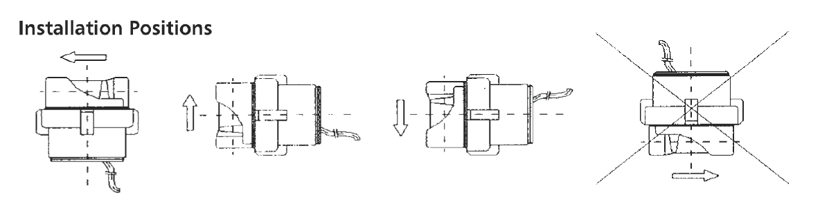

From the D5 manufacturer website concerning pump installation positions:
The full PDF for the D5 pump is here FYI: http://documentlibrary.xylemappliedwater…2/08/IM-17A.pdf
Website link: http://unitedstates.xylemappliedwater.co…ing-thermotech/
Is the reservoir supposed to be mounted into a bay as shown in the PDF from audiophile or is it shown upside down to illustrate how to attach the pumps to the reservoir? Is there anything else in the documentation to suggest the orientation of the reservoir installed into a computer case bay? It seems too much of an obvious design error but it might be worth asking Koolance directly to clarify on this question ...
