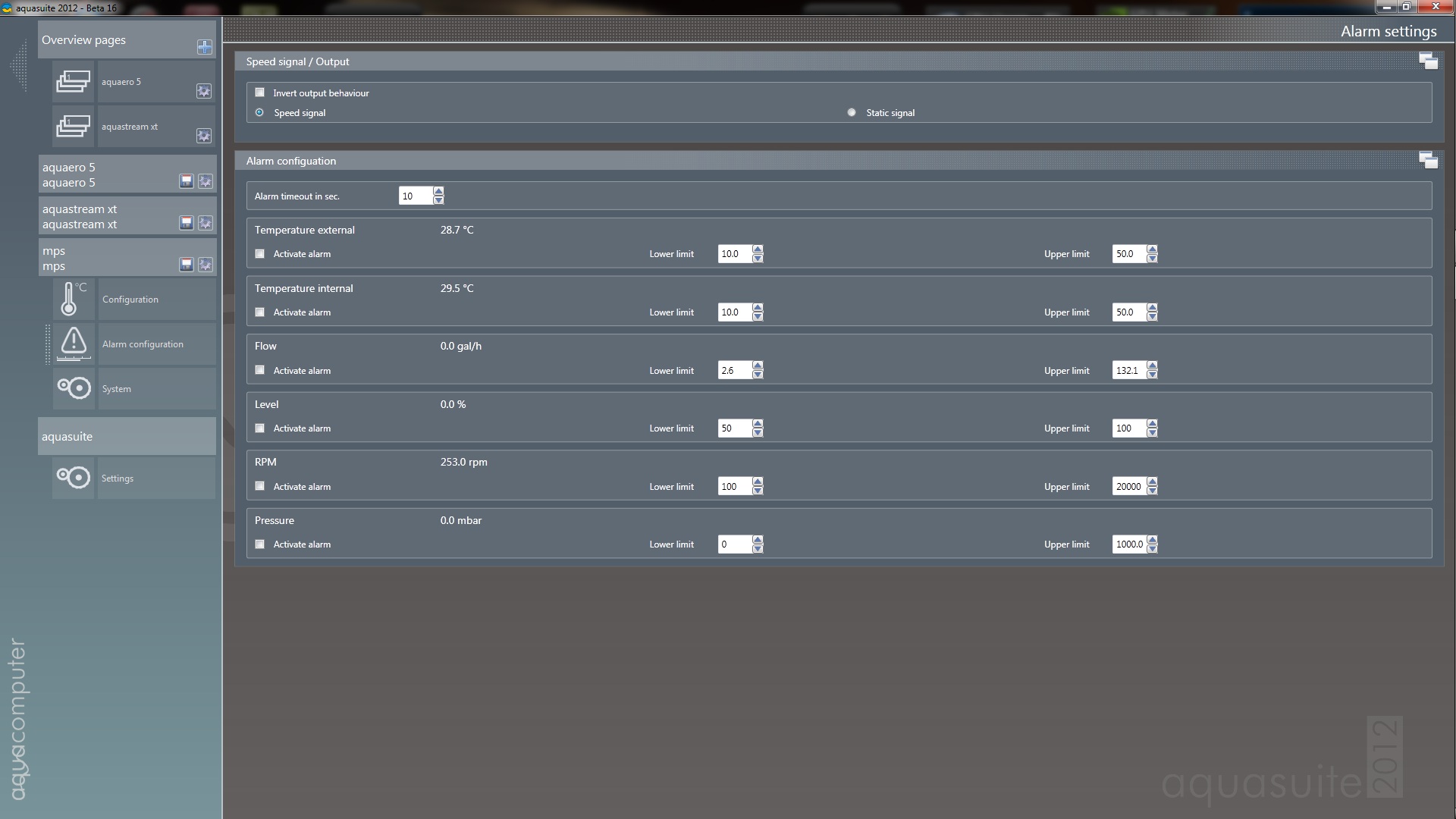

this is without the usb hooked up i dont know if this will help i still dont get a flow.i just took apart everything and put it back together just to see if the flow sensor was working .it is well it spins do i have this going the right way.ohh and will this hurt the pump being this way.is there something i am not hooking up the right way. now i have it hooked up to usb and i get nothing,i even hooked it up all by itself and nothing.now on the picture 18 there how come my aquastrean xt pump dont show anything on there looks like its a broken feed ..lol i tried to get a pic of it hope u can make out.need all the help i can get.

LarryWill729
Saturday, October 27th 2012, 8:31pm
The High flow USB works fine in any orientation and in/out connections.
On the page "mps/Configuration/device" you have the wrong flow sensor selected. Click on the scroll bar next to Device and scroll to the bottom and select "Flow Sensor High Flow USB"
You will not hurt the pump unless you run it in a dry condition, and the flow sensor is almost bullit proof.
Most likely place for damage is a broken wire in one of the cables.
As far as I can tell from the pictures, I think you are almost there.

thanks alot i have now 205.2 l/h me ripping apart my computer to check to see if the flow sensor was working and it was just a setting..lol would u happen to know why my pump wont show up on the srceen like the 50 or 60 hz u know .thanka alot again. this is my first watercooled build like this i did do the corsair h 80 thing.

ok u wouldnt know how u would get my flow sensor into one of the charts on the aquaero 5 xt. hey larry how do i do that .lol i will be cooling my 680 when i get some more money.lol how do i play with the software for the pump. i did do the fans i finally got them on the curve but dont know how u do that for the pump.how do i get my pump on the screen and how do u get my flow on this chart 1. and there is another for my pump .anyone please

LarryWill729
Sunday, October 28th 2012, 2:34pm
To make flow show up on Aquaero 5 screen, you must change the Display Screen with AS2012, look for Information Pages tab, click on it, under available screens is a drop down box, scroll down to flow sensor and drag flow sensor 11 over to the right hand side under Displayed screens.
Done.
