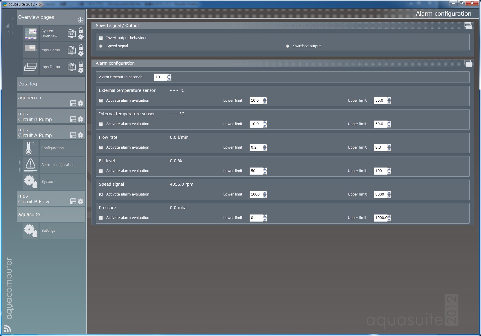

maximd18
Thursday, March 7th 2013, 2:38pm
Thanks guys.
I reconnected everything with USB and Aquabus. Set the IDs, and saved. Then rebooted.
It doesn't help.
Here is some SS.
I try to control the pumps... fail on ID 13 or Circuit B pump only.
ID 12 or Circuit A pump responds normally.
at first I was only able to select D5 1, 3, and 4.
later, I rebooted Aquasuite, then I saw D5 2 so I added it. (SS 12)
