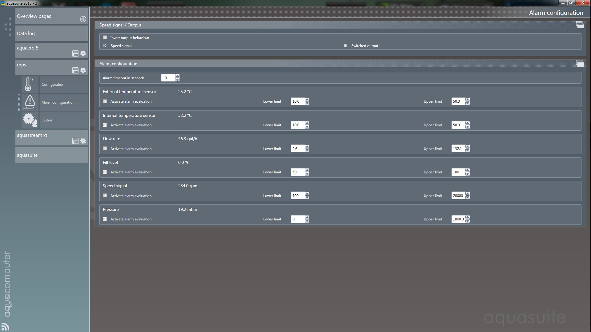

i dont have no fan connected to the flow meter(this is the one i have ...http://shop.aquacomputer.de/product_info…roducts_id=2897) when i click what i said above it will turn fans full blast then will show flow but only when i clcik the one setting
pegleg
Saturday, August 10th 2013, 9:08am
see first pic nothing but when click the active fan 1 it will kick on the fans on channel 1 how do i get it not to kick them fans on and show the flow in a5 screen and in the aquasuite.it has flow on mps last page but how do i get it to show up on screen or software

I've been attempting to setup my High Flow Meter USB with no success. I have it hooked up by USB at the moment but I cannot seem to get it to show up under the "sensors" tab under aquaero.The flow rate and internal temperature sensor seem to be working in the alarm configuration tab.I have tried everything hooked new aqua wires to it,plugged in both usb and hooed to aqua high flow the only time i get a reading is when i click in the aqua software on the aquaero 5 is sensors then click flow and then click the second flow and click on mode and click active, fan 1=flow sensor 2 then i see flow , when i click mps i see in the alarm tap that there is flow says 47.8 gal/h i hope someone understands what i am trying to say thanks all

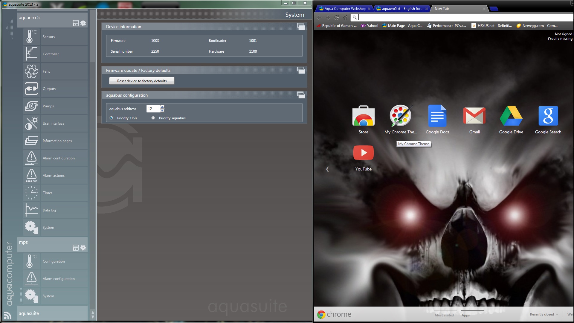

Export profiles and re-flash firmware, this resolved issue for me where fan channel 4 although programmed to start never actually did anything, Given your other post indicating a molex was not correctly fitted, perhaps you have damaged the firmware or device.

With the fan channel 1 set to operate as fan, are you able to setup a alarm configuration for flow? in the AQ5 page or are you limited to using the MPS page.
As flow is output only, it can be logged/displayed and/or used to initiate alarm action. Can you do either?

Overview select gear/cog and choose to export page (overview is separate to profile)
Aquaero select: system
select "settings" and export profile
Select "firmware upgrade" and choose to upgrade firmware...if you are already at latest - no problem just overwrite.
select "Settings" import profile.

Aquaero alarm configuration select "flow alarm" and see if you can add your USB high flow as the source.
select action as alarm 8 and select value that will trip the alarm ie flow rate of 100gal/min.
(if you cannot select High flow USb then the new range of usb devices may not fully integrate into Aquaero 5 (perhaps there will be a AQ6 one day) in which case you maybe limited to using flow rate in "mps" which I see from your posted pictures does have a alarm configuration option, but I am not sure what action is triggered by this alarm mps alarm?)

Flow 1 and Flow 2 have nothing to do with the USB high flow or MPS pressure based flow sensors, they are only for the non USB flow sensor connected to the "flow" port and fan header 1
To get a USB flow meter to show in the Aquaero tab I'm pretty sure it needs to be connected via Aquabus to the Aquabus high port and have the priority switched to Aquabus.
The Flow meter works as you have it set, and you can add a flow guage or graph to an overview page in Aquasuite because it is connected via USB ... but to see it in the Aquaero tab it needs to be able to talk directly to the Aquaero, hence the Aquabus connection.
The High flow USB sensor should show up as flow 11

i had it all working before i redid it,because got new case and did the tubing again with the acrylic tubing,i have it hooked to the a5 high flow my pump is on there too pump shows up but not the flow usb.i have tried swapping out wires and all,it will not show flow 11 under flow sensors,could my aquaero5 be messed up?can i reset the flow meter ?
