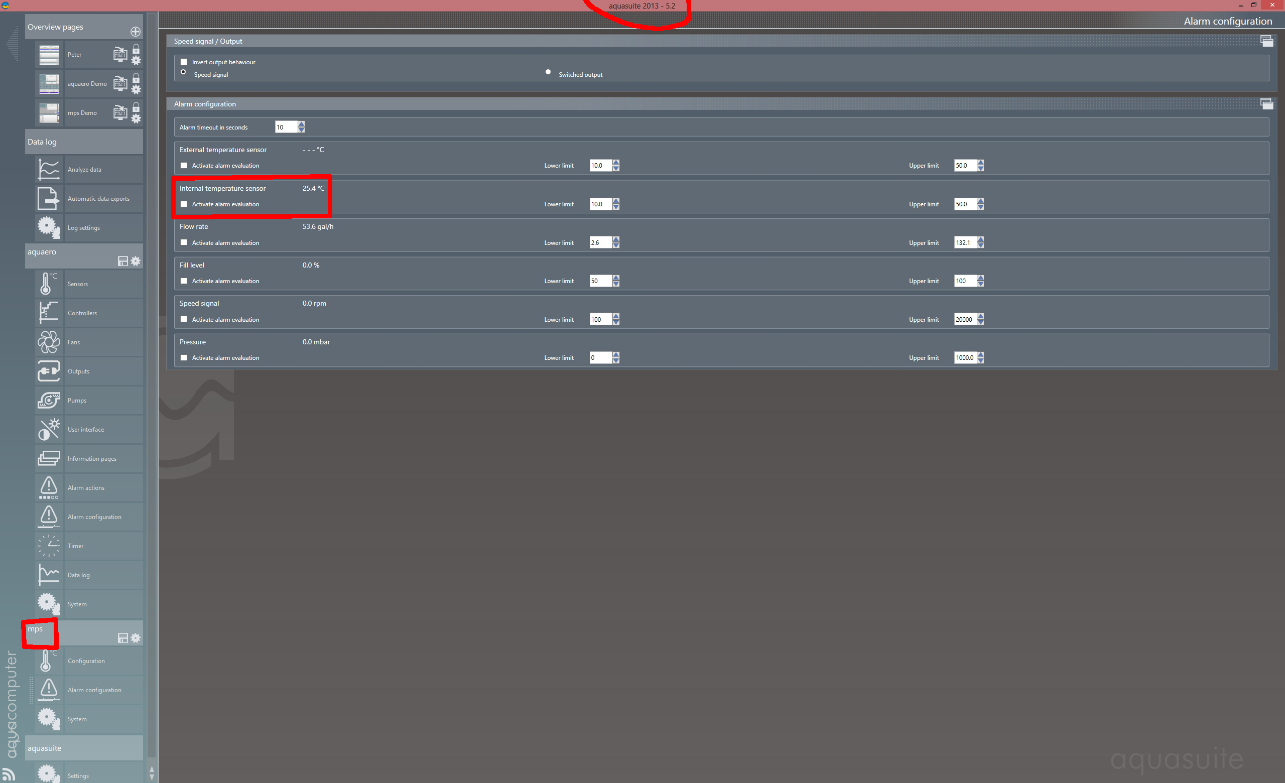

In the first screenshot you'll notice that the MPS 400 is reporting the internal temperature and it's labeled as internal. This is good.
However, the AQ5 lists the MPS 400 internal temperature sensor as "mps 1 external" which is incorrect. I don't have an external temperature probe attached to the MPS 400. While I can correct this issue by renaming the sensor it should be looked into.
Take care.

Spoke with Sven at AC. They're aware of the issue I posted above.
