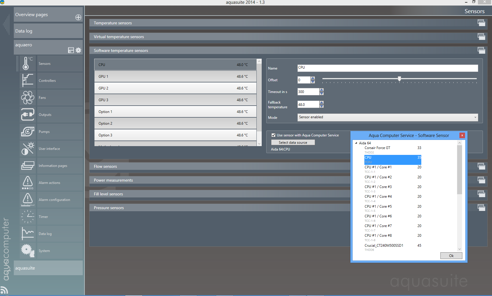

After reinstalling windows 8 and a fresh version of Aquasuite, the software will no longer import AIDA64 data. You can see in the pic that it sees the data but will not import it into the software. I have un and reinstalled the WMI service and am running it as administrator. I should mention that it ran for almost 2 months without a hitch before this anomaly. Since I use the CPU temp to drive some of my controllers, any ideas how I might get this fixed would be a great help.
One more question: Can anything be done with the Pressure Sensors? I cant find any way to access the data for controls or logs.

I have two Aquaero 6 XTs. One is on a Windows 8.0 system and one is on a Windows 8.1 system.
I use aida64 on both the systems to transfer sensor data to Aquasuite 2014-1.3
I have not encountered a problem with reading the data with Aquasuite, and using it in the Controllers.
Wish I had a solution for you, but without a problem I obviously haven't had to look for a solution.
Just wanted to reassure you that it does work.

Is your aquaero service running?
Looks similar to the behavior it will have without the service installed

The service is running and is running as admin. I know the feature works, it worked for me up to a month ago.

Hi guys, still have the issue, I cant get the software sensor to display data. Aida 64 is working, I'm logged in as admin, I can see the correct temps in the source selection popups but when they are selected they do not populate the software sensor field, I just get the default. #[url]https://plus.google.com/105529742818195922083/posts/fd7jLctxNa6#[/url]

When I had this happen, I uninstalled aida64 and then re-installed an older version. The values then appeared in Aquasuite and have remained as the aida64 updates to the current version were applied.
