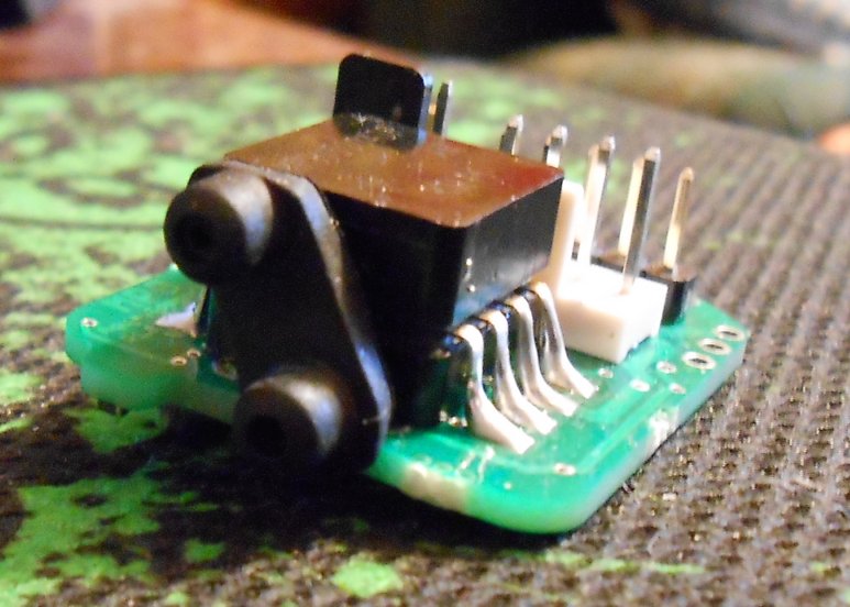

One o-ring does not have sufficient downforce.
I performed an experiment.
1. set board mps as it was originally installed, syringe hole on the top cover under the pressure of the water cast out.
Water began leak where there is a o-ring.
2. If the o-ring finger pressed to the body of the adapter, the water began leak from the other end of the sensor, which has not set the o-ring manufacturer.
I think that holes for the sensor made ​​too wide or ring too thin.
In general, the manufacturer must test the final product. And here we have a real defect. Manufacturer said not a word.
Piopi_2 has attached the following image:

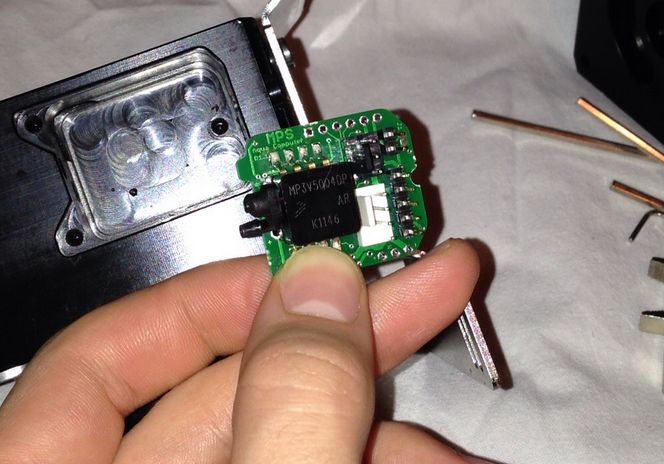

Tuesday, December 17th 2013, 5:10pm
my mps board and mps board my friend. differences
support save silent
Piopi_2 has attached the following images:
