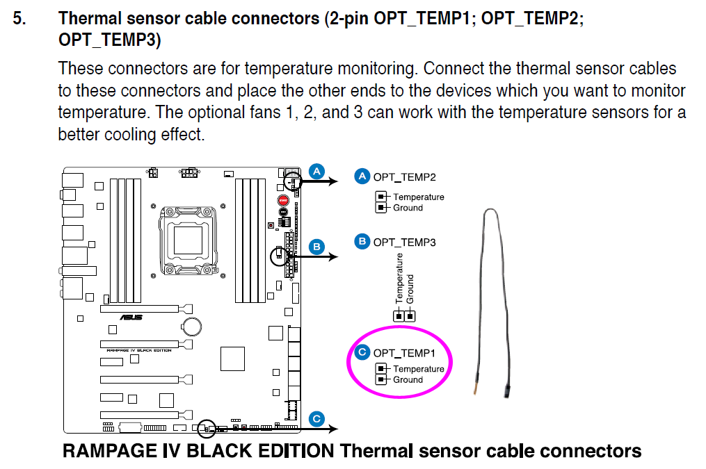

I have never installed thermal sensors before, not really having modded much.
But now I need to add thermal sensors.
The sensors come with a 2 pin connector, and I don't know if polarity matters.
My motherboard manual differentiates the pins as Temperature and Ground:
And the sensor plug has a small arrowhead on the plug by one of the pins:
But the aquaero manual lists no distinction:
Should I assume the arrowhead marked pin to be the temperature lead, or does it not matter?
pcRelic
Monday, January 5th 2015, 4:19pm
Don't worry, there is no polarity in this type of sensors. In fact the sensor is a resistance which value varies accordingly to the temperature.
Monday, January 5th 2015, 8:13pm
Great, thank you for comment.
