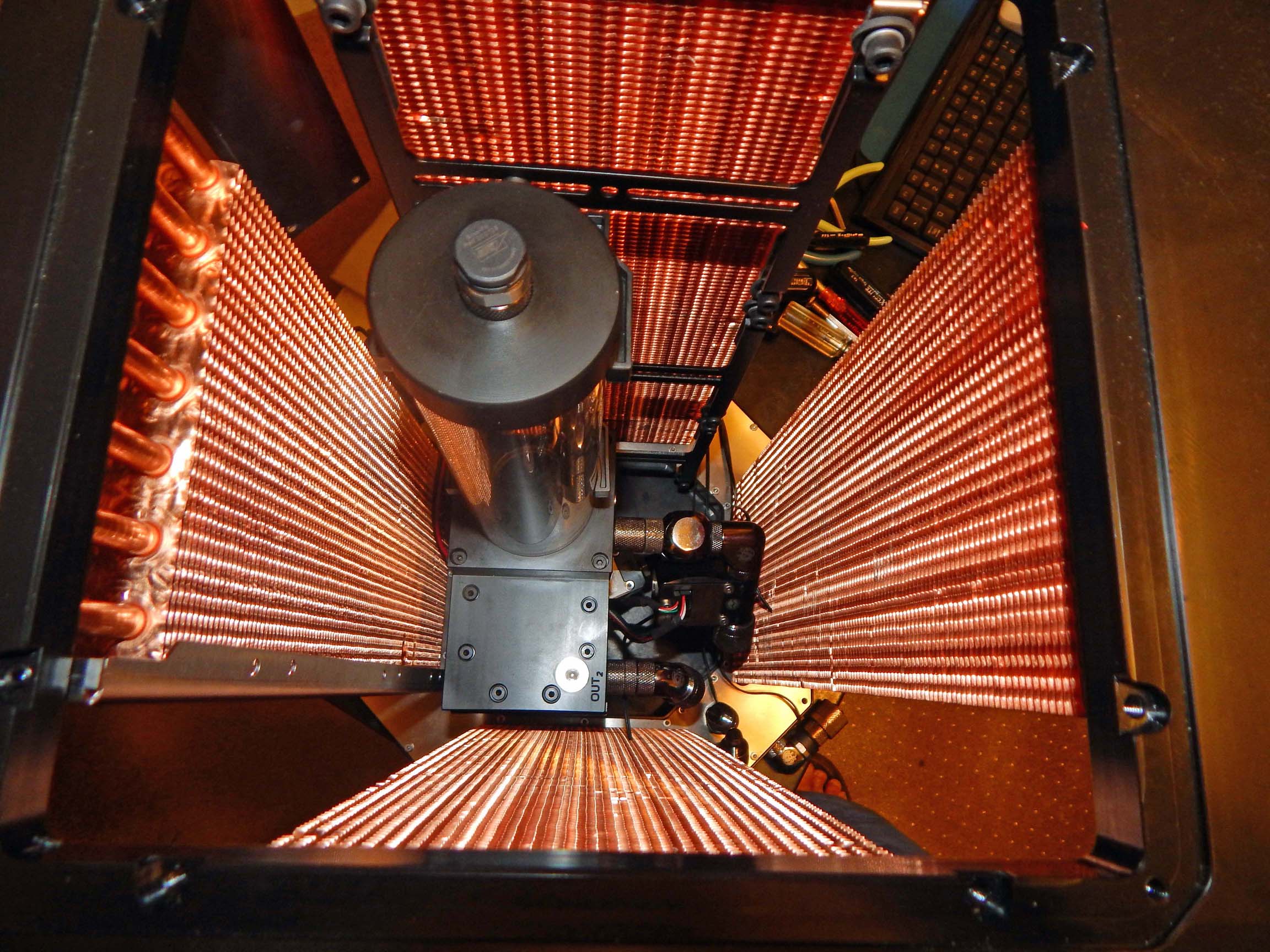

View of the components mounted to a set of airplex GIGANT 1680 Fan Rails ready for installation.
View of the assembly mounted inside the airplex GIGANT 1680.

Placing the radiator, pumps, reservoir & associated accoutrements external to the main case leaves the interior of the case very open, and also removes the heat of those components.

@InfoSeeker Is it possible that your setup causes a "short loop": After coming out of the pump and go to the inlet port on the right, the coolant then go back to the inlet port on the left and then return to your reservoire, not going through the pipes?

I am not sure of the path you describe, but no, there was no possibility of short looping... there was one direction only.

In the reddit post I realized that there are two paths from the outlet "IN" port to the copper pipe.
  • One is via the left inlet port to your res then to your pump then to the right inlet port. From there it goes to the pipe.
  • The other path is very straight forward. It goes directly to the pipe from the outlet "IN".
My worry is setting up like this there might be a possibility of the flow goes back and cause "short loop"
(Sorry for the ugly draw)
EDIT: OH, you mean to avoid this I should use the headless screw to block the "straight forward" path, right?
This post has been edited 1 times, last edit by "AquaCustomer" (Feb 5th 2024, 1:38am)
Monday, February 5th 2024, 3:10am
Correct
