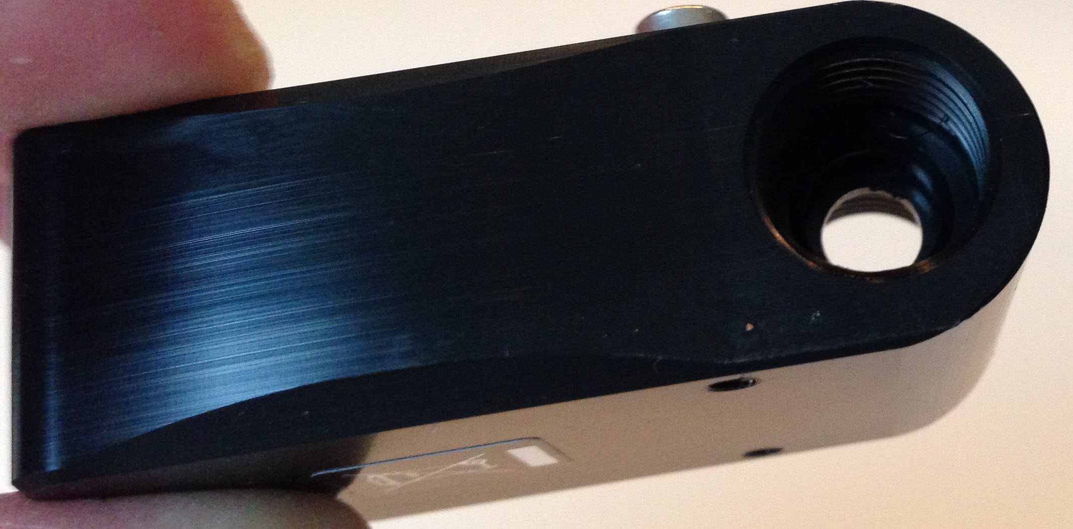

I just recieved my flow sensor mps 200 and it is truly a tiny item.
When I looked closely through the hole I could see some leftover from the machining and wondered if this is ok, or should I return it?
It was impossible for me to take Photos that showed it all, but you can see some of it on the images here. There are some stuff in the threads as well.

You definitely want to talk to the support group at aquacomputer about that.
They advised me to NOT have angled fittings near the inflow to the sensor, because turbulence from the fitting would confuse the device.
The instruction was to leave as long a straight run into the sensor as possible.
The leavings in that bore may create turbulence and possibly yield incorrect results.

I thought as much. I sent them a support request earlier with link to this thread for images.
I read about the elbow fittings and turbulence before I bought it, but I sort of have to do it anyway. Longest straight run in my system is a few cm.
I thought about using a new drill with diameter that matches the inner radius and make a few rounds to get the plastic away. - using my fingers only, but not going to do anything untill they get back to me on the subject.

I was told I could return it if i wanted to.
But I could also take out the left over plastics with some small tweezers and that is how they did it.
After I found some small tweezers and removed the small plastics I noticed the center wasn't entirely round... they told me it didn't matter, but my flow really seems off by a mile.

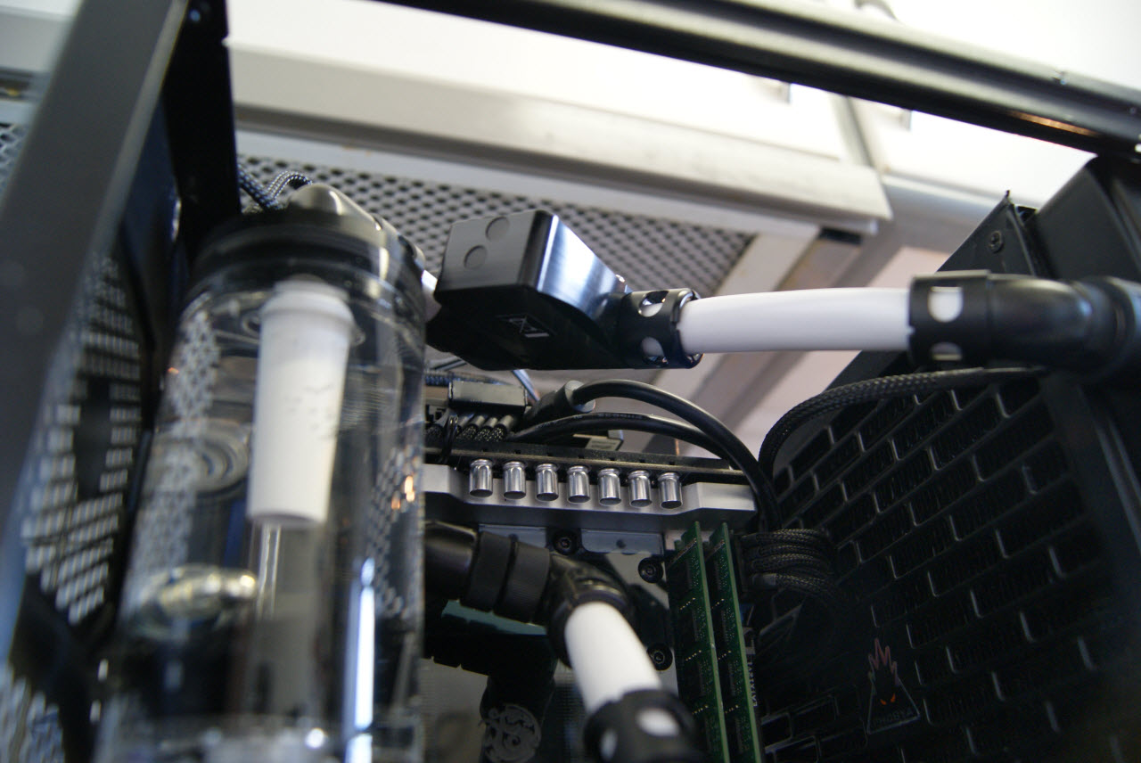

I might move the flow sensor mps Down to the straight run of White tubeing and make an elbow fitting on the outlet.
Buying an additional sensor is not an option for me as I just bought this one. They are unfortunately rather expensive :!:
Aqua-computer staff suggested making a manual calibration using a couple of 10L buckets or similar, which I might end up doing if the replacement unit doesnt improve on the accuracy.

:) no offense taken... I realized you were thinking out loud.
I managed to get about 90 to 100 mm of straight run into the sensor on mine. Hoping it's enough.

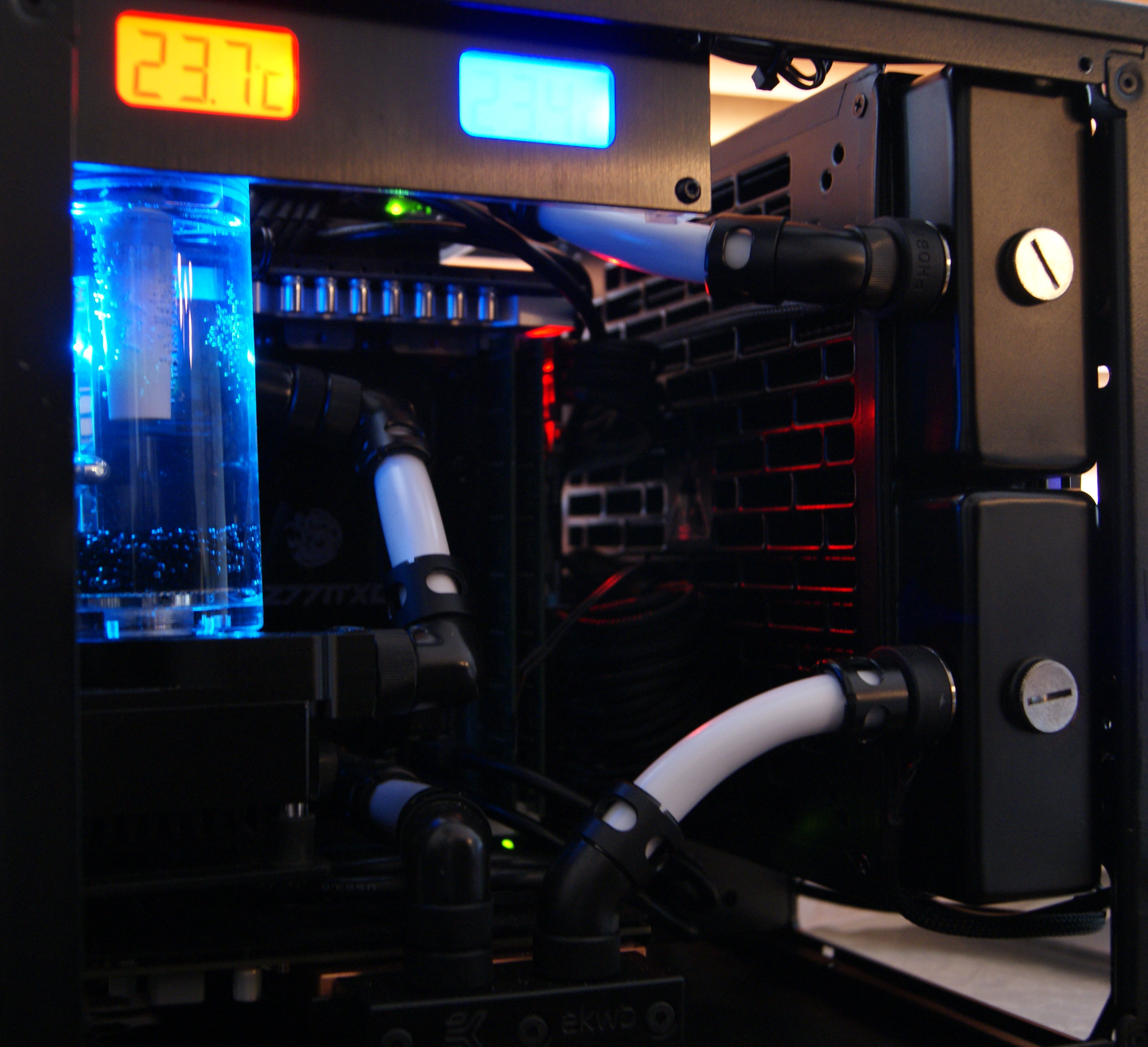

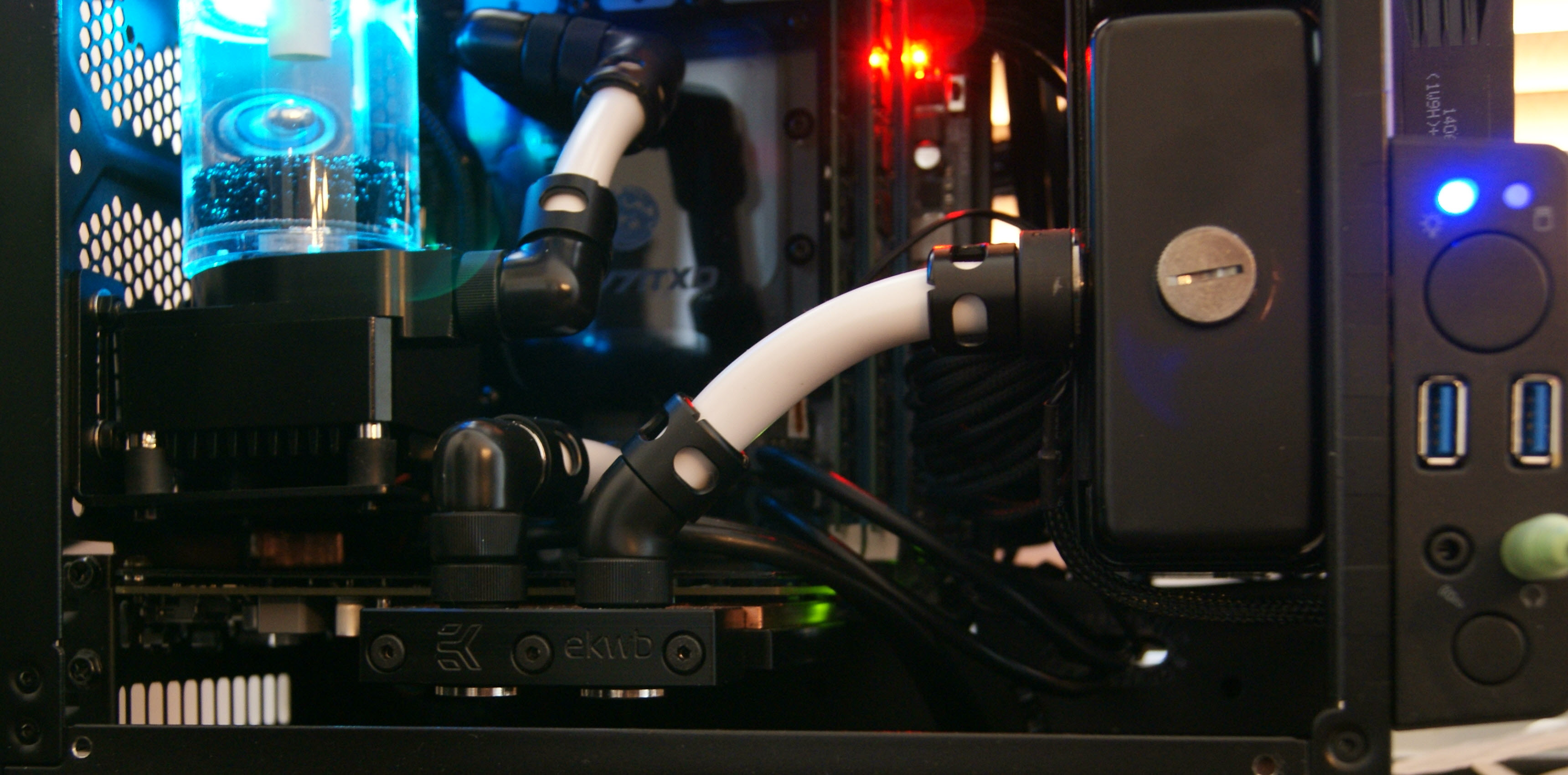

It really should be as 9-10cm is A LOT! I pretty much only build mini-itx systems, and I don't have a single cable run that long in my case!!
I talked to Aqua-computer and I can get my mps switched to a high-flow thingie if i can't get this to Work properly.
One thing I've noticed is how the MPS seems to Loose the settings after comple power-off. Ie, I have to reset flow-calibration parameters..
You know what the "internal temperature sensor" is? It doesn't seem to be Water temp.. or at least it doesn't match my other sensors if it is.
edit, a few pictures of my build so far.. still need my ram-block :).. Last image is the cause of my flow problems I take it.

Just redid the top of my loop to make room for as long a run as I could squeeze in there.
It's not possible to make a longer straight run.
I don't know how long it takes for it to calibrate or what it does, but now it says flow at 62 L/H. I don't know if that is realistic or not. It jus bugs me how it tops out at 200L/H very quickly... I don't run my pump fast, but I'd like to have the option.
While at it I added 1 drop of biocide and 1 drop of blue dye - going to change the Water later this month when I get a new ram-block, and was curious how it would look.
Was surprised at the very cloudy look the biocide caused... it was dilluted some, but still.
