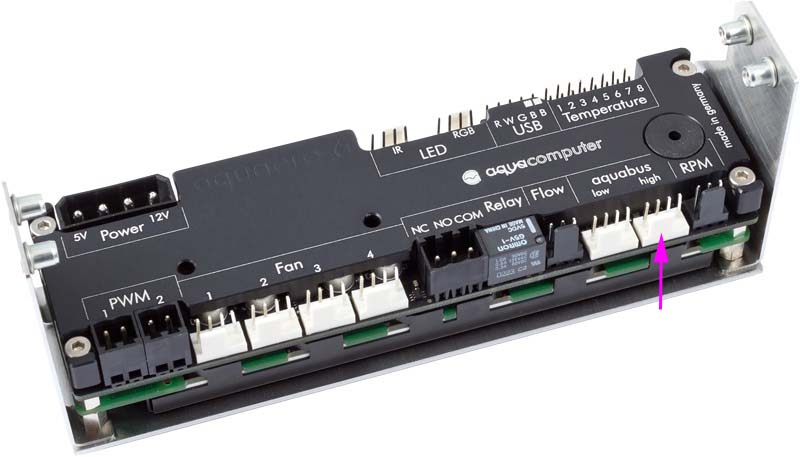

I bought Aquaero 6 Pro and D5 pump.
I Includes USB cable and 3 pin.
1. How do I connect the pump to the aquaero to fully control it?
2. Do I need to buy a 4 pin cable Aquabus?
Thursday, May 7th 2015, 8:31pm
From your post I will assume you have the Aqua Computer D5 pump motor with USB and aquabus interface
If so, you can use the 3 pin aquabus cablle included with the pump. The aquabus connectors on the D5 & aquaero are 4 pin, but only 3 pins are used.
use the aquabus plug on the D5 and the aquabus high on the aquaero
EDIT: did you get a satisfactory resolution to your reservoir top and clamp needs?
[attach]5250[/attach]
[attach]5251[/attach]
You're right I have exactly this the D5 pump.
I was afraid that I bought the wrong cable. In addition, I bought a 90 cm 3 pin.
Confusing is the 4 pin plug and 3 pin cable added.
This manual should be about the information that they act only 3 wires in the Aquabus :)
Thanks!
Thursday, May 7th 2015, 9:32pm
Actually, to confuse things a bit, the aquabus is a 4 pin bus, but the 4th pin is +5v (I think) and is used by other MPS devices using the aquabus ( i.e. flow sensor & pressure sensor).
You can use a 4 pin aquabus cable on the D5 pump, but it simply ignores the 4th pin.
