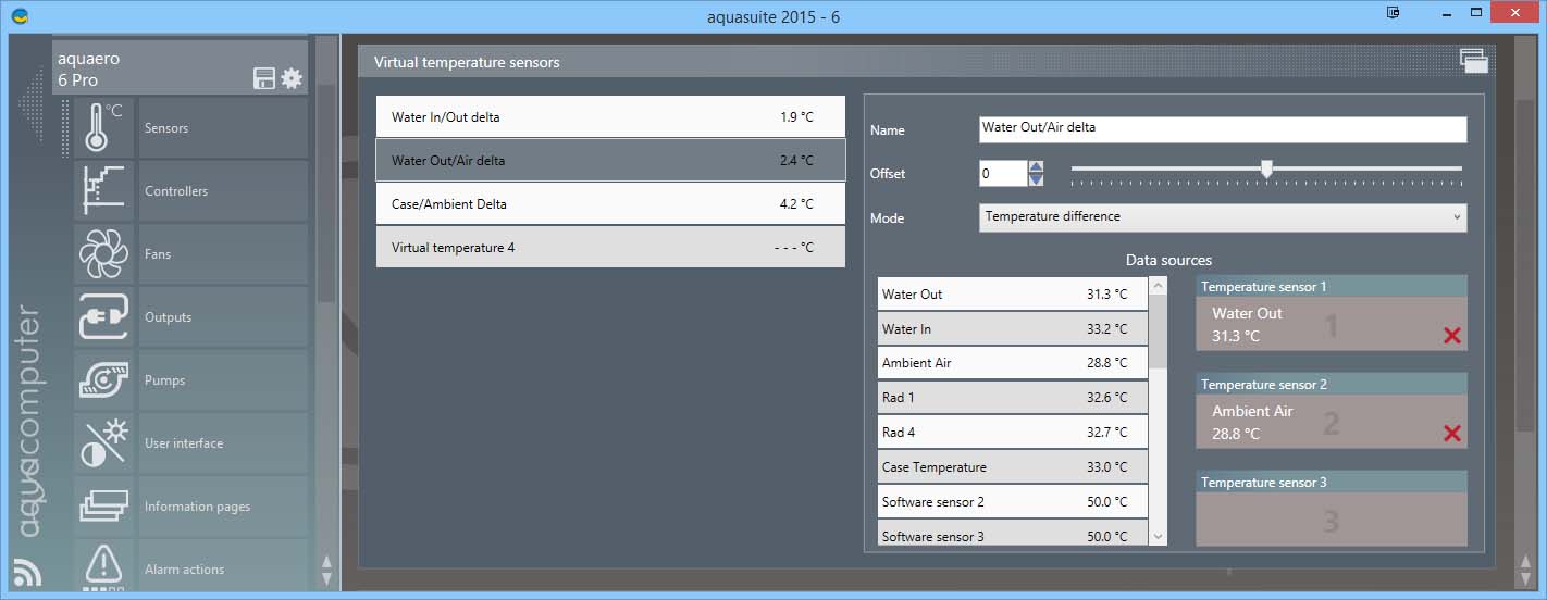

Wednesday, August 12th 2015, 5:59pm
Not sure if this is useful for you, but I will toss it out in case.
I made a virtual sensor that is the delta between water-out of the radiator, and the ambient air temperature:
And then I control the fans with the virtual sensor:
So as the water-out temp rises above ambient, the fan power is increased, and visa versa.
This way the loop temperature floats with your ambient.
This post has been edited 2 times, last edit by "InfoSeeker" (Aug 12th 2015, 6:03pm)
