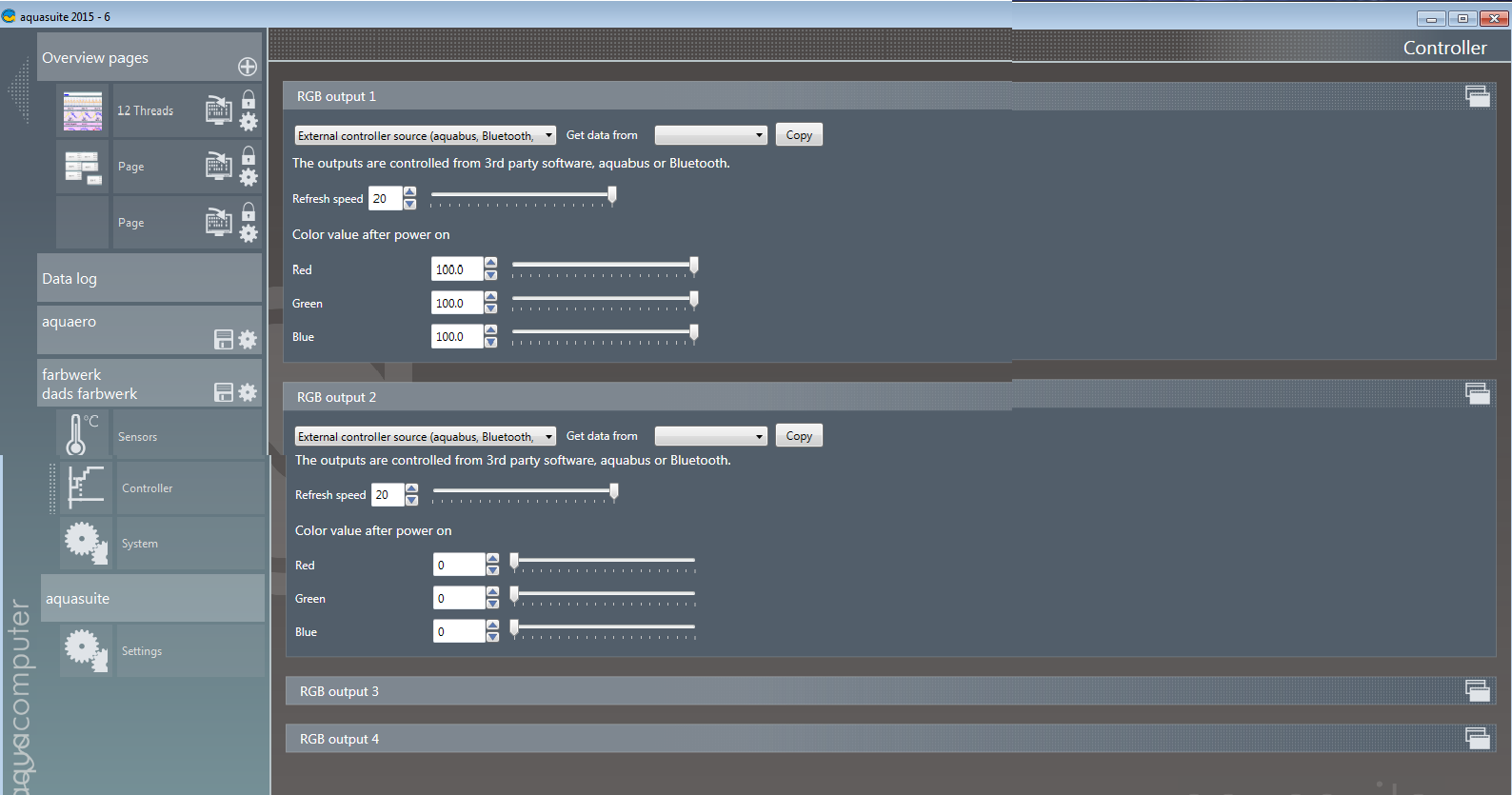

Give me a screenshot of your farbwerk config and the relevant configuration of the aquaero.
barfly
Tuesday, December 29th 2015, 12:28am
railgun
I have both usb and high aquabus connected
i went in the farbwerk and set up my led curve
i then changed the farbwerk 3rd up aquabus/bluetooth
i then went to aquasuite and set sensor 8 in the aquasuite as the trigger and checked output to farbwerk
as soon as i click the output to farbwerk,the leds go out and no load change
let me know if more info is needed

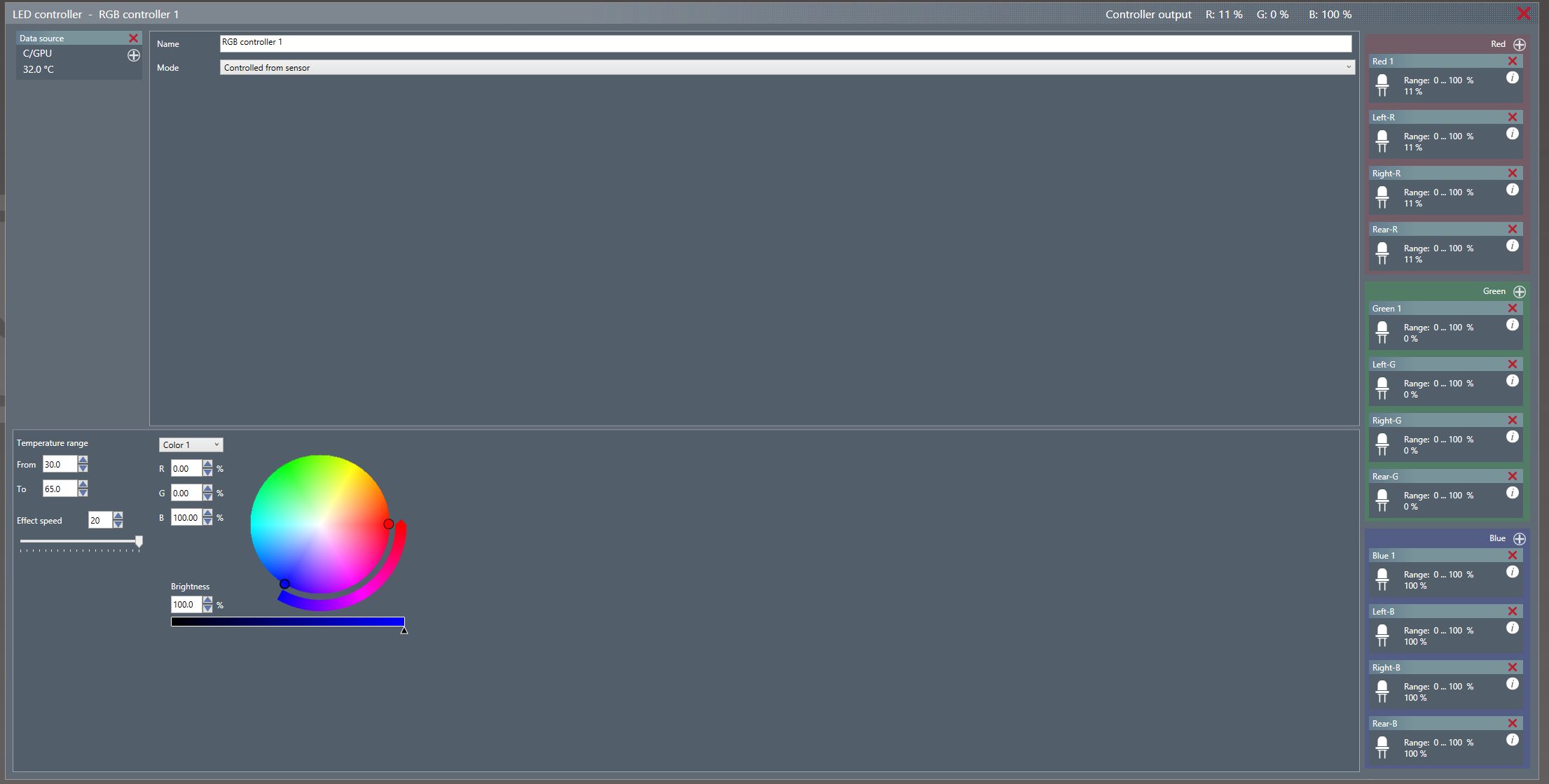

Railgun
Tuesday, December 29th 2015, 11:15am
This is the issue you're having...
You're telling the farbwerk to be controlled by an external device
Your telling that external device to send data to the farbwerk
You're essentially doing this... >-< ...that's not going to work.
Once you tell the farbwerk to be controlled externally, your LED controller within the Aquaero will have what you need. I think you're trying to have the farbwerk do what the aquaero can do.

barfly
Tuesday, December 29th 2015, 5:54pm
railgun,makes sense but im sure iv'e tried every possibility,ill check again later
so once i change the farbwerk to be controlled by an external device i should be able to make changes to the led curve in the a6?,,as i dont see in my a6 what you've shown in your pic.
This post has been edited 1 times, last edit by "barfly" (Dec 29th 2015, 5:56pm)

Make sure you select Use outputs from this device
Then, back in the LED section for the controllers, when you add them off the right side, they should be there. In my case, I named them Right, Left, etc, simply to tell me what's what. Then you control them in a similar fashion as you would within the farbwerk itself. The only issue is fast moving color changes are not smooth. I've mentioned this in a previous thread some time ago. Else, for what you're probably doing, it's fine.

Railgun
Thursday, December 31st 2015, 4:50pm
What version are you using? Because...
Top is the controller for the farbwerk, bottom is the built in LED...
GTXJackBauer
Thursday, December 31st 2015, 5:13pm
That's exactly what mine looks like. I use Aquasuite 2015-9. I have a feeling the OP might have a older version.
