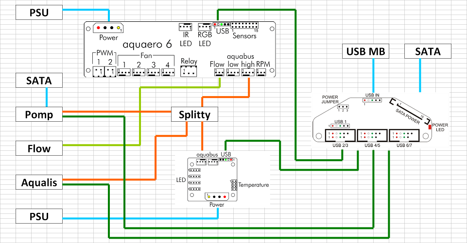

Friday, July 22nd 2016, 1:43pm
Hi All!
Just to be absolutely sure on how I connect it all, here's a pic.
Can someone confirm this is correct?
Men may control the free world, but women control the boobs. Brent in Player vs. Player
Friday, July 22nd 2016, 4:07pm
It is OK.
