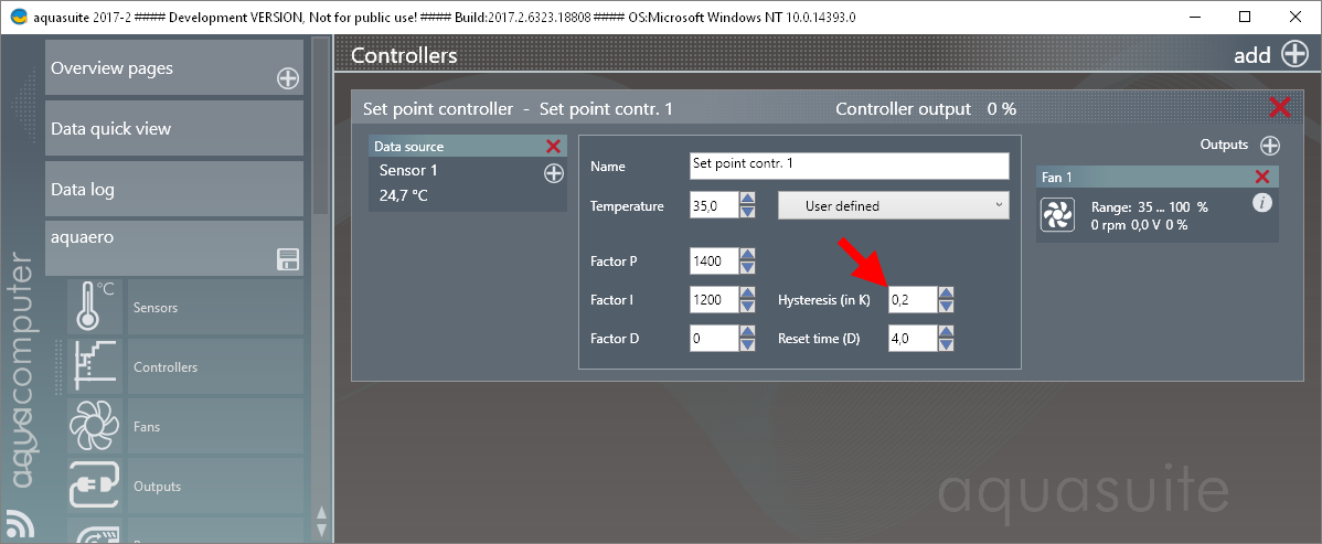

In a very old version of Aquasuite, you seemed having integrated an hysteresis feature (very useful for not having our fans running and stopping each time temperature goes through a threshold value during colding and re-heating). In Aquasuite 2017, I haven't get this one. Do you have an example to get it ? Thanks.

Thursday, September 14th 2017, 4:53pm
Its still there and part of the set point controller if we are talking about the aquaero:
Kyle XY
Saturday, September 16th 2017, 10:53pm
Perfect, Shoggy, many thanks. I was still on curve controllers and I didn't see the other features. :rolleyes:
So, it's time for me to work on the best PID values.
