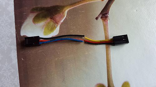

I created my own Aquabus / RPM signal cable. Used 2 old 3 pin female cables and soldered them togheter and sleeved them. Made 2 of them, but they don't seem to work?
Does anyone has an idea why they are not working? I reconnected the standard (pretty long) cables and the devices work with my Aquaero.... But not with those 2 hand-made cables :(

My initial thought is an open, or you crossed the wires... can't be much else.
Curious, what are you connecting to the RPM signal port?

This is how I created them:
After soldering them I used some heatshrink to protect the solder-joint
Then I single sleeved the cables.
I have no idea why it's not working.....
They are not for the RPM port, fior the aquabus-port...

Did you megger the cable with an ohm meter after sleeving to confirm continuity between the two plugs?
Thursday, December 29th 2016, 7:12am
your cables are reversed! Compare the pin numbers on each side of the cable.

What device were you using to connect them too since some devices need a 4-pin for power.
Using a PowerAdjust 2 Ultra and a Farbwerk. They work with the standard 3pin cables....
No I didn't, maybe that's what I could do.....
:S I think you are right :pinch:
Looking at this:
I now see that black and yellow are reversed. :whistling: Stupid me!
I'll try it out this evening Tnx!! :D
