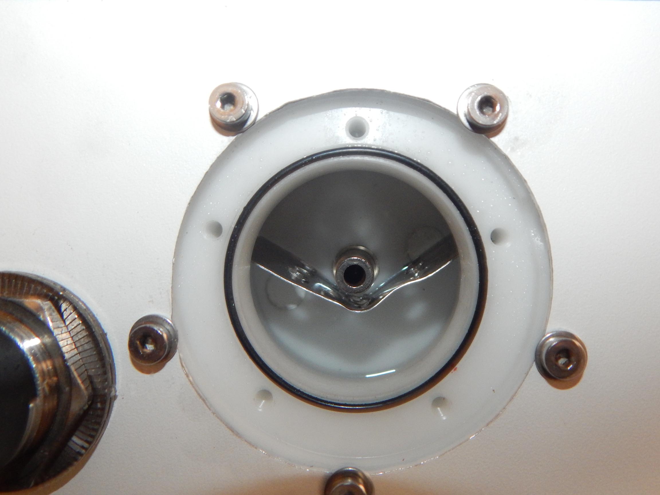

So I removed the scrubber and decided to try a 26 gauge stainless steel perforated plate SSplate.jpg
I know, I know, it looks ugly, but my drill bit was not made for stainless steel, and it dulled quickly and drifted.
Unfortunately, I still saw aeration in the coolant stream.

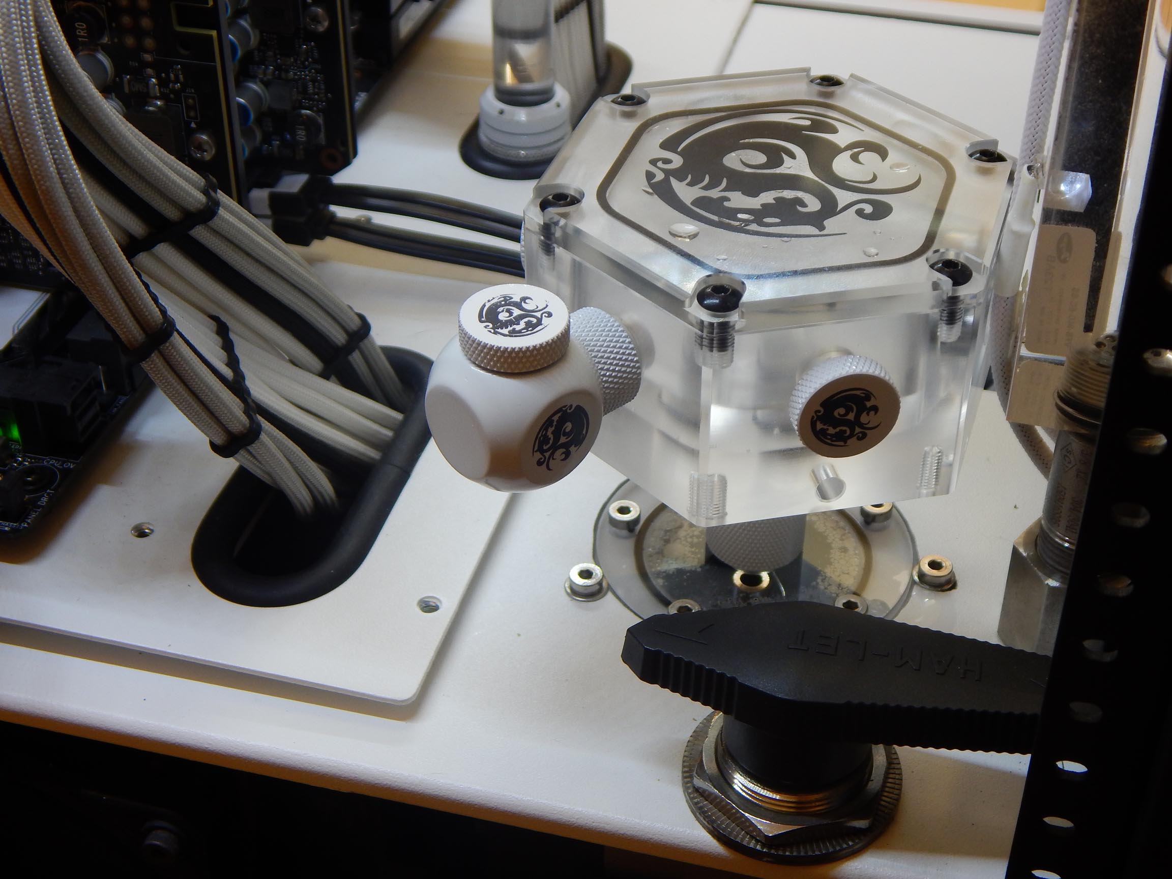

I then decided to add head pressure by extending the water column.
I left the perforated plate in believing it did no harm, and it will attenuate vortexing.
I drilled/tapped a G1/4 port in the center of the aquatube acrylic top plate, inserted a D-Plug, and added this Hex Tank on top.
The reason for the D-Plug is that space constraints do not allow rotation of the Hex Tank, and it truly simplified installation.
Some may find the hex tank ugly, but I find it unique and as such interesting.
I do have the aquatube Rinsing Device installed, so the discharge into the aquatube is just below the new port in the acrylic plate.
This causes the coolant, and any air in the stream, to be pressed into the hex tank.

The HexRes is unique and as such interesting, but it has two other properties I learned to dislike over time:
1. it is gaudy to the point where it distracts from the minimalist build I wanted
2. it is butt-ugly
