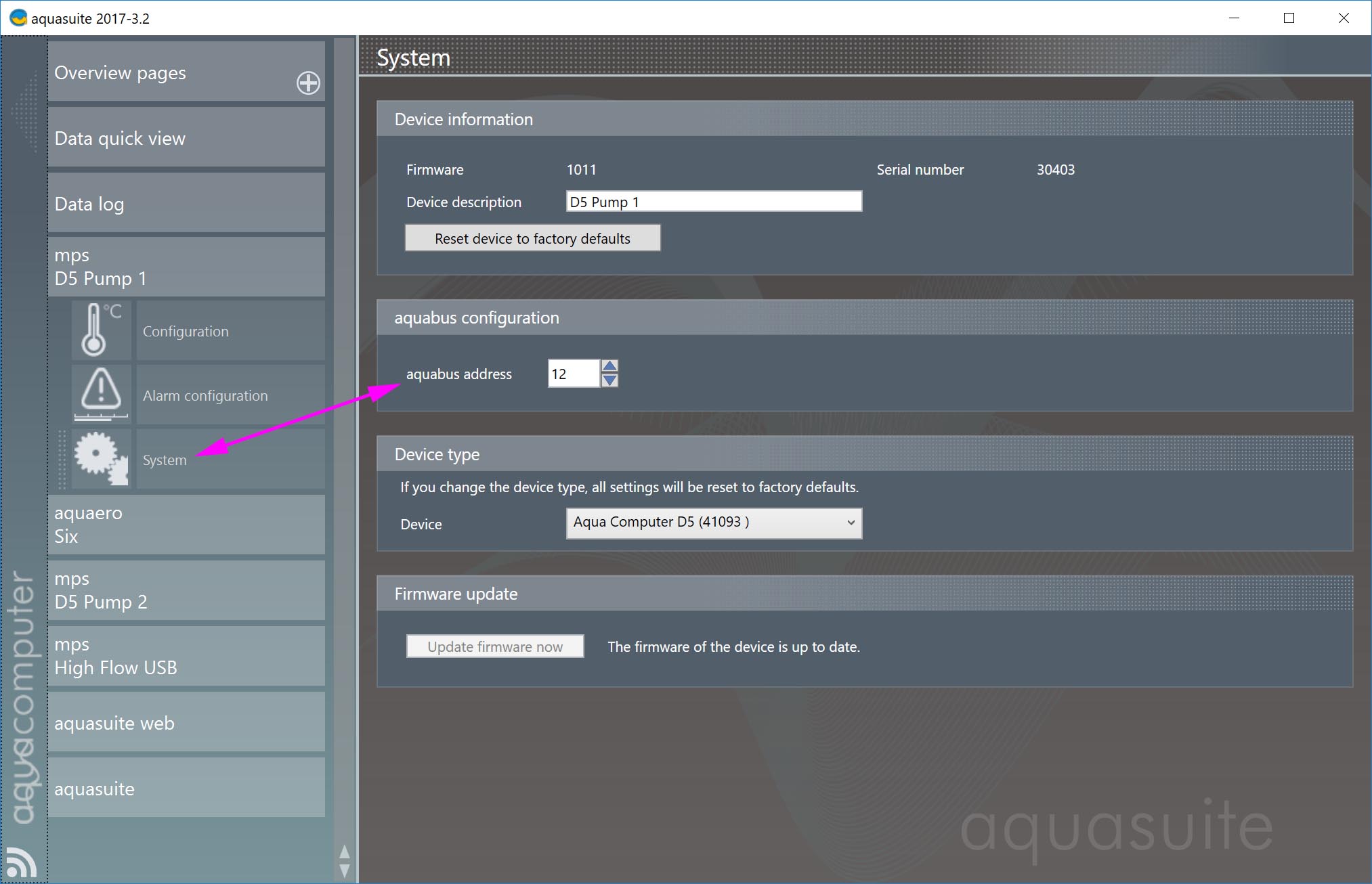

I have three aquabus device (D5, mps 200,mps100),the aq6 pro only one aquabus connector , how to connect my three device to AQ6 with aquabus?
thx. :(
Saturday, January 6th 2018, 5:40am
Buy or make two of THESE, and daisy chain them.
Or, if you are making them, you can make one that splits three ways.
Be sure the aquabus address under the System tab for each MPS device is unique (12, 13, 14 or 15). abusadress.jpg
