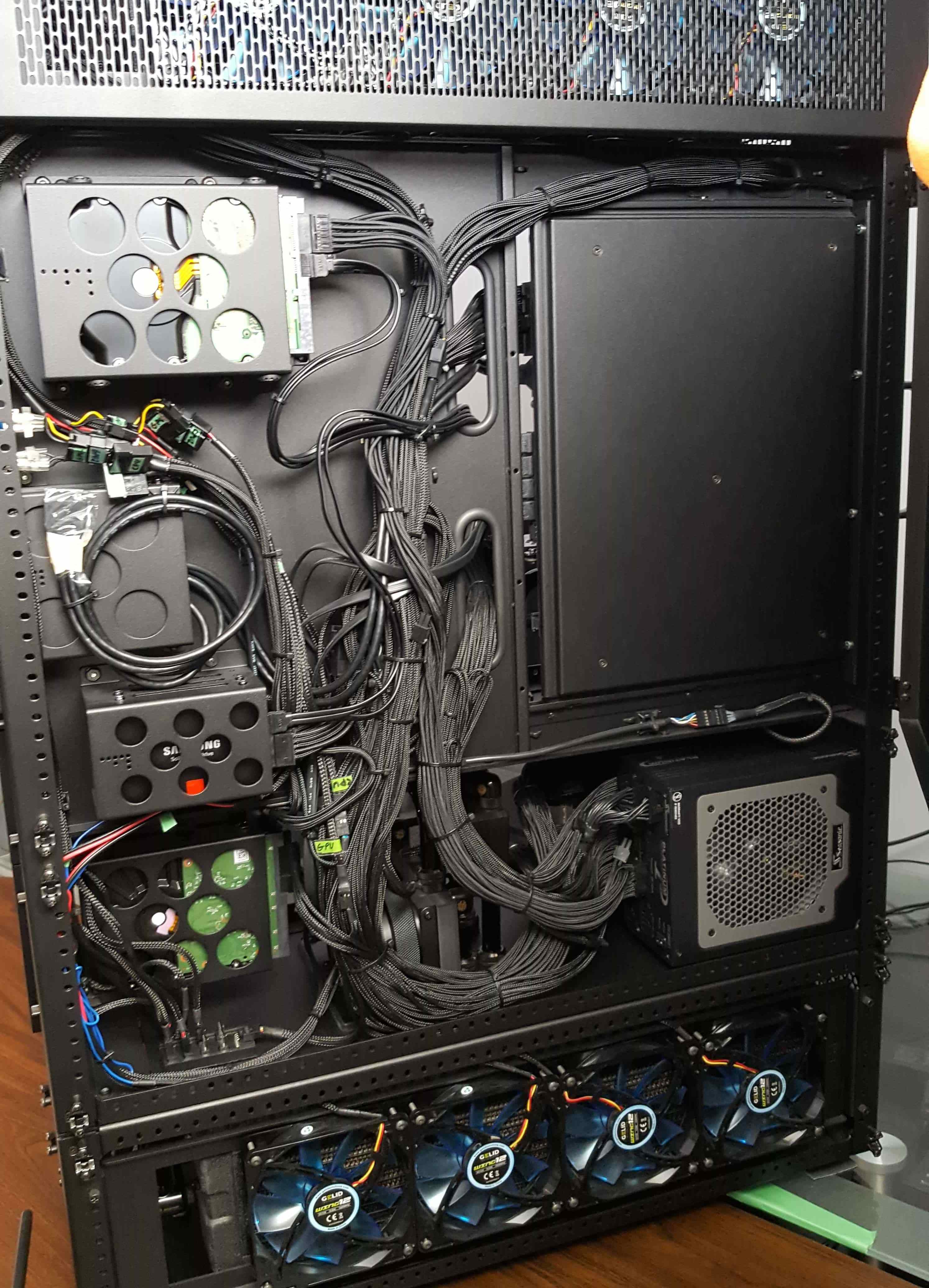

Dundys
Friday, March 30th 2018, 10:00pm
All 7 PA3 Ultra registered in aquabus without single glitch. My system is up and running again.
That's what happens when you either rush through things or not paying full attention, stupid mistake, lesson learn :whistling: :)
Dundys has attached the following file:
  • 20180330_153540.jpg (619.9 kB - 363 times downloaded - Last download: Oct 29th 2026, 10:49am)
This post has been edited 2 times, last edit by "Dundys" (Mar 30th 2018, 10:09pm)

Dundys
Friday, April 6th 2018, 6:36pm
One positive thing came out of this, I want to clean up my cables so I did a bit it might not look much but there is ton of hidden wires now, despite what it shows :P
Dundys has attached the following files:
