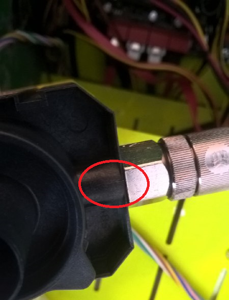

No, as i said the crack is where the inlet tube attaches, towards the "outside" of the pump. Picture attached.
The crach is very thin and tight, so thin and tight i cannot be sure to have properly cleaned it, but not thin enough to ignore it, since after some time running there was a liquid drop outside.

OK, in this area you can only try to glue it. Otherwise you would need a new naked pump without the controller board (can be taken from the current pump).

no need for a specific way to clean eventual greasy liquid leftovers in the crack?
Tuesday, July 10th 2018, 10:00am
You could clean the crack with some Isopropanol. I would apply some of the adhesive directly to the thread of the adapter and afterwards you can work on the crack itself. Put the pump into an oven afterwards. Let it stay there for about 30-60 minutes at about 45°C. This allows the adhesive to settle perfectly in the crack.
