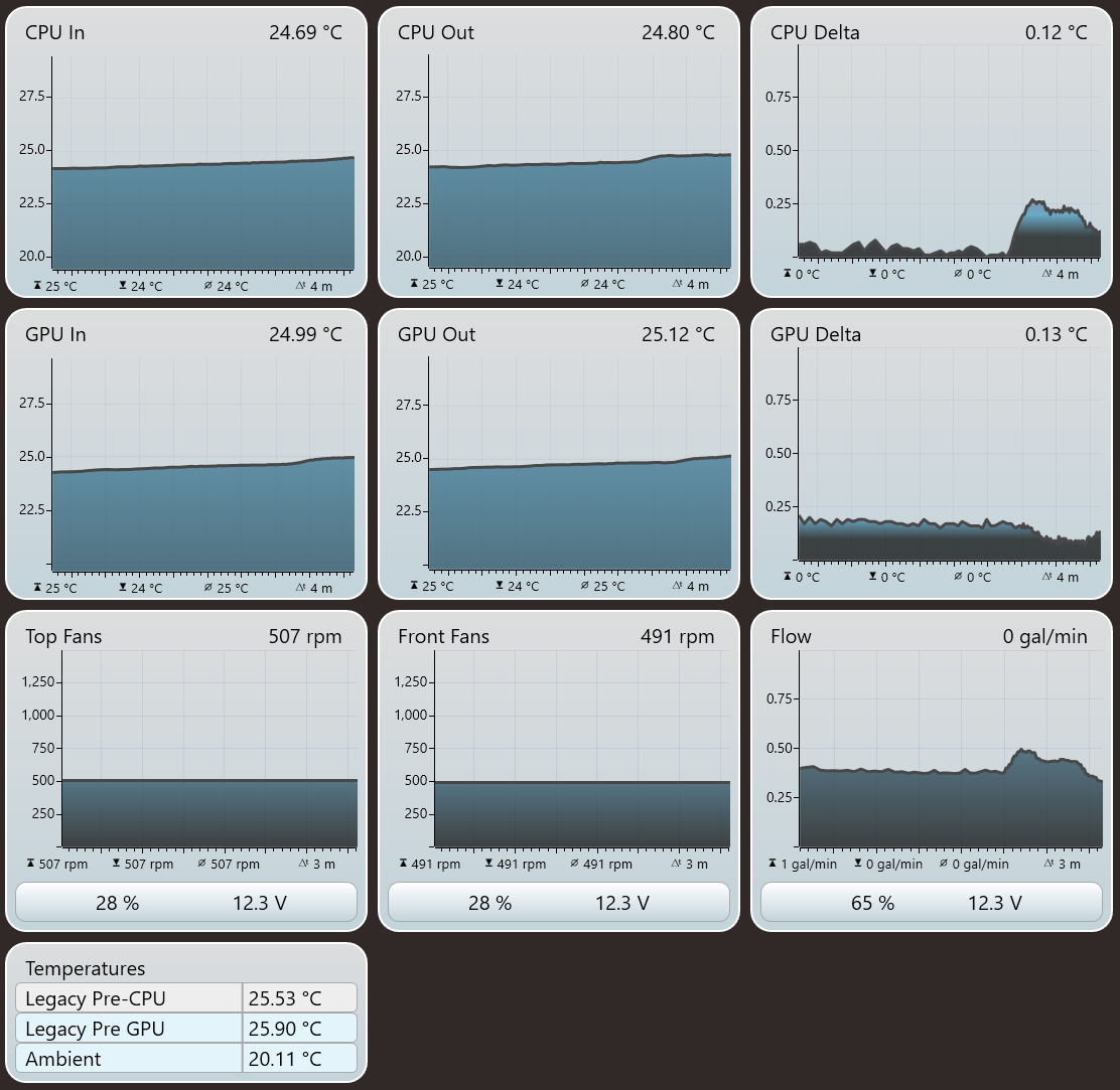

You can see some evidence of it in action with a "curve controller" here:
As can be seen, as the CPU load increases slightly, this causes the CPU delta to increase, resulting in a small increase to the flow.
