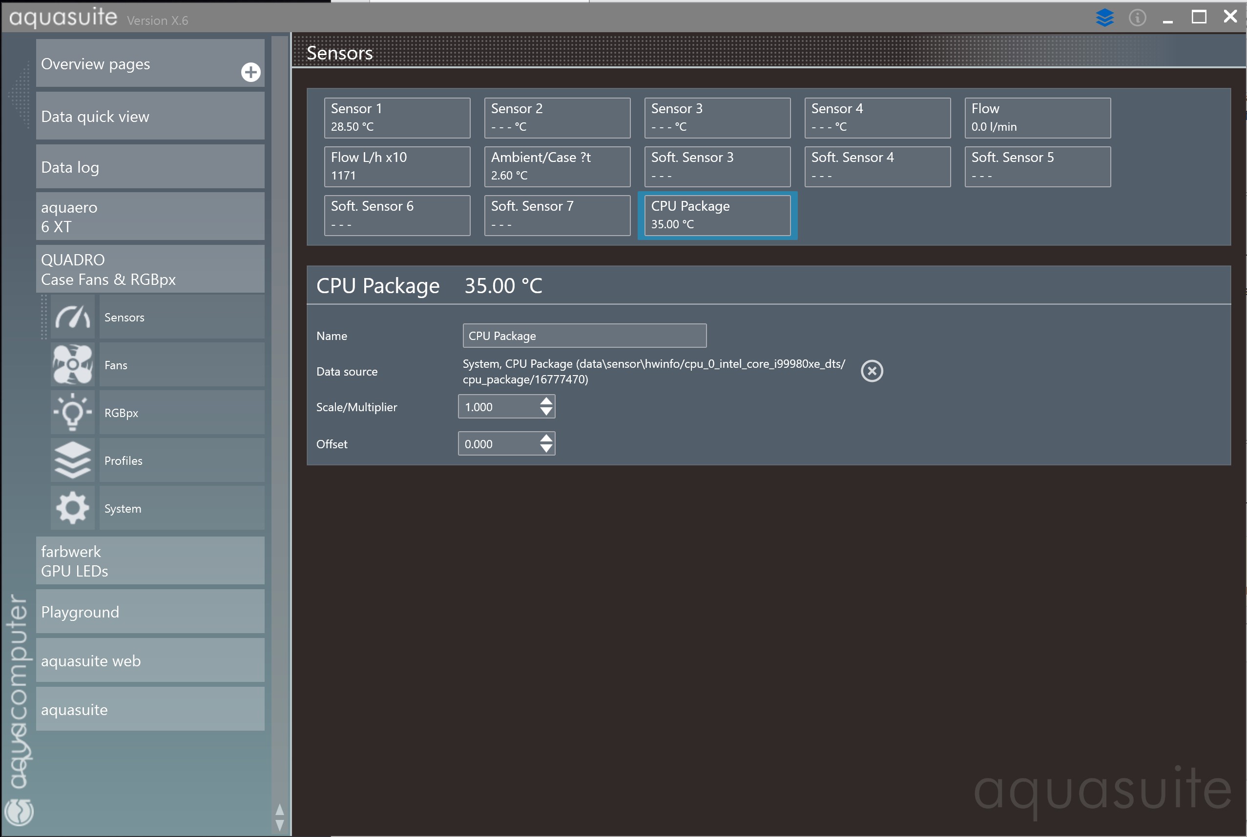

Easiest is to run HWiNFO
The example below is only valid if the USB connection is made without the aquabus connection.
In aquasuite, under the quadro/sensors tab, select a software sensor (8 in the example below) and click on the + icon
Then select Data from Aqua Computer Service/HWiNFO/and navigate down to the CPU temp sensor
It should look something like this
Then go to the aquasuite/fans tabs, select the fan port (1-4) you want to control with this sensor, and set it up
I used an existing fan controller for the screenshot, so the source shows Ambient/Case Δt (I guess quadro has same upper character issue as aquaero)

How do you forward the cpu temp to the quadro? Is there a set speed that can be applied if out of windows? Thanks.
[attach]7053[/attach]
[attach]7054[/attach]
[attach]7055[/attach]
[attach]7056[/attach]
As to what happens without Windows, what I experience at system start, before all values are set, the quadro goes to 100% on the fans, and then falls back when actual values come into play.
Thanks for the outline. That’s most helpful! Just ordered the quadro yesterday. Appreciate your kind help!

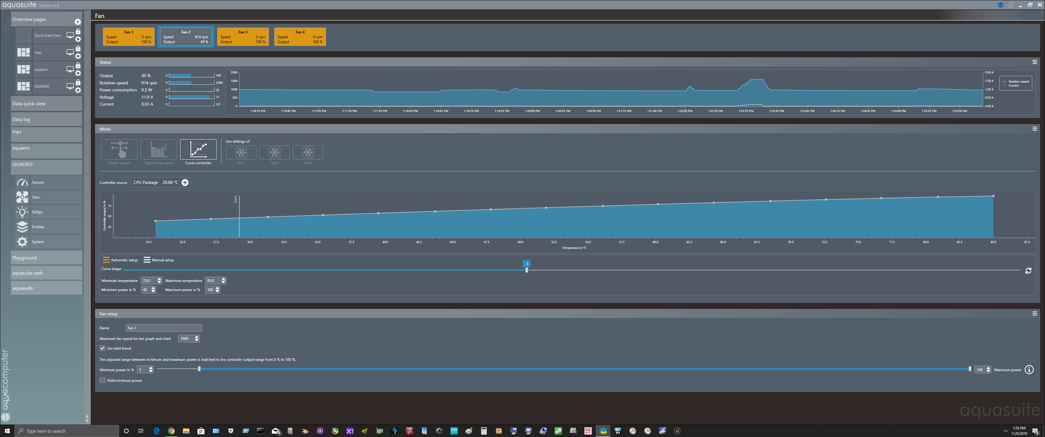

This seems to be working better than the AISuite 3 with the Asus motherboard. Thanks for all the help. I wish it would work outside windows, but the HWinfo program must be running. I had the change several settings if HWinfo so it would start on windows boot. I noticed my fan curve setting of -3 automatic keeps changing. Have I missed a setting on the Quadro/Fan setting menu? Thanks again!

What do you mean your controller curve keeps changing?
Hopper64
Saturday, November 9th 2019, 5:38am
When I go back to the fan settings in quadro, the automatic fan setting curve has changed from -3 to 0. I don’t see where to apply my settings, if that’s what I’m missing.
Saturday, November 9th 2019, 7:23am
The curve shape slider is only for inital settings, you curve is the same.
You dont need hwinfo in the most cases, the integrated hardware monitor has also the most sensor values.
In the most cases it make sense to use a progresive fan curve (+10) with a temperature range from > 40 .. max of your allowed controlling range.
And: enable hold minimum power, then your fan is always running.
