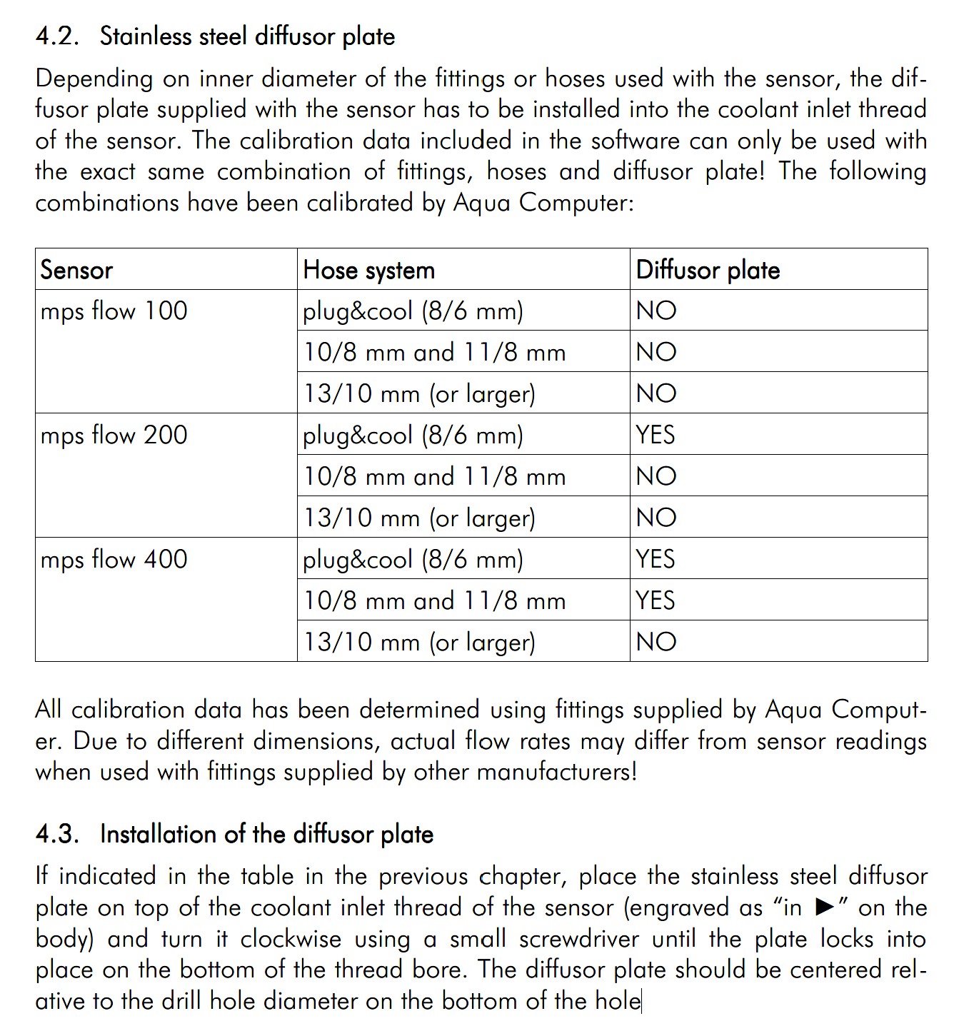

I believe the "Import calibration data" option allows you to import an external file that is used to calibrate the device.
The default, though perhaps not absolutely accurate, is probably sufficient to show change, which is what I would be interested in.
Your hose/fitting size are adjusted for by using the included "Diffuser Plate".
From the manual: diffuser.jpg
From the manual: [attach]7132[/attach]
I guess what I was getting at was when you initially setup the flow meter you can pick the fitting size etc etc. After removing the flow meter and powering off the system and then powering back on with it still removed and then removing it from the software. Powering down then connecting it back when you open the software the option to configure it does not show up.
