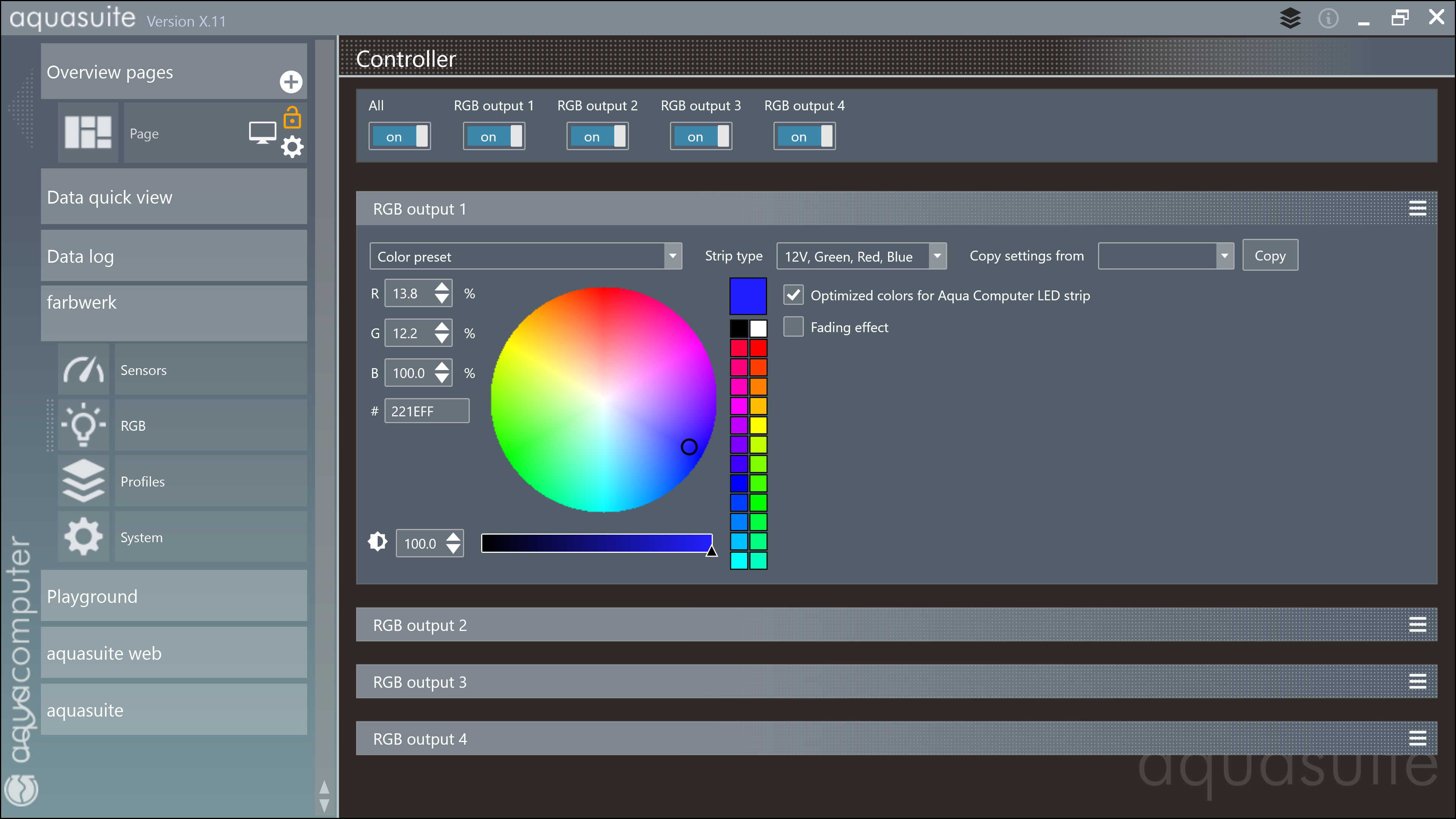

I have one farbwerk with about 20 feet of aquacomp lights---I have another controller on the way
We need to know which devices you have, and some screenshots of the setup tabs so we can see where you are.
apistodave has attached the following image:
This post has been edited 1 times, last edit by "apistodave" (Jan 11th 2020, 7:49pm)
Saturday, January 11th 2020, 8:04pm
The strip is doing what you have programed it to do, show Blue.

ok SO THIS IS CHANNEL 3 WHICH HAS ABOUT 8 FT OF LIGHTS--i HAVE IT ON red but the lights are blue--I'm thinking I have too long a string on this--do you concur?
Maybe I'm wrong here but it could probably be because it's protecting itself if you haven't damaged it yet.
Read this below taken from the site.
Quoted
Comaptible LED strips:
LED strips for 12 V, common anode. Suitable LED strips and connectors are available from Aqua Computer.
Maximum current per channel: 2,5 A
Maximum combined current (all channels): 8 A (resulting in a maximum total power of 96 Watts at 12 Volts)
