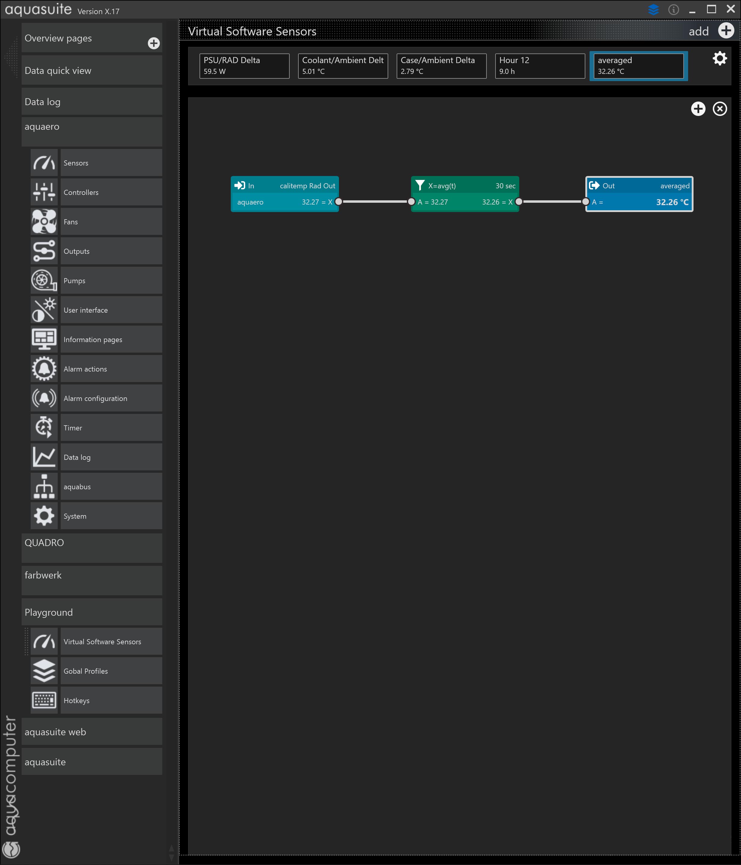

I setup a Virtual Software Sensor in the Playground using a 30 time average to limit some of the constant temp movements, but I am not sure if it is working. I do not see the name I created anywhere outside of Playground.

Here are screenshots. I do not think it is working because temps found in the controller are more like the ones found on the front end of the formula. Also,
is there a way to disable temp sensors not in use so they dont show up on Overview pages?

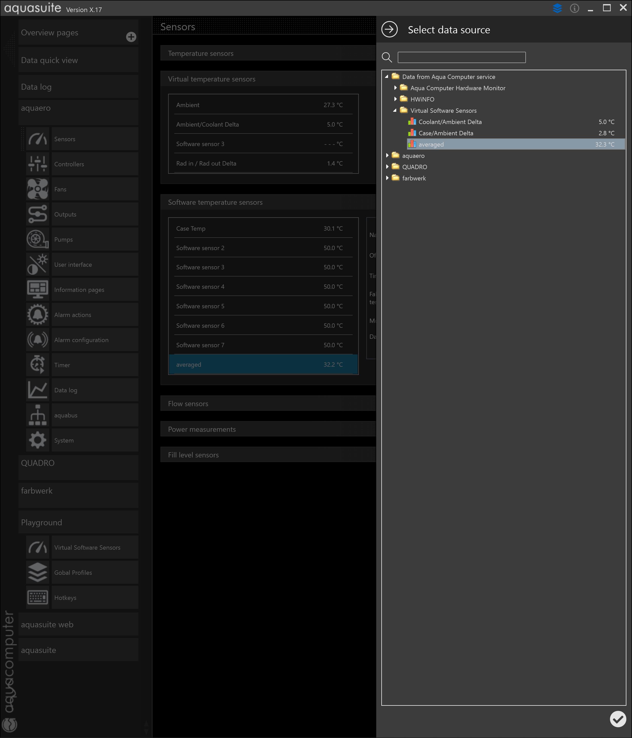

A screenshot showing the list of sources available would be useful. sample: datasource.jpg

Once you have made your Virtual Software Sensor (virtual_software_sensor.jpg)
You need to import it into a Software Sensor under the aquaero > Sensors tab (import_software_sensor.jpg)
Then it will list in your Controller Sources list (controller_list.jpg)
This post has been edited 3 times, last edit by "InfoSeeker" (May 3rd 2020, 4:27pm)
