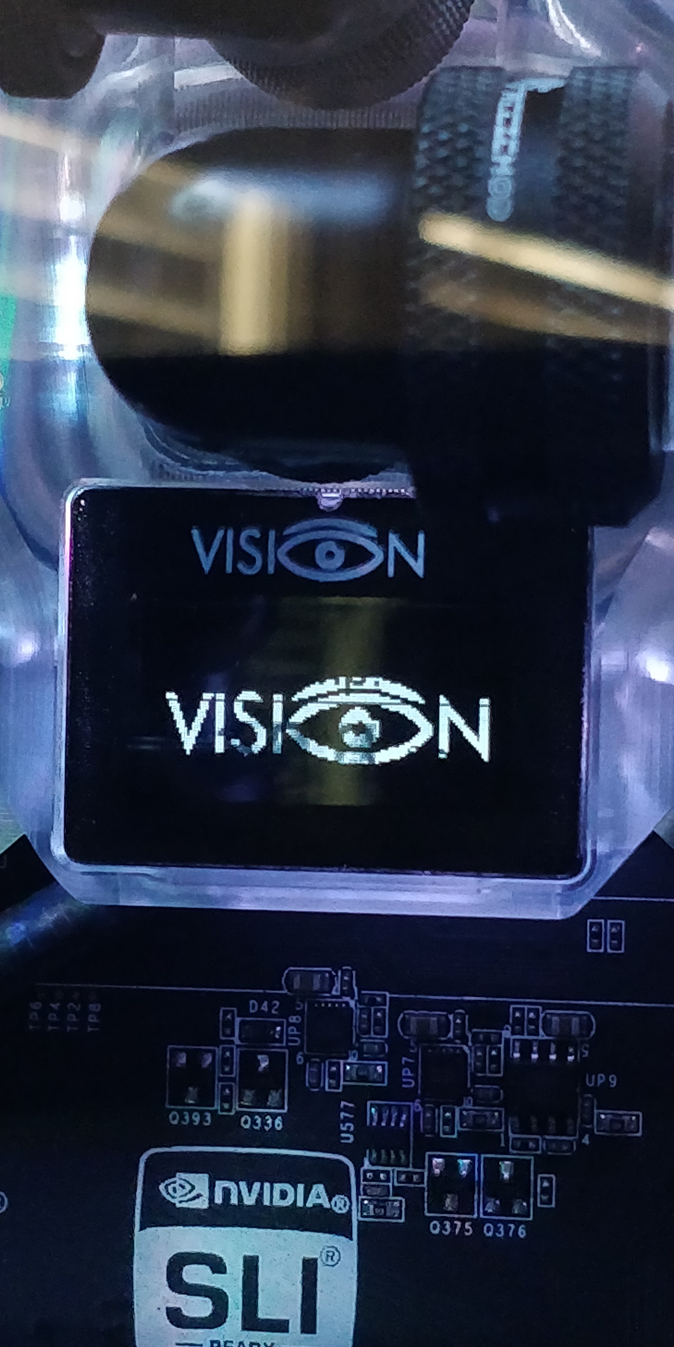

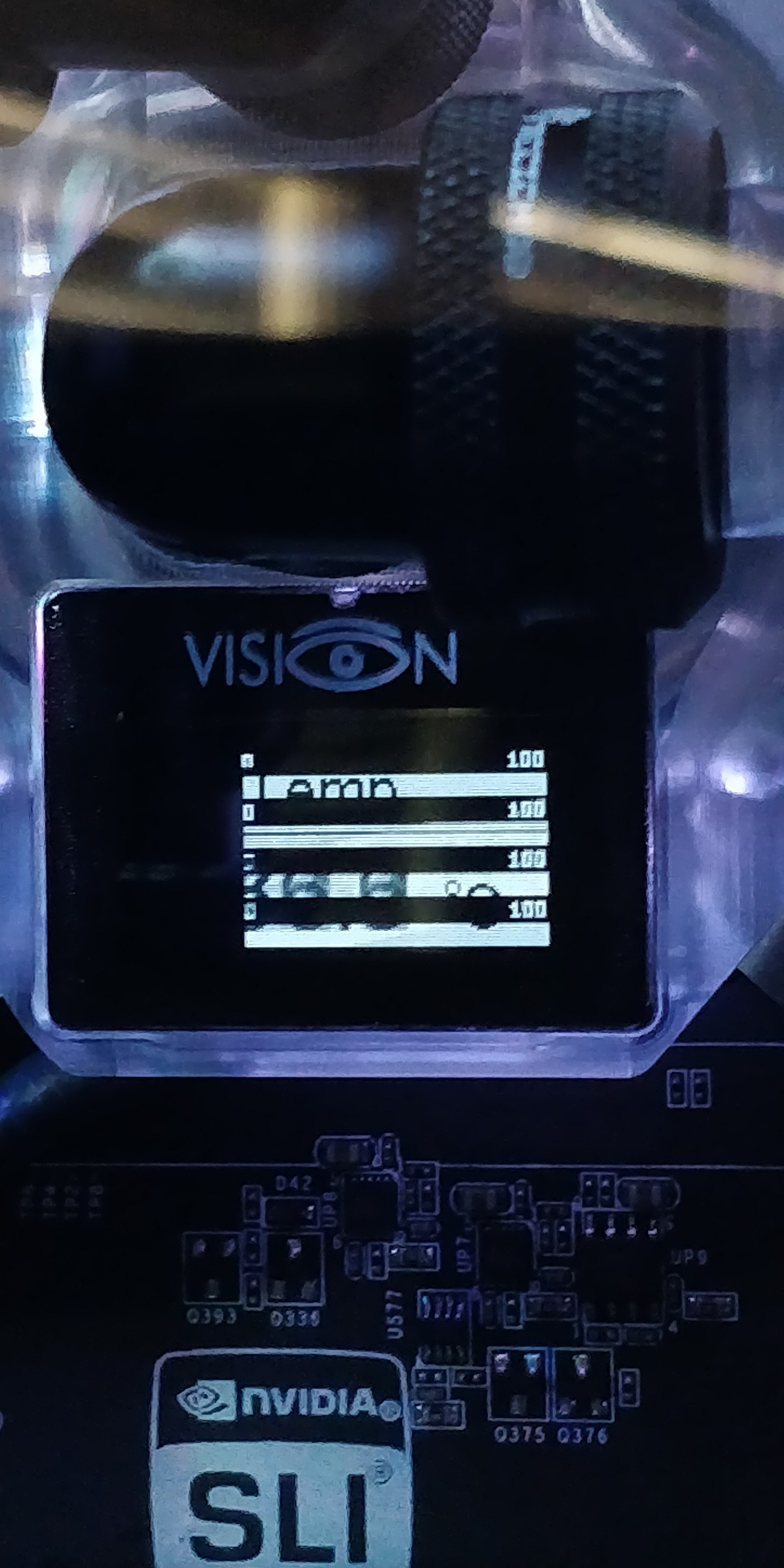

Has anyone experienced any burn-in or localized dimming of the pixels in their VISION LCD screen?
I never noticed it because I always had the temperature displaying on the LCD screen as I have a dedicated flow meter and no other sensors associated with VISION.
See the images below to see what I am talking about.
Should I replace the screen? Warranty?
Thanks

From those photos, it looks like fairly typical image persistence. Just about all LCDs are susceptible to this, but unlike actual burn-in as with CRTs, this is rarely permanent.
Try having the display off for about 48hrs, as the crystals may revert to their natural state.

They are OLED screens, which are more susceptible to permanent image retention than standard LEDs. I would have hoped they'd be more resilient than this on such a tiny screen that's designed to display stats all day, but oh well. I suppose it's to be expected if you only have ONE screen active; I just hope that they last a good while when you have plenty of other screens active.
Things that (I presume) help avoid burn-in:
1) Lower brightness.
2) Black background (non-inverted).
3) More screens.
4) Faster transitions.
This post has been edited 2 times, last edit by "Undesirable" (May 28th 2020, 2:04am)

You could also try running the screen with multiple displays, set to the fastest possible transition. That may help jog the pixels back into line.
If it comes to it, replacement screens are available for about £30, too - https://shop.aquacomputer.de/index.php?cPath=62_4022
