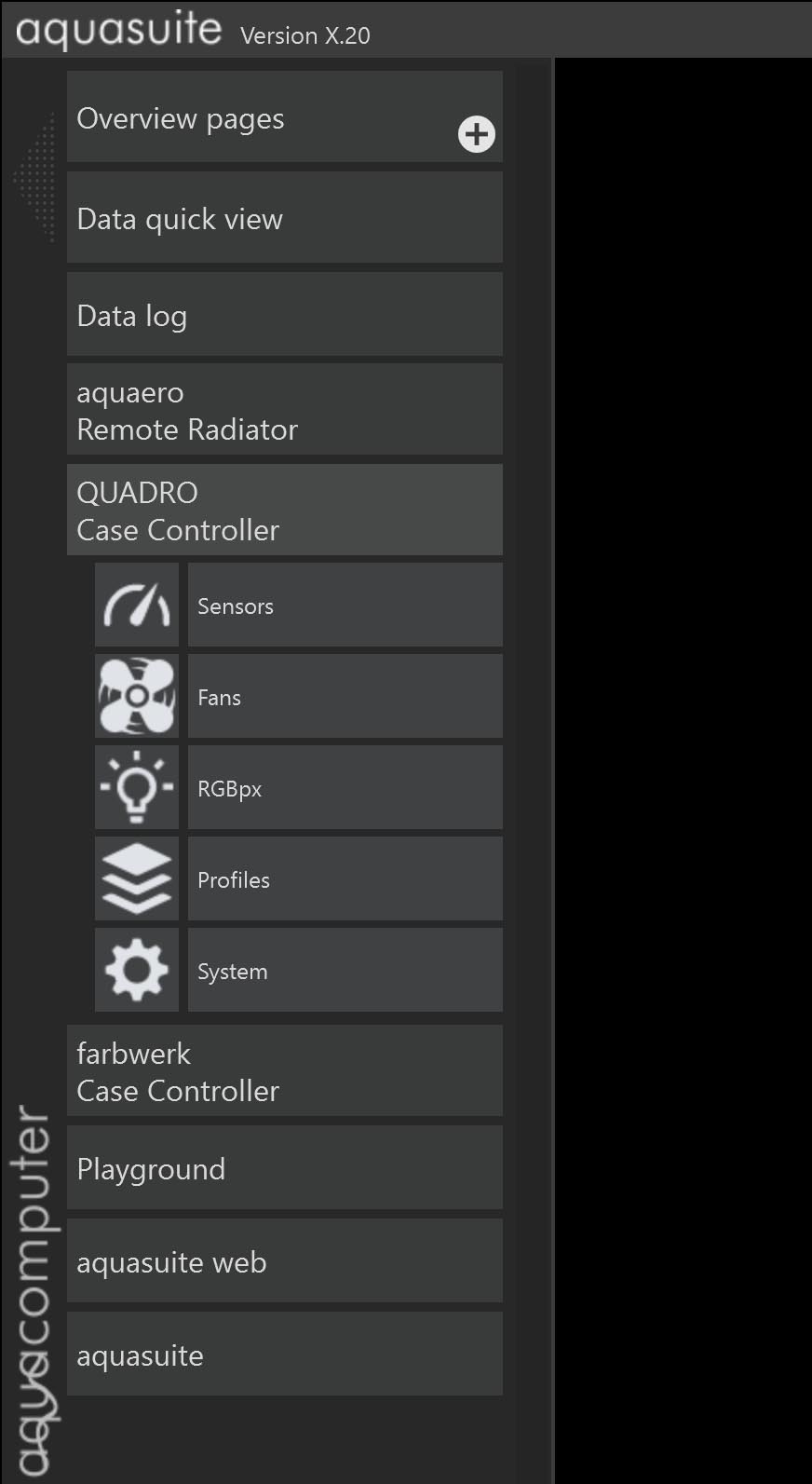

The device should absolutely show up with it's own tab in the aquasuite. If you do not see it, perhaps to check your usb cable/connections. And check to see if it shows in the devices page of your OS.
It looks like the sample attached, except it would say OCTO instead of QUADRO. sample.jpg
