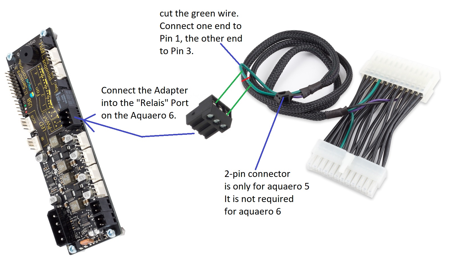

My question is where I can connect that 3-pin connector and how to put 3 wires on it ?
Hufeisen
Tuesday, August 25th 2020, 7:35pm
See the attached Picture.
If you activate the Relais in the Aquasuite software, your Computer will power off. All unsaved data will be lost!
If you want to power on your computer without the aquaero, you need to connect the green wires together.
[attach]7689[/attach]
Thank You! So actually it is replace power button.
So it will get 4 secs to cut the Power. I have all hardware and soon Software for that and just asking for tricky settings.

In my opinion, it is easier and safer to use a shutdown command via usb. A hard shutdown is only necessary if the system has hung up completely and then you have other problems.
PS:
Quoted
No, this is the power on line, as long as it is connected to ground, the Power supply is on. You connect the relay as opener in series.
If you want to use the power button you have to connect the relay parallel to it as closer.
PS:
Quoted
If you want to use the power button you have to connect the relay parallel to in as closer.
I want to put that PC at work for 24/7 and nobody there so that feature should be ok for such things. If I have remotely status of Aquero from my phone should be perfect.
I have one very strange problem. So I cut the green wire and put it at 2 sides of 3-pin connector after that connect it to aquero 6.
The result is when I press power button on my case power on-off for a milliseconds a many times like short circuit .
Do you know what is wrong there ?
