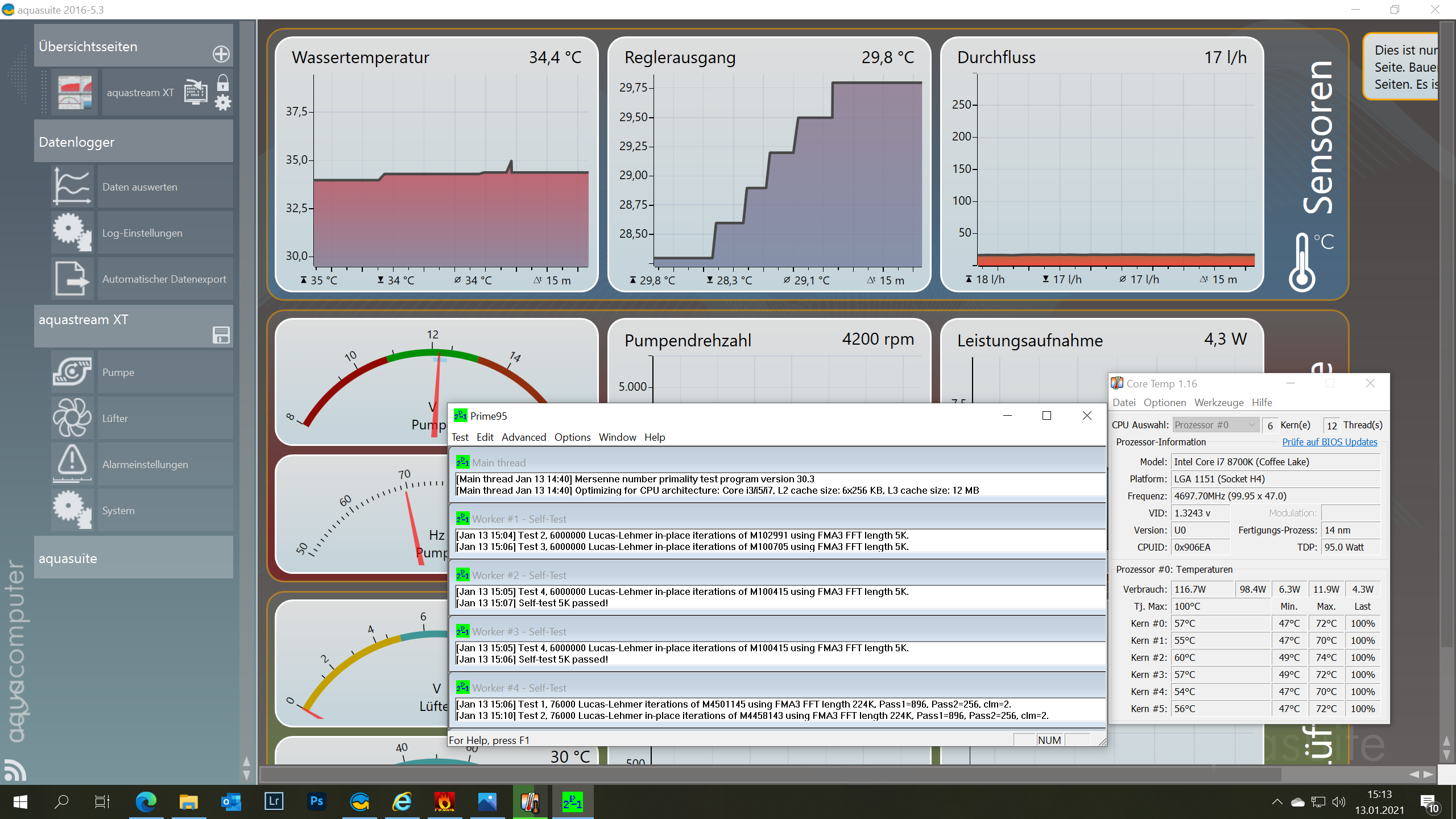

Kurt Krampmeier
bilder
Wednesday, January 13th 2021, 3:44pm
prime
furmark
This post has been edited 2 times, last edit by "Kurt Krampmeier" (Jan 13th 2021, 3:51pm)
