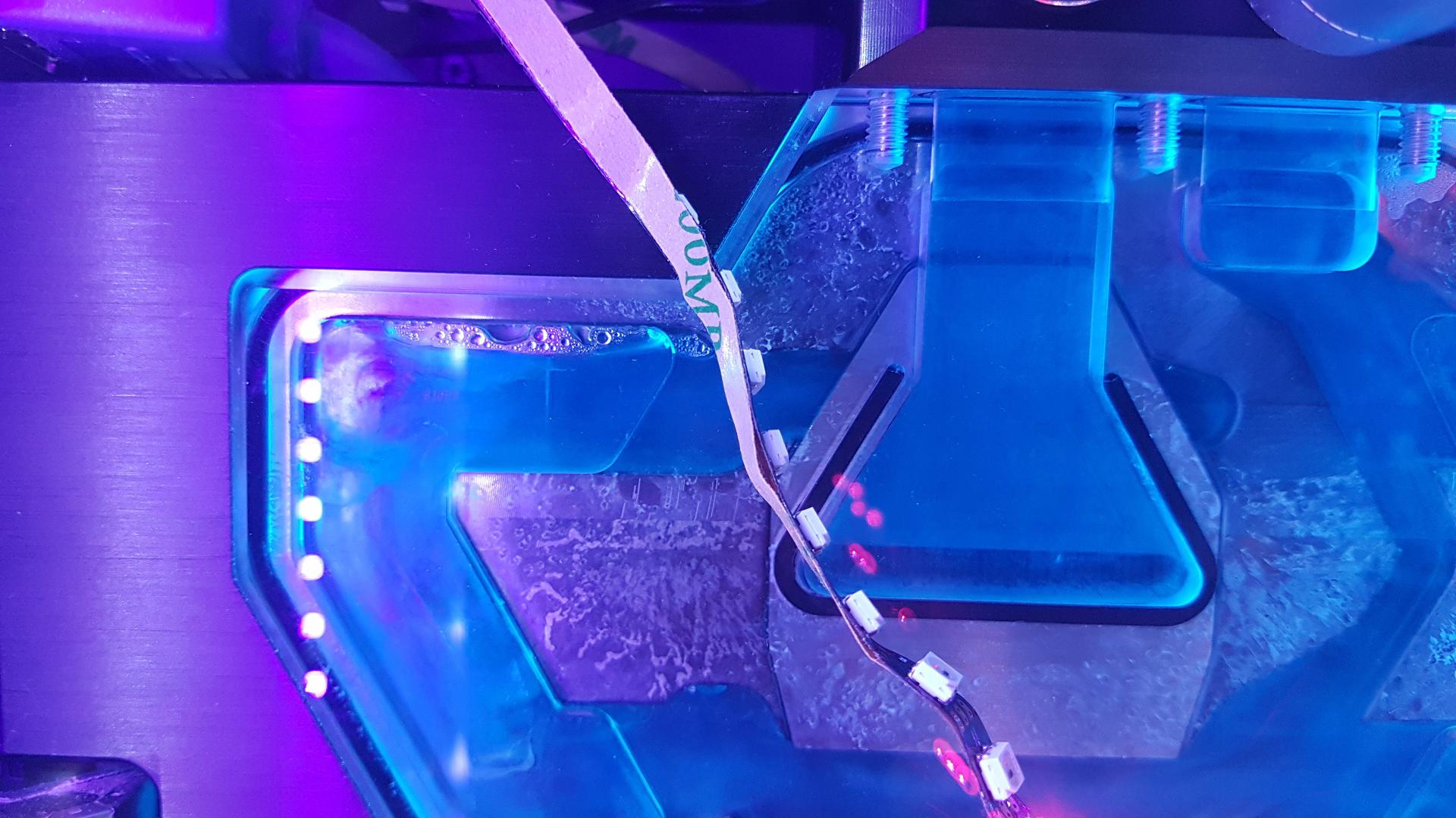

I have a strange behaviour. When the GPU is heating due to load (standard game), the pressure drops then the LS has to run frequently. See the attached screenshot. That phenomenon is not happening when the CPU us heating the liquid. Water reaches 48-50°C. (since my fan header of the D5 Next doesn't work I can't adjust the fan&pump rpms to the water temp yet)
Moreover, water bubbles can be seen on the GPU WB (mounted vertically) at the top left, while the loop has been drained several times (see photo). It sounds like the waterblock has not been perfectly sealed and when the temperature rises, the oring and/or the mechanical constrains makes the WB less sealed, and only the 'very' low pressure applied by the LS can identify it.
if the operating pressure is set at around 250mbar, that issue doesn't occur. And it seems that, when I hadn't the LS yet, the water was spreading a bit beyond where the PMMA contacts, up to the oring, at the exact same spot.
Has anyone a Leakshield AND a kryographics next WB? and if yes, experienced that kind of pressure drop? Or am I experiencing again a fourth issue with AQ products?

What's weird in your photos, besides a dangling strip :p is the little bubbles we can see on the oring sealing surface towards the bottom left. worth checking if all the screws are correctly tightened around the acrylic face of the waterblock.

good catch about the ones at the bottom left of the pic! everything is pointing to a faulty WB So again a quality issue with AquaComputer products...

you'd have to check the screw tightness :) that's what it looks like to me but if it's just that, it's solved in a couple of seconds.
Usually you can see the contact surface between the acrylic and the squished oring, a dark black surface with no bubbles in between. No need to tighten hard. As long as the acrylic is touching the copper block, the oring will be pressed enough

That big bubble, plus your 25° temp differential = maybe low flow.
