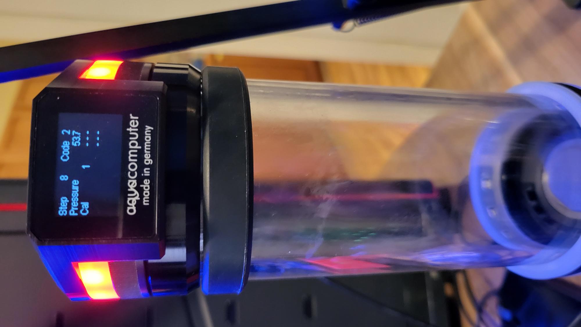

Hello,
I'm having the following issues with the Leakshield:
When starting it seems like it wants to do a pressure test and then goes to ~130mbar and then drops to 54 or so. It maintains 54ish and then steadily starts climbing. (See Picture)
Aquasuite says: "Factory test with 50 ML test body".
I am simply trying to leak test the Ultitube/Leakshield/D5 Next itself to double check everything, and this is what I'm seeing. I had it hooked up to a radiator previously and I'm getting the same results.
Thanks.

I have yes, I don't have the pump connected or anything since it's just a leak test though. I updated the firmware and reset to factory defaults also.

Well I made it further. I don't know what it wants. It seems to be calibrating, but I have no idea what it is calibrating
Edit Help would be much appreciated, I'm hoping to be able to get this working without an RMA.

What happens when you set the LEAKSHIELD to Shield?
Thursday, November 25th 2021, 9:03am
There went something wrong in the factory. The calibration process was not finished correctly. That can not be fixed by yourself and you will need a replacement device.
Please get in touch with us via e-mail and provide your full postal address and a phone number.
