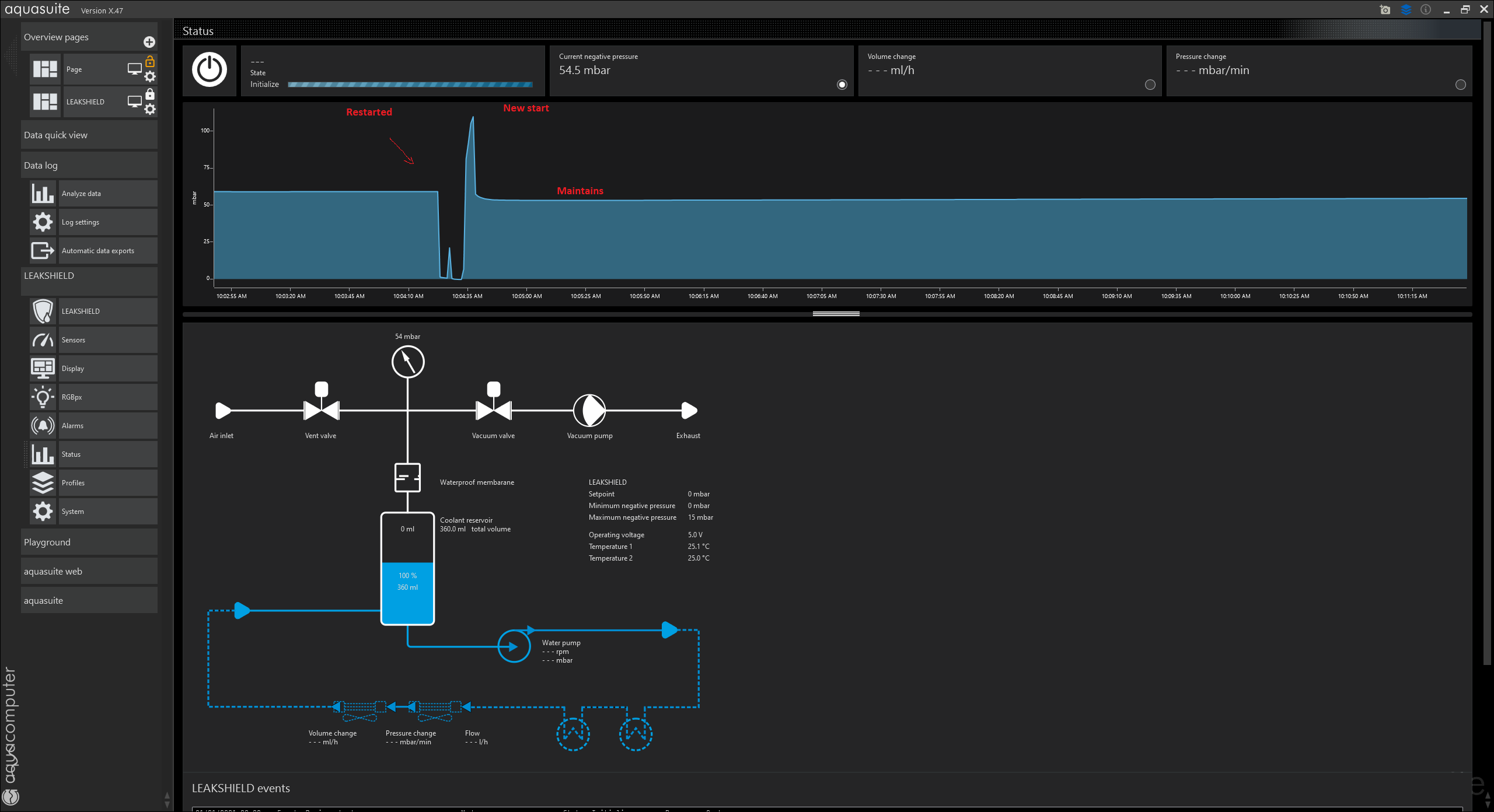

Hello,
I'm having the following issues with the Leakshield:
When starting it seems like it wants to do a pressure test and then goes to ~130mbar and then drops to 54 or so. It maintains 54ish and then steadily starts climbing. (See Picture)
Aquasuite says: "Factory test with 50 ML test body".
I am simply trying to leak test the Ultitube/Leakshield/D5 Next itself to double check everything, and this is what I'm seeing. I had it hooked up to a radiator previously and I'm getting the same results.
Thanks.

I have yes, I don't have the pump connected or anything since it's just a leak test though. I updated the firmware and reset to factory defaults also.
Praetorian
Wednesday, November 24th 2021, 9:23pm
Well I made it further. I don't know what it wants. It seems to be calibrating, but I have no idea what it is calibrating
Edit Help would be much appreciated, I'm hoping to be able to get this working without an RMA.

Thursday, November 25th 2021, 7:34am
What happens when you set the LEAKSHIELD to Shield?
Thursday, November 25th 2021, 9:03am
There went something wrong in the factory. The calibration process was not finished correctly. That can not be fixed by yourself and you will need a replacement device.
Please get in touch with us via e-mail and provide your full postal address and a phone number.
