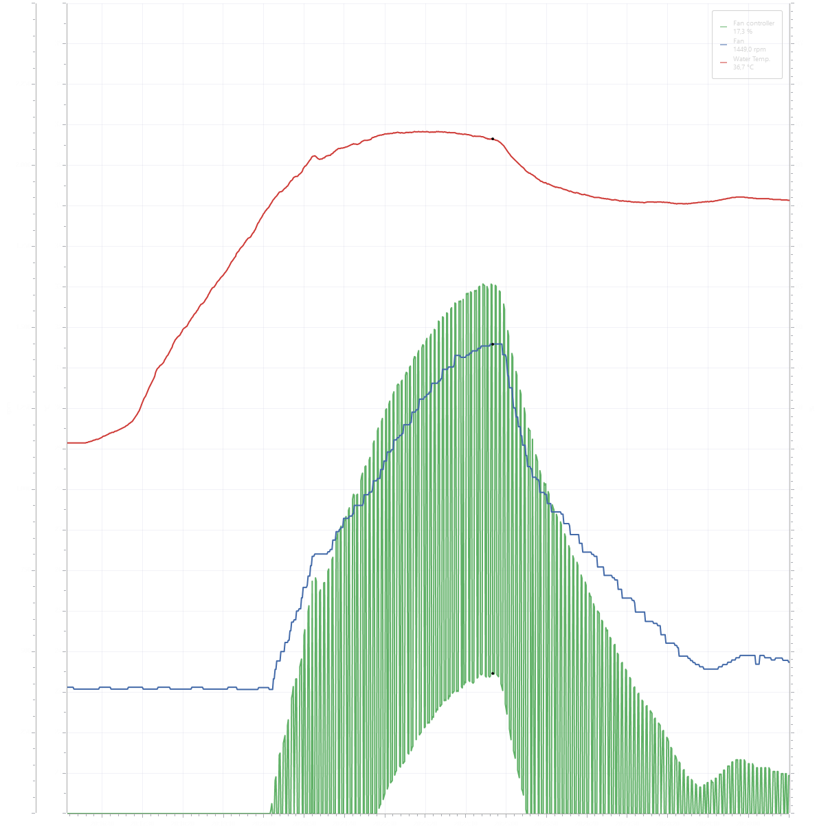

My step response results:
Process Gain: 0,6 (0,6xxxxx, precise number is in my calculations)
Tau (63,2% of the total step response change): 336 seconds
Delay time: 4 seconds
Edit:
Fan controller change (MV): 15-90%
Temperature change: (PV): 9,7 degrees (35,34 to 25ish)

RBMDragon
Friday, March 4th 2022, 8:53pm
Changed the variable factor by 100.
The reponse is not as agressive or fast, but it seems to handle a Heaven Benchmark.
Step Response 90 is the data I recorded for the PID value calculation.
PIDLoopSimulator was used to estimate a controller reponse, although the loop is still much slower.
I used the guides from Engineers-Excel.
The gain was the factor between the change/full range, i.e. 1.
The 336 seconds is the time it takes for the temperature change starting to 63,2% of the final value.
The delay is the time it takes from the 15%-90% step change to notice a temperature change in the temperature.
PIDValues are the factors I inserted.
Setting Integral and Derivative to 0.
Set the Controller Gain until the simulator oscillates (not getting stronger or weaker).
Set the Controller Gain to half that value.
Set the Integral value until the Process value gets as close to 1 (I took the value at 100 seconds)
Set the Derivative value to reduce overshoot (second sheet take maximum value from the Process values)
PIDControl is the controller in action while running Heaven Benchmark on the GPU.
There are still some things I might do better, but for now I'm starting to get progress.

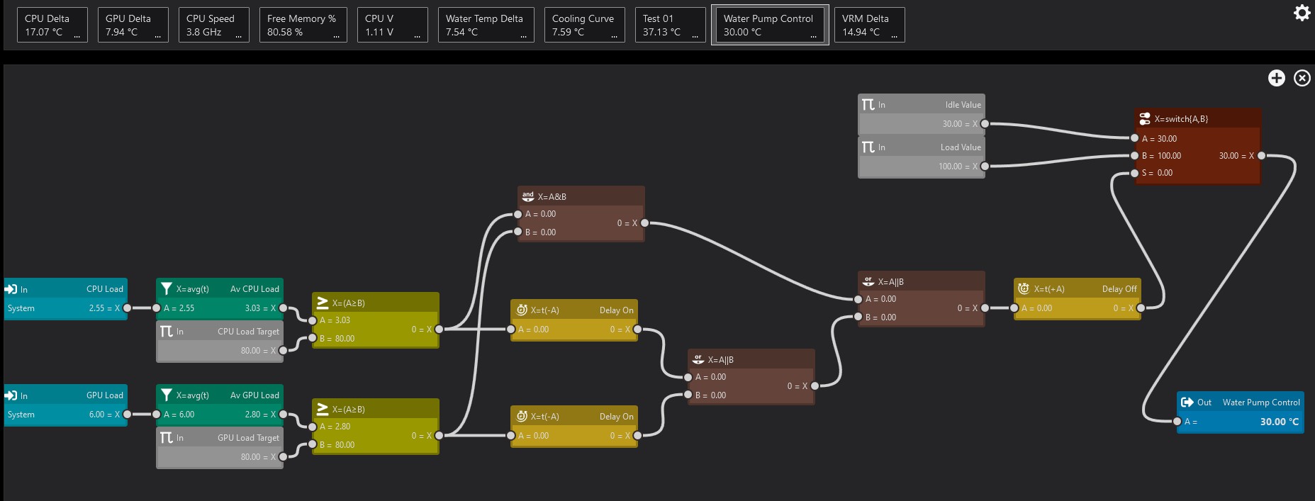

WinstonWoof
Sunday, March 6th 2022, 8:48am
I approached things a slightly different way using virtual sensors.
For my Water Pump Control I have a Virtual Sensor configures so that it outputs one of two values dependent on load & time.
The lower value is the default and runs the pump at just under 3k rpm.(based on its very simple fan curve with no tweaks)
The higher value runs the pump at its max speed of ~ 4.5k rpm
The Higher speed is triggered
IF either Average CPU/GPU load as measured over 15 seconds goes above threshold (80%) And it then stays above this for a further defined period (120 seconds) THEN use High Value.
In this scenario I also have a 60 second delay on shut off(which actually I need to add in for the next scenario as welll now I think about it)
If However the Average of both CPU & GPU go above threshold then High Value is used straight away.

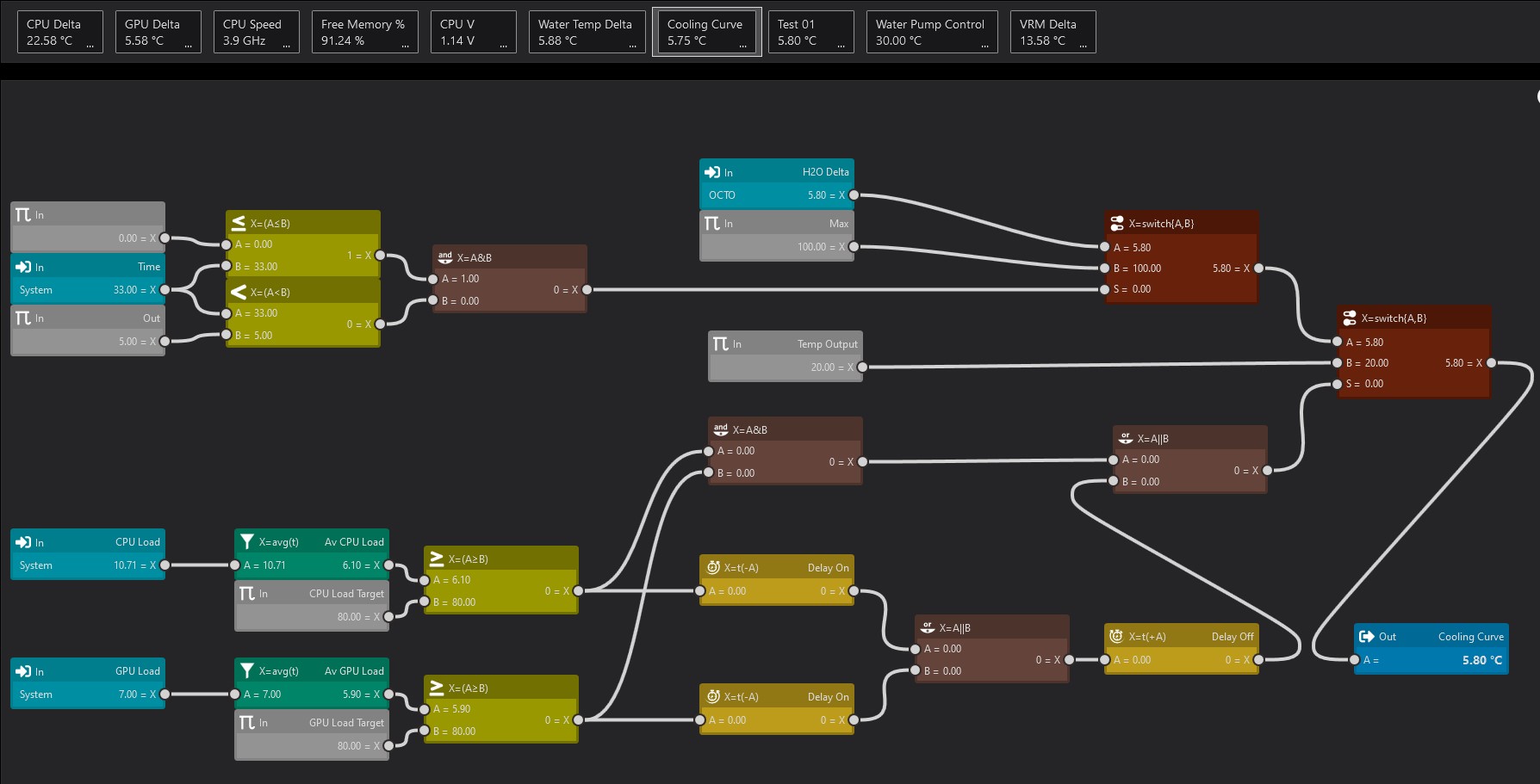

For Fan Control I have something similar but with a twist.
In this case it uses the H2O delta as a Normal value and a first fixed value (Temp Output) as the standard High.
This then runs the Rad Fans & Case fans on their own curves which are configured so that the Rad fans are more sensitive (ie can run from 0-100% )than the case fans which always run at pretty much a fixed speed based on their curve (my rads are mounted externally).
The next added twst is that once an hour for 5 minutes all fans (inlduing case fans) are spun up to 100% by setting a Max value (100) to be used as the output temp.

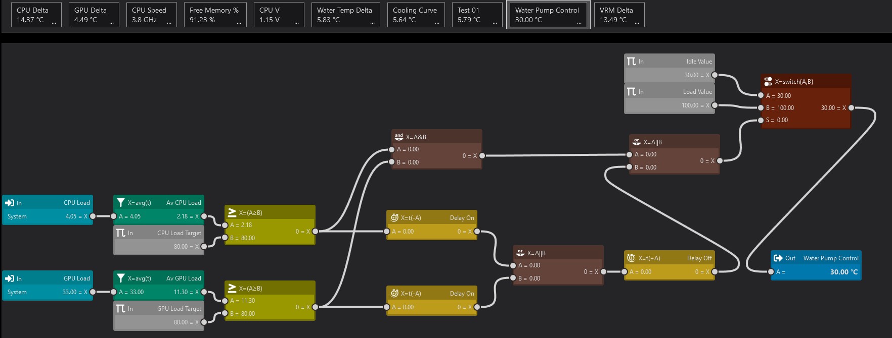

WinstonWoof
Sunday, March 6th 2022, 9:00am
Quickly modified them to the Delay Off applies evenly
