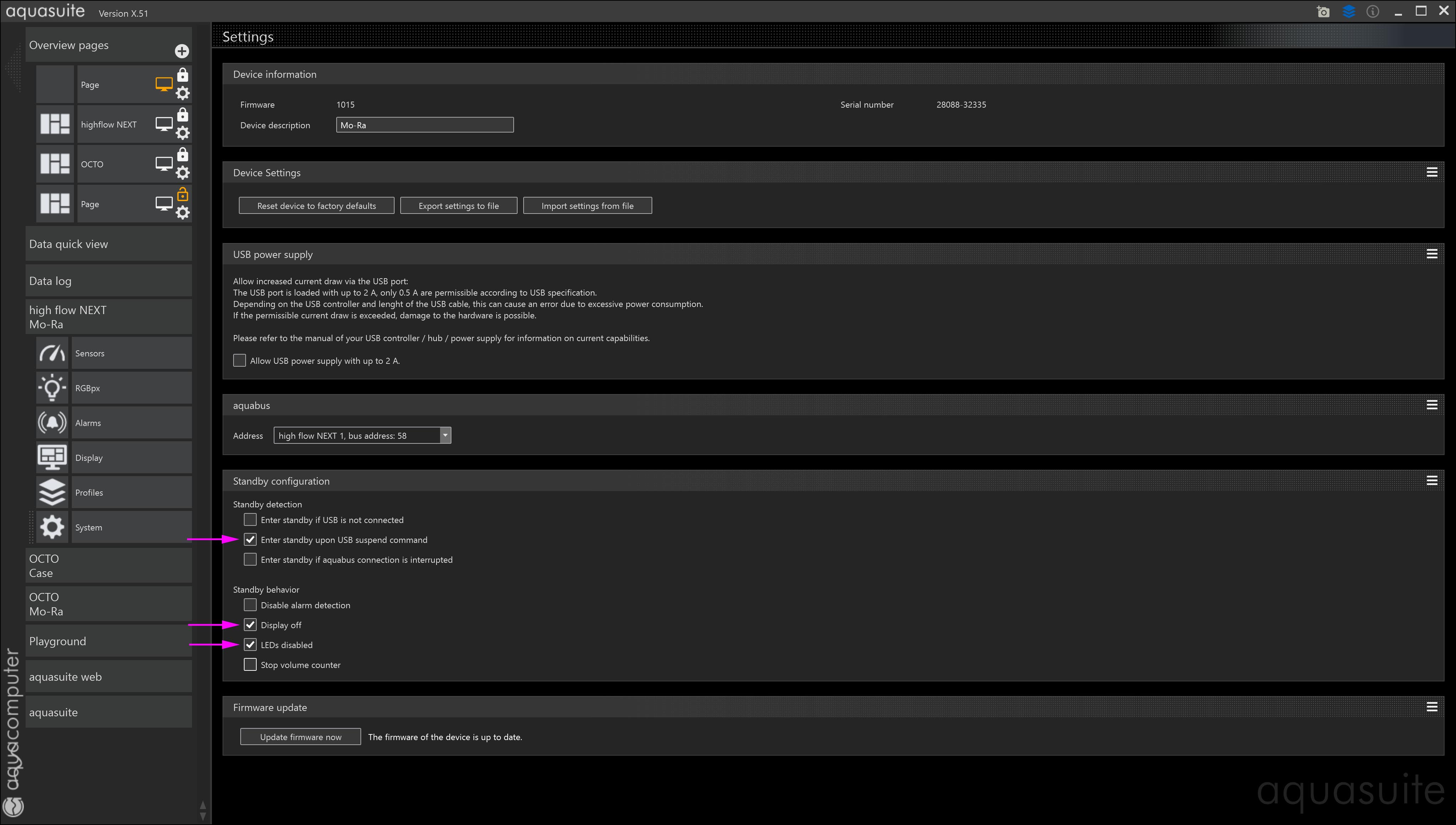

Assuming the "USB selective suspend" is enabled in Windows, go to Standby configuration in the high flow NEXT System tab:
  • under 'Standby detection' select 'Enter standby upon USB suspend command'
  • under 'Standby behavior' select both 'Display off' & 'LEDs disabled'
The flow NEXT should go dark when the system is shut down.
EDIT: I may have misunderstood the issue here. I pinged on the sentence in your first post "I want the LED and Display to be on-low when the machine is on, and when the machine is switched off, to turn off the the display.". I have X.51 and the flow NEXT is off with system off, and on with system running (when set as above).
InfoSeeker has attached the following file:
  • usb_suspend.jpg (564.12 kB - 199 times downloaded - Last download: Today, 1:38pm)
