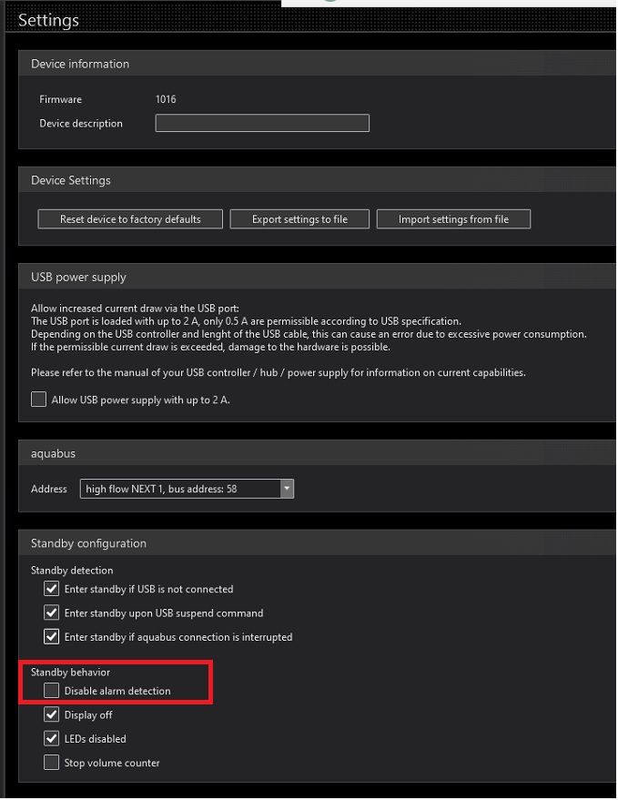

Hello,
although I have the auto shutdown Flag via USB, the FlowMeter does not turn off with the PC, activating the Alarm Signal below 30L / h ...
How can I fix the USB signal shutdown problem?

Hufeisen
Tuesday, April 12th 2022, 6:18pm
Maybe you need to select "disable alarm detection" in the Aquasuite software.
Hufeisen has attached the following file:
  • Alarm detection.jpg (119.02 kB - 82 times downloaded - Last download: Jul 30th 2026, 12:56pm)
