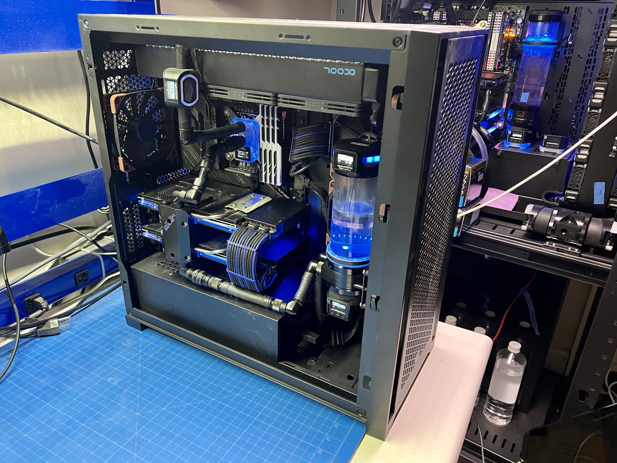

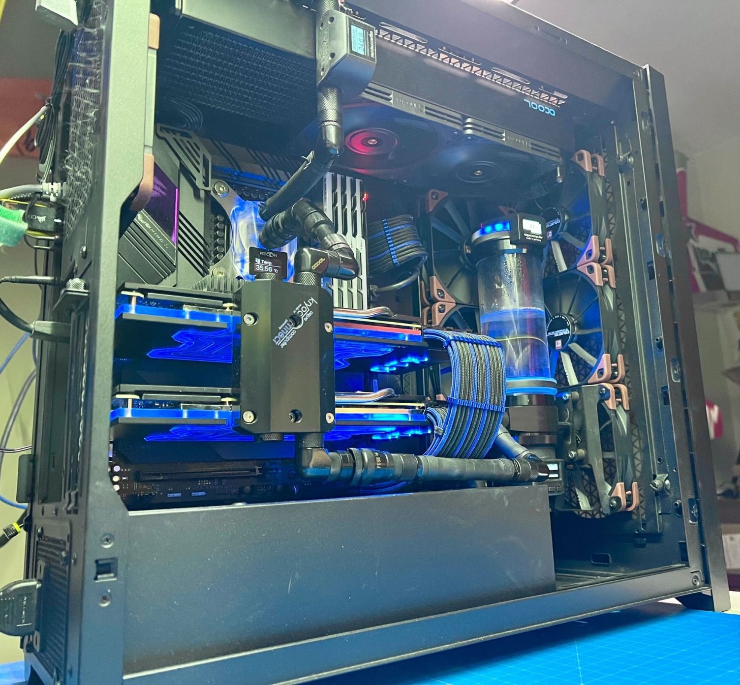

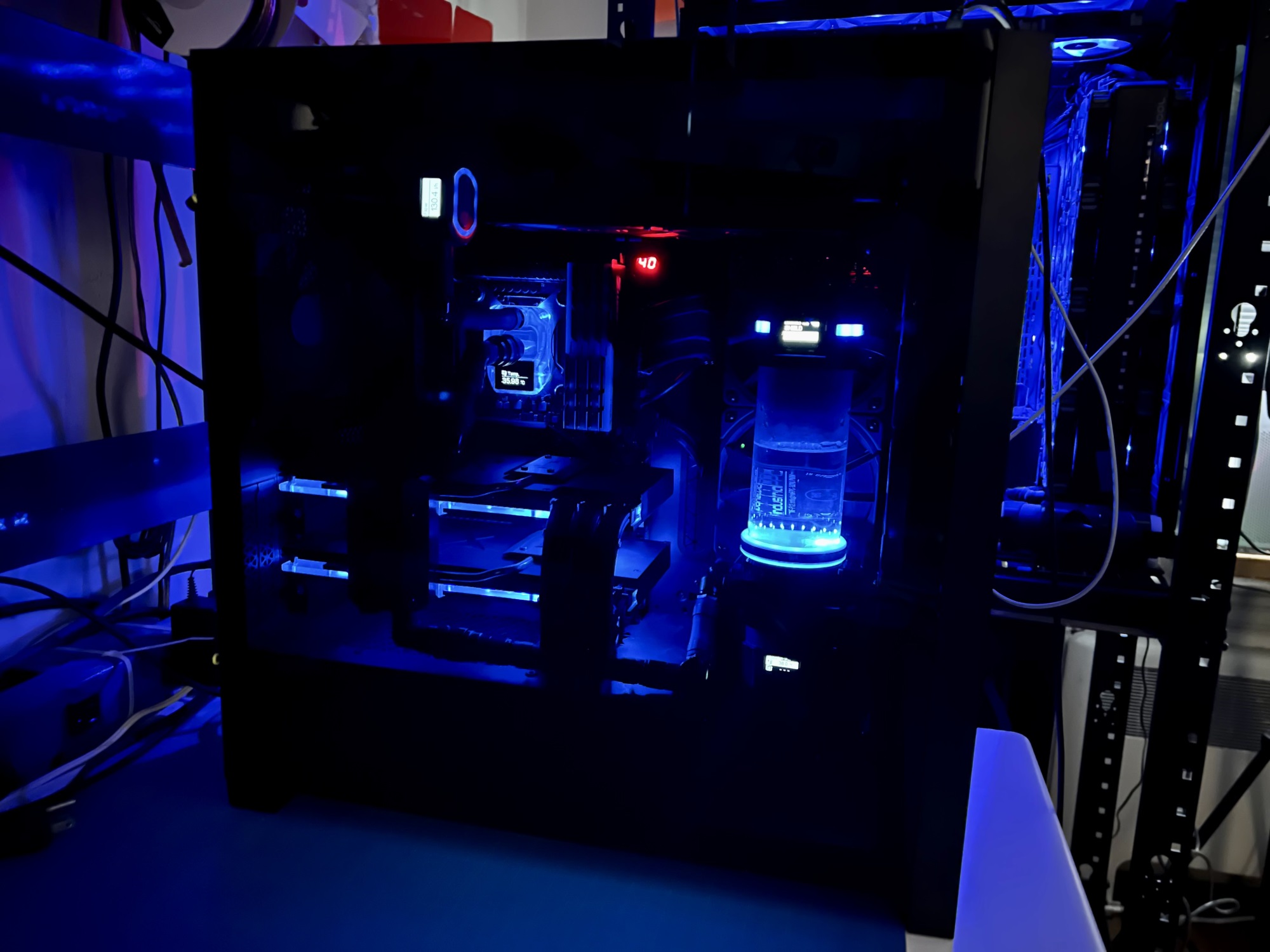

cptninc
Saturday, September 10th 2022, 4:36am
You can use the mount that connected the the reservoir to the front fans or radiator. This will leave the pump and attached controller to be rotated freely. That's how I mounted in this 5000D build.
Note that when mounted like this, the ports will be in fixed position and cannot be rotated to the front or back.
Sorry I have only angled pics handy at the moment.

cptninc
Saturday, September 10th 2022, 5:44am
The ports are perpendicular to the face of the fans (in parallel with the air flow). In this build, the pump is mounted to the front fans but the rad is technically on the side. My next one will try to have the pump mount to a front rad assuming there's enough GPU clearance.
The controller/display mounts to the circular pump, so it can be rotated to any angle you want. If 43deg is the perfect angle for your build, just loosen the pump collar, twist the pump, and retighten the collar.
