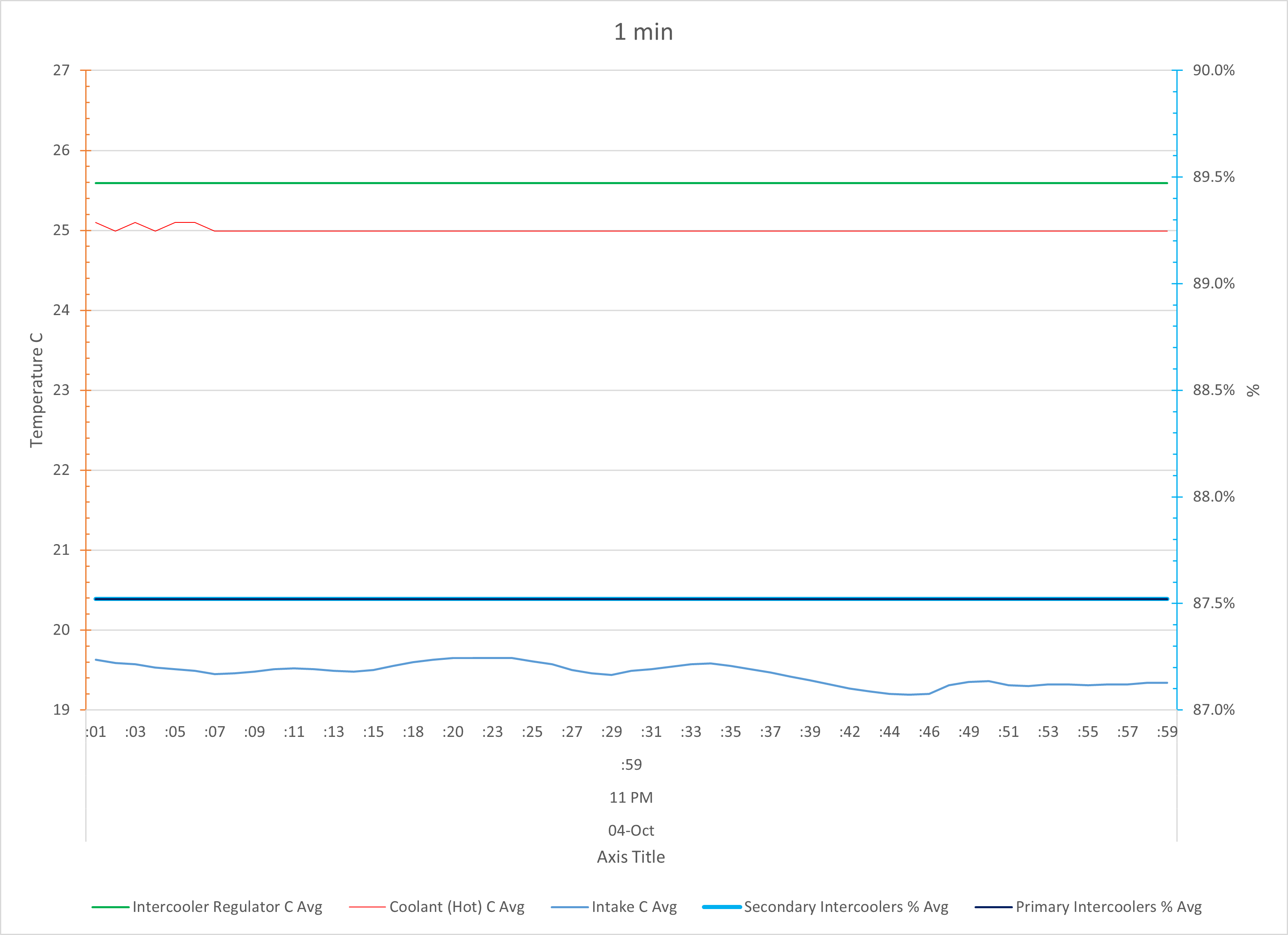

Your assessment is completely wrong. The jagged curve due to a zoomed in screenshot of a 1hr scaled log. It's not disturbance and it's not a lot of averaging.
The upper calculations are not based on the air temperature. They are based entirely on the HOT coolant temperature. You saw that when you tested it the first time.
The lower calculations are based on the ambient air temperature average. This is a new thing to add a feedback that for a boost to fan speed should the temperature rises above room average. This is really only useful for smaller loops in poorly conditioned rooms. It was a suggestion made earlier by another member.
I've been running it since I updated it. It's been incredibly smooth. Note: The Intercooler Regulator feeds a fan curve. The curve is set between 0C and 40C with a 15 upward arch. A second curve also uses it, but has a 2 upward arch to account for RPM difference between fan types.
Here's a 15 minute sample:
Here's from 6:30 PM to 9:15 PM: Note that the Intercooler Regulator (red) increases just before Coolant (Hot) [blue] registers an increase in temp. This was while playing a game, so the changes because of that. The intake temperature (green) is up and down because I have a window air conditioner in a room that needs new insulation. Controller output % is not depicted here, only the temperature reported by the Intercooler Regulator to feed the fan curves.
Here's the screenshot of the entire virtual sensor:
I made changes thanks to your earlier input that improved it, which I thank you for that assistance. I'm not forcing anyone to use it. I will post another log tomorrow showing the Intercooler Regulator, Hot Coolant temperature, Intake temperature, and Primary (Lian-Li fans 1,800 RPM max fan speed @ 100%) and Secondary (EK Vardar - 2,100 RPM max fan speed @ 100%) fan controller percentage (on separate curves due to RPM difference).

uhm.. the sensor doesn't increase fan speed before the water temp on the graph, it either does nothing (staying flat because it never decreased fans speed when it should have) or lags behind every single time as i experienced.
All i see is a water temp that barely changes, and a fan curve that jumps all over the place instead of being as flat as the temperatures. Of course, that's masked by the very slight fan response because in absolute the control temp varies by little, but same deal : on a smaller loop with larger temp variations, and larger fan speed changes, the sensor will be noisy and very unstable.

Why even bother posting a plot of the coolant temp and fan speeds if there isn't a matching plot showing the summed TDP of the components being cooled? It should be easy to get a flat coolant temp plot if the input load is similarly flat.
I now understand your confusion. You're looking at the Intercooler Regulator as directly related to fan speed. The Intercooler Regulator is in degrees C. This is mapped to a controller that uses the output to regulate the fan speed based on the set curve. The fans do change accordingly, but only in 10ths of a percent or more depending on the curve and heat bloom. I have added charts dumped into Excel that may help understand the plotting. This chart includes fan speed (in percentage), the hot temperature, room temperature, and the Intercooler Regulator Temperature.
Note that the increases were in 10ths of a percent, though jumps no more than 1% over time during this test. Depending on your fan curve, this could be negligible or it could be dramatic. That's tailorable. The regulator should be able to compensate if you set too low or high a curve.
Important note: My earlier recommendation to reduce the time on the Trend=X was incorrect and creates a problem. Increasing that time is best, providing earlier responsiveness when multiplied by 100. Decreasing the time on Trend=X works when removing the multiplier, but also causes more lag. Just finished testing that and confirmed it. What seems to happen is that it gets super sensitive at lower scales, making it inaccurate and delayed in this context. Increasing it makes changes very slight, but the multiplication brings out a quicker response to sudden change. Again, all confirmed, but would need more data to confirm in the field. This is what occurred which you noted in the earlier screenshot of the chart.
So to recap: Intercooler Regulator is an adjusted virtual temperature that maps to a controller, preferably curved but that's up to the user. It does relate to fans, but only changes the fan speed based upon your selected controller type and curve or set points. The changes in fan speed are slight on my system, but I did disable all fans but one rad's worth (the 60mm 360). I ran that test today but forgot to grab the data from it. It handled well, but again, this loop holds a bit more fluid, so I'd prefer to confirm function on a smaller loop.
While I'm looking at hot temperature in this, it doesn't depict the cold temperature. I don't want to set expectations on that, as milage may vary with smaller loops in comparison to mine. So you should compare function not only against how it manages fan speeds against the hot temperature, but also note if there's any changes to cold temperature as a result.
P.S. If you want specific information in another chart run, let me know and I'll produce it. :thumbup:

This is what outputs are supposed to look like. The labels are scattered but will make more sense if you read them in order.
Note that this is done with the simple PID controllers built into the Aquaero using nothing more than the default "Normal" preset. It does not require the unreliable Aquasuite service (sorry, someone had to say it) in order to operate.
Compared to mess presented by the OP, this method is:
  • Much more reliable
  • Much more robust
  • Much smoother
  • Much quieter
  • Much easier to tune and adjust
  • Much easier to implement
  • Does not require retuning every time a component is changed (not even if the entire PC is changed)

Preliminary -- Your note about the "lags behind" aspect when the water has began to drop in temperature is by design. There is a maximum in place that holds the highest temperature recorded during the past 5 minutes Once the temperature began to drop, 5 minutes later, it would follow. This was intentional in the event another heat increase occurred, so it wouldn't have to chase the curve again and keep the cooling longer.
You CAN lower that time. In fact, if you want to play with the settings, feel free to do so. If you want it to follow the curve more closely, I believe 5 seconds is the lowest Aquasuite will go. Alternatively, if you want it to chase the curve, bypass/remove the max hold completely. It's the gold one on the far right. I caution here because while it chases the water's cooling downward rapidly, the water will also take longer to cool. My recommendation is to set something shorter that you're comfortable with -- a minute was the lowest I've used in the past.
On the note regarding the difference between hot water temp and the intercooler regulator temp, again, this is by design. It saw the direction your heat bloom was taking and anticipated where it might land. If the reaction to the landing maximum was too long, lowering the max hold time in seconds is recommended. Try a 60s hold.
Regarding the "reset the sensor" -- I don't advise this under load. The sensor is intended to capture the low and high on heat to determine how much to bump the fans in response to the increase in temperature. This does not indicate what your COLD temperature is. Your cold temperature reaction is completely different following the radiators, I don't know as it's not included in these screenshots.
That said, I'm testing against your information and will respond back within a day or two. I intend to run it over a couple of days at a lower fan speed. For the record: My fans normally run 74%, not 80+, except when my system is under heavy load. Do note that the lower your fan curve, the higher the regulator will presume it needs to go to get the fans to cool the increased heat, but it will rebound lower. It may fluctuate more as a result also, which is something that I need to investigate further given the revamp. The earlier version did not have that reaction, but perhaps the revamped version does. Again: Try setting the MAX HOLD to < 5 minutes. If you want to chase the temperature drop curve, that's your call.
Addendum: Fan noise -- I don't use the 0RPM feature of the Vardars. The Lian-Li max at 1800 and the EKs at 2200. The Lian-Li curve is lowered to match the EKs when they're at 1800~ish (the Lian-Li's maximum). Where they intersect can hold the Lian-Lis much higher, but typically, they sit around 840~ish, which the EKs also sit about 860ish.
One important thing I noticed about your loop was your pump speed. It's pushing .55 GPM, which is quite low and indicates your loop is as restrictive as mine. I did have to add a second DDC pump to get above 1 GPM. You'll note that Martin's Liquid Lab contains a lot of information about why you should be closer to 1 GPM and reviews several tops: http://martinsliquidlab.petrastech.com/D…TopTesting.html. If you're using a D5, that still low and your thin rads are likely causing it more than the GPU's waterblock. I understand you're sensitive to noise, so I recommend that if you do consider adding a second DDC to look at the HeatKiller IV multi-pump top. This is assuming your reservoir is decoupled from your pump. If not, then there's a HeatKiller IV of the same type that runs very quiet when combined with the EK DDC pump bottom (chrome or acetate). The rubber feet work well, but if you have space that doesn't impact airflow then the shoggy pad would be best to reduce vibration noise further.
Well.. setting up the cooling exactly as you do is quite the adventure.
Your fan curve ensures the fans run between 80 and 100% speed all the time. Indeed it cools well but who likes sitting next to a turbine?
Setting the curve to 0 arch makes it quieter but it's still a good 64% speed at idle which is too much. that's what i have at full load usually.
at + 13 i have something decent, but that only makes the fan acceleration noisier since they reach over 2000 RPM in a matter of seconds. And when stopping the load, the sensor holds that racket for minutes... off we go to reset the sensor..
I've made a curve that would make sense if i wasn't using dT, just based off water temp. the coolant never goes below 20°C, and as you i keep 40°C as full speed.
No arch, straight curve, otherwise it's too noisy at idle, and already, the fans run too fast at 50% PWM.
That's a bonus for you, i already push the cooling from the start.
25% at 20°C, 100% at 40°C, no arch.
Starting a game, the fans take off quickly because, despite the water being at 28, the sensor goes to 36 - 37 on the fan curve. Since the radiators aren't even that warm, it only causes noise and has no cooling benefit yet.
Now in less than 3 minutes, my fans are at 94% PWM because the sensor drives them as if the water was 38.3°C.
The water temp keeps climbing obviously since the 3090 is pushing over 350W but i'm being blasted by 2400 rpm fans while just following the water temp (no virdual sensor) they would be gently climbing around 65 - 70%.
What should i do ? make an arched curve? that would be even steeper accelerations and more nuisances. Raise the max temperature? I shouldn't have to if i want to limit the water temp to 40°C, but your sensor just uses "imaginary" temps, so i can't set a curve based off real temps. Right now the water stabilizes around 31, but the sensor keeps 38.
While i was typing that, the speeds dropped 10% because the sensor finally left its plateau.
But guess what? dropping that fast, the RTX does what it does best, the water temp goes back upand the fan speeds too.
Now the water is at 31.5, and the sensor at 33 which is closer to reality.
Usually under full load, my fans run close to 1700 rpm, right now they are just under 2000. i won't lose hours trying to get a similar result, it's close enough.
Waiting for the water to cool down, again, the sensor lags behind and keeps the PC noisy. the water is back to the temp i started (around 24) at but the fans are still at 70% because the sensors holds a 32°C temp.
And again, as i write that, the sensor drops and the fans slow down fast, and i have to stop the test there because the PC is chilling me, blowing air so hard on my side..
The point stands :
Your fan curve, that i completely missed from the first post, is what makes you believe you sensor is useable.
If you are at 90% PWM at idle, of course the sensor will work. those big swings will be so small you won't even notice them, but nobody does a curve like that. it's just too noisy, it clogs dust filters too fast and it defeats the purpose of having a fan controller. you could set a fixed 80 or 90% and be done.
With such a fan curve you can't assess at all how your sensor works. You are basing your own conclusions off a test that is basically rigged to succeed everytime, since no fan control is needed once your base speed is so fast..
You could make the most ridiculous sensor using every single module available in the playground and still have good temps.
You are using Vardars, they have a 0RPM feature, so, let's disregard it and try using your controller, varying your fan speed between 26% at whatever your water idle temp is, and 100% at 40°C. See what it does.
Now when you use delta T (which i remind you is a one operation virtual sensor) you get something like this :
the fan speed increases gradually, you barely notice it, and it follows the radiator efficiency which, again, is directly red as the water over ambient temperature difference.
This alone dictates how efficient your radiators are at dissipating heat. Blasting the fans while that delta is low only makes noise and has NO cooling benefit, none, at all.
This is why using imaginary calculated temperatures makes absolutely no sense. you disregard the one value that governs radiator efficiency and provides the best base for fan control.
Now if you want to manipulate that value to have a different fan curve between 8 AM and 10 PM, have fun but i'll maintain that the fan curve you used is too extreme to warrant the use of any control variable, and the virtual sensor is way too unstable and extremely inefficient at cooling if you use any fan curve that doesn't pierce your ears constantly at idle.

For my pump it's fine thanks. the flow makes no difference in waterblock temperatures as long as it's above 80L/h (0.35 gpm). I'm running it too fast already and don't need to regulate the speed. Read again their test setup when they did the radiator tests, you'll understand why those values are not useful when talking about a real build VS a test setup.
Edit : nevermind i thought you talked about the radiator test VS flow rate. That article you linked is relevant to nothing in terms of cooling. they just compare pump tops.
Your fans on your screen caps were running at 90% PWM. that's not 850 rpm on a vardar. i used X3Ms for a year, thank you. your fan curve itself sits close to 90% at room temperature.
I know about static pressure fans too. the distinction between static pressure and airflow optimized has been around for a number of years you know?
My fans max out at 2600 RPM. They are quiet at 1500.
The problem with your sensor, no matter how hard you try to justify it is that it disregards radiator efficiency completely. Forget noise level. why does it make the fans skyrocket when the radiators can't dissipate heat? to achieve what?
when the water has cooled, why does it keep the fans running hard? to achieve what ?
Why does it use calculated estimations to regualte fan speed instead of what the PC is actually experiencing? what's the goal?
Do you understand the principle of radiator efficiency with air and water temperatures? you keep brushing over that but it's in the core of why your sensor is dysfunctional.
And on the last image i said it was a delta T sensor, that's why it worked as intended. That's my usual fan curve.
I left your sensor on the side but it wasn't controlling the fans. Yours is on the first image, 1800 RPM at 31°C. 2300 RPM was the second test.
